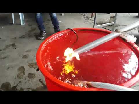

Firing up the oven tomorrow, the red bucket wil serve as smoke blokker, the last pipe will flush the remaining smoke with a circulating pump, injecting the smoke and water under the surface…

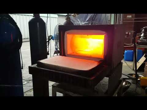

was fun testing today…
The 2 thermocouples gave a nice reading, difference between the oven and the inner tank temperature.
@ 700ºC i switched of the electric, started the oxy untill 1000ºC and then switched to CO2 in the cooldown.
The pictures around 800ºC when i opened the oven for taking a glimpse… see the heat move from hot left to colder right…
The red plastic tank is getting the final smoke… the tube having running water pumped around from the tank to the top of the tube…
