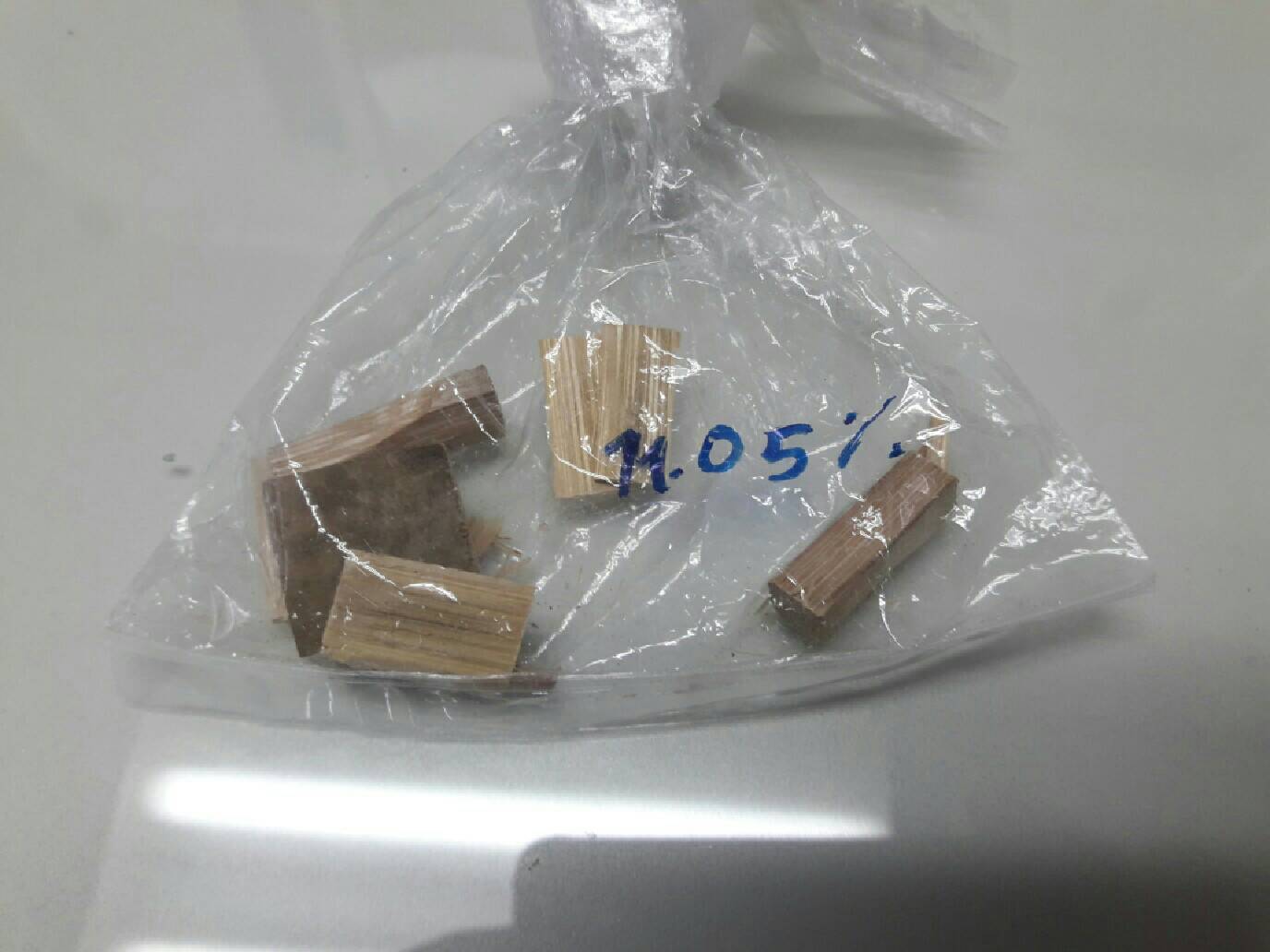

Also have here the Lab test moister content
11,05 %
Surprisingly low…

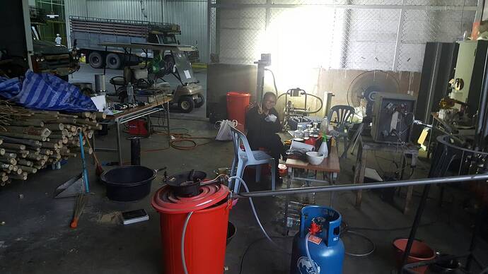

Ok, back at home… been doing tests with more then 1 liquid…
Oh yeah, the ants did not like it, tooked their eggs and ran for their lives… the sprayed zone is “ant free” now…
and the whisky was delicious…

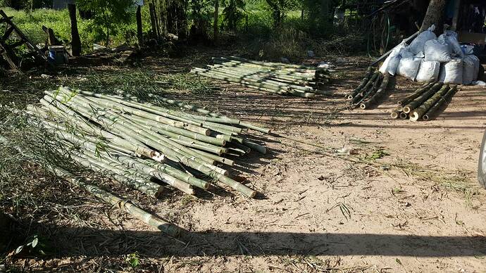

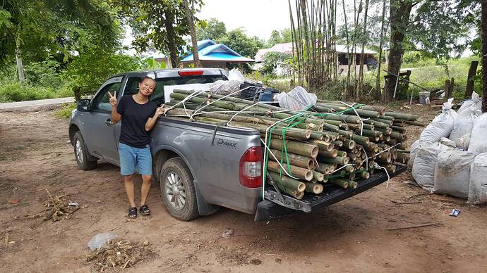

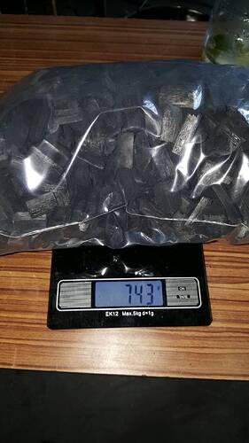

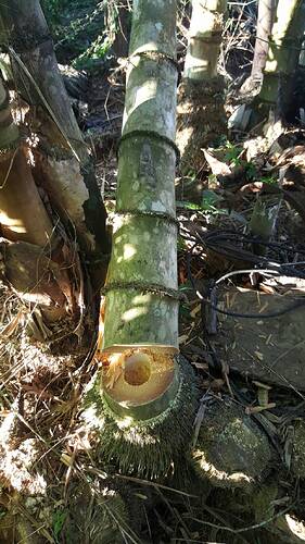

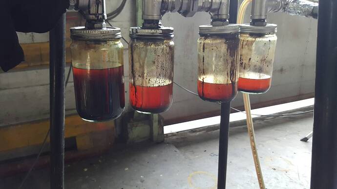

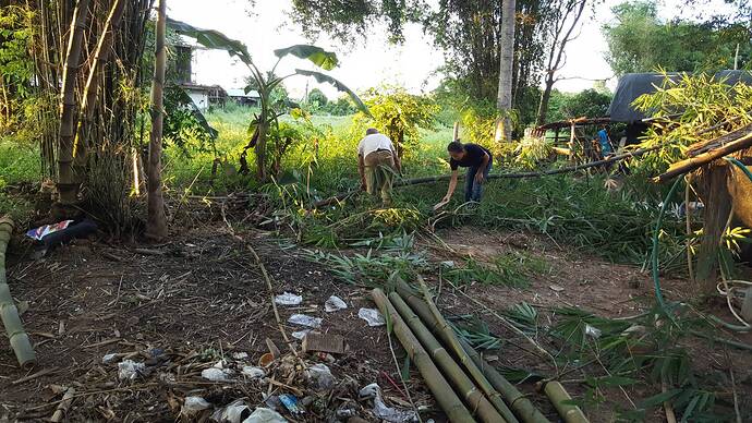

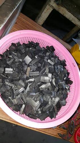

Been doing some harvesting to get more vinegar and charcoal… fuel…
Today’s batch of liquid … fuel / whisky / pesticide ?
Planning a test to mix it with diesel…

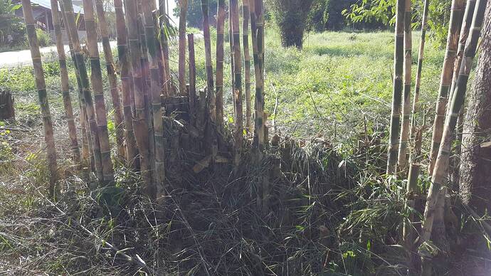

That sure looks like wonderful fuel. Your a lucky man to have a fast growing resource like that. :relaxed:

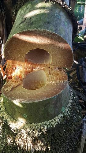

Those bamboo looked like 6 inches in diameter
How old were they?
Thanks for the info Koen , i guess i will have to look at distilling some wood vinegar anti ant juice myself when i get a chance. Is there a specific distillation temp that worked on the ants or can i condense my wood smoke and use that regardless as long as it comes out as liquid ?
Hi Michael,
This bamboo was 6 years old. The clump is about 9 years.

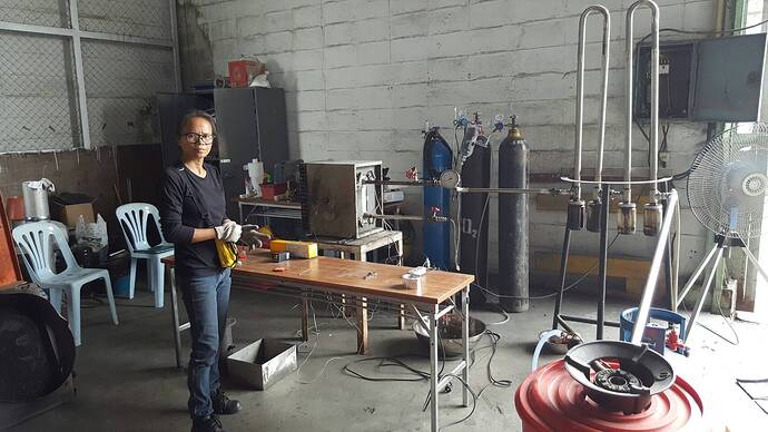

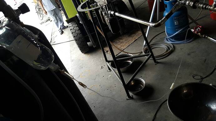

My fast lane is indeed separating the vinegar with the set i did build, but i am putting the outcome to a test now, leaving the product settle for 90 day’s and check what it becomes…

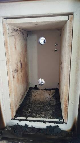

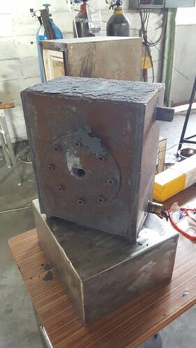

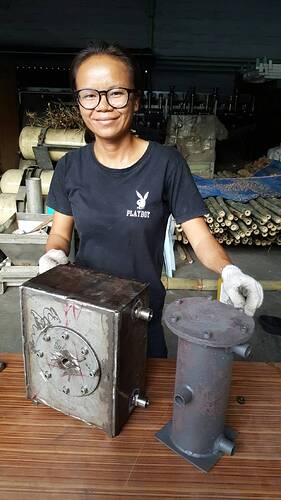

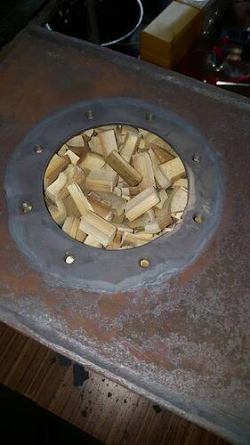

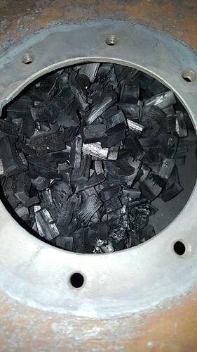

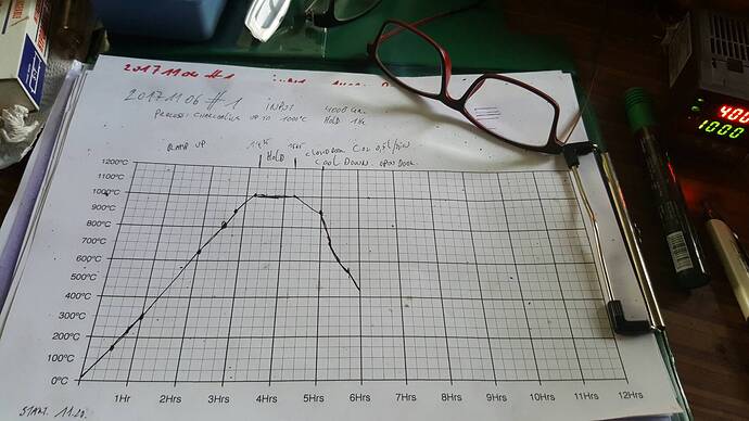

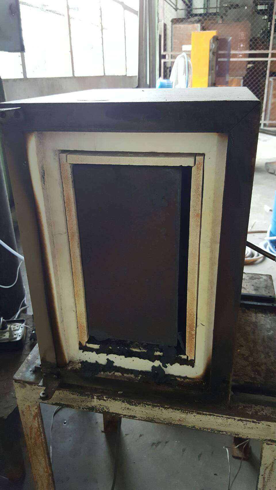

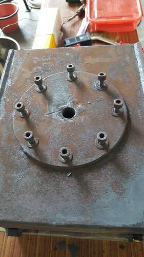

I redesigned the original box, now with a bolted lid and in/outlet + thermocouple. Going to tilt the oven on its side for a smoother activation process…
The box on the leftcan hold 5 Kg, the cylinder tube only 1 Kg
Koen, You just gotta love a “hands on” lady!
testing is fun, especially if the outcome is within expectations…
The output is consistent
The process easy to manage

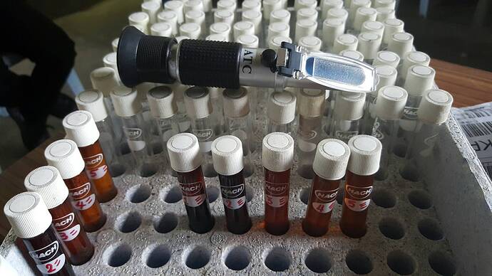

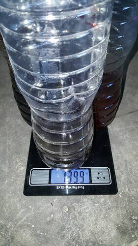

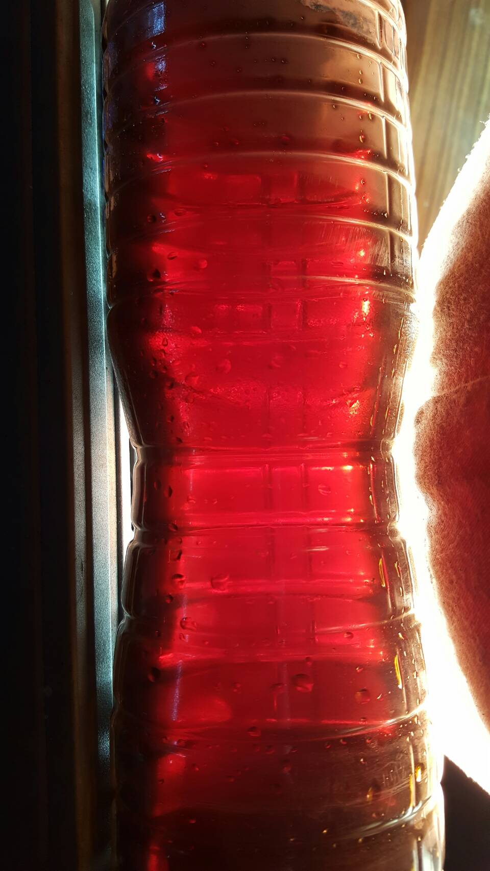

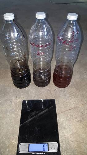

The Vinegar , i tested the 5 different outlets, there is a significant difference with the refractometer, the last 3 bottles are in the range 1,10 to 1,13 density, the 2 first bottles have 1,25 to 1,3

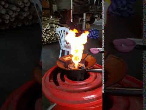

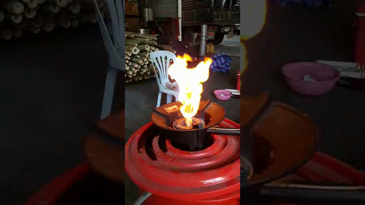

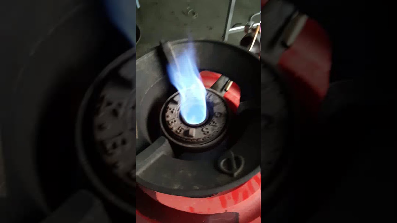

Uploading a video clip now to show the gas outlet after the condenser and the gasoutlet when i am activating with Co2
The gas / smoke video:
and the Co2 with glowing Charcoal
( Co2 to syngas converter :grin: )
by the way, the gas is pure and powerful, no dilution with nitrogen

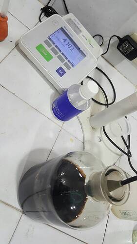

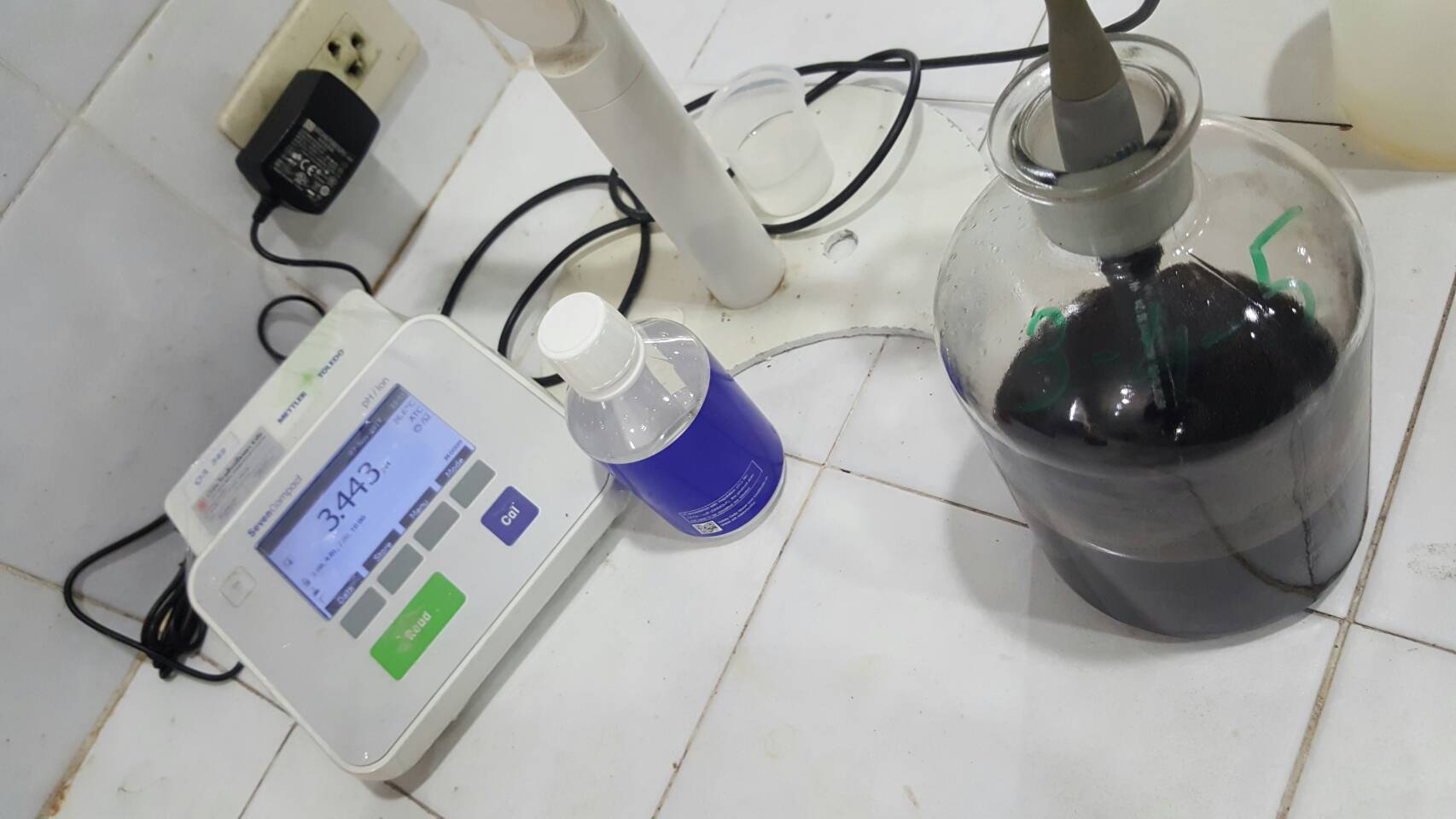

Ph test in the lab today…
The more dense liquid has a slight higher Ph value
The mix from the 3 last fractions, less dense, has a lower Ph
Good info Koen. This is Bamboo only, right?
The reason I ask is, do other woods have a different value? Are there trees that may be closer to a neutral level? We have Carl on this side of the pond replacing a lot of metal on his system compared to others. Just providing possible future tests. :slight_smile:
Every plant matter pirolise condensate shuld be acetic becouse of acetic acid content. Howewer, oak wood contains other chemicals that eat steel. Not sure why, my guess is maybee tannic acid.
Another factor would be the amount of moisture in the feedstock. Wetter = more dilution
I believe bamboo is fairly dry
