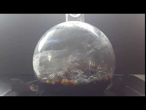

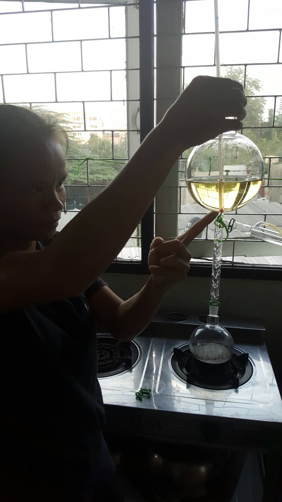

Testing fractional distillation in the kitchen…
Be careful…

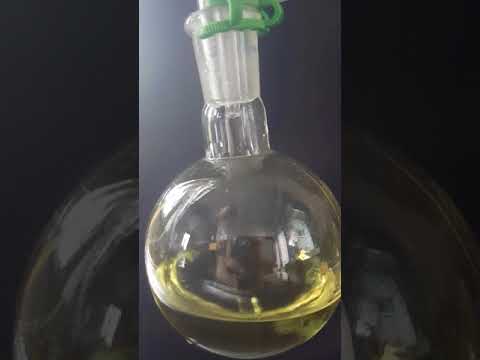

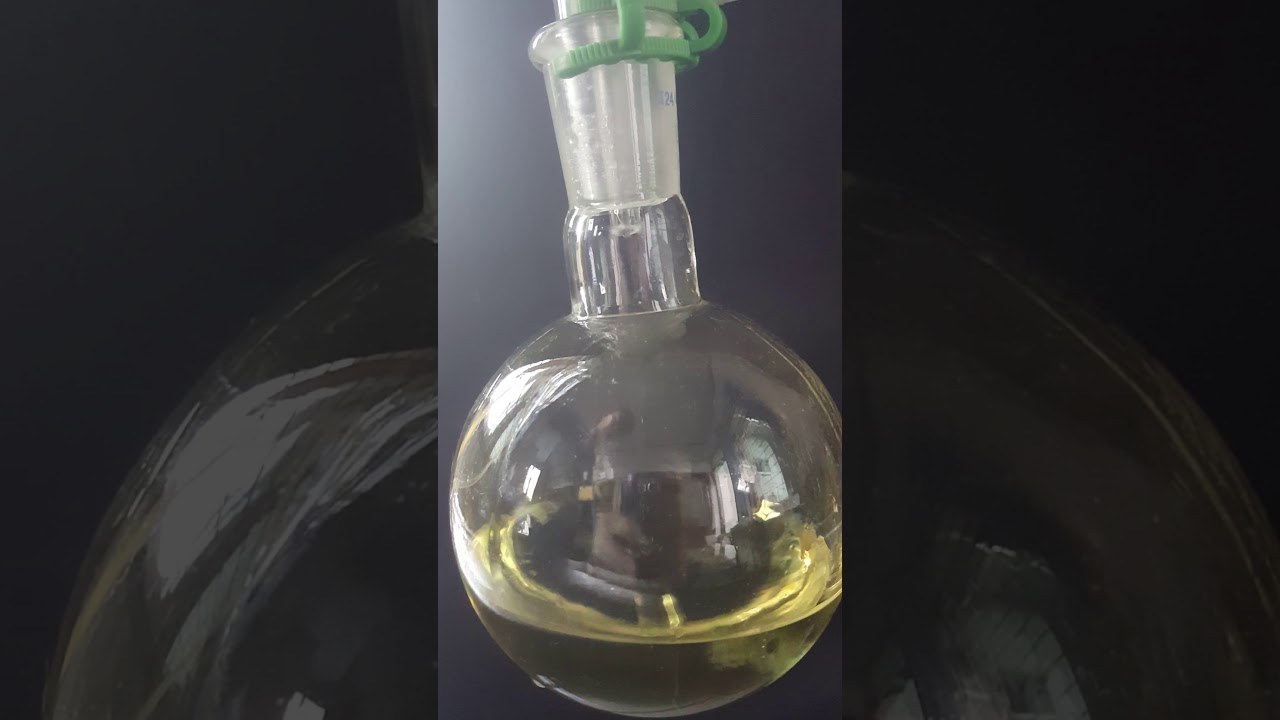

1 part to mix with regular diesel, other part to mix with heavy fuel…
Preparing samples to sent to labo

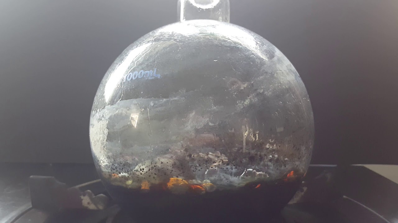

Be careful…

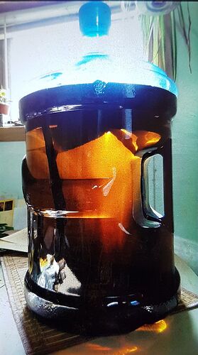

Looks good! So is this methanol or some other fractiom?
Have you got a idea of yeld of flamable liquid fuel/kg wood?
Hi Kristijan,
This is a first “field” distillation, testing the possible separation of Tar components and other liquids.
The acidity increased from 4 to 3, so that is a change but i am studying the different boiling points in order to extract other components.
This first distillation was at 118ºC ( vinegar / acetic acid )
Methanol has 64.7 °C
Ethanol has more or less 78,2 °C
I am graduell working towards the lowest temperatures , hoping not to lose to much vapors
