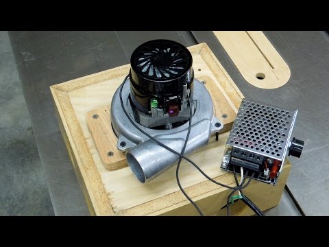

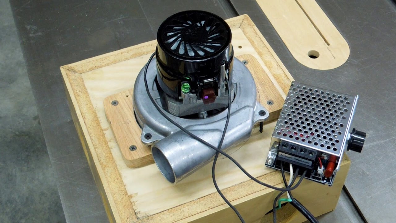

I think this thing might work. the blower housing is isolated from the motor. Judging by the sound of that thing, I could potentially boost and engine with it.
I looked it up:
93 cfm and 47" wc, blanked off.
500 hours service life and about $100 each retail.
5.7 amps max at 120 VAC.
I am surprised that he needs a 10,000 watt controller. Lets see---- 10,000/120 = 83 amps! I looked up the controller. Probably the most over rated product I have seen lately.
Pete Stanaitis
Yeah thats what I was thinking. I was thinking of just getting a Harbor Freight router speed controller and a 800 watt DC//AC converter.
I found this one on Amazon for a little over 70 bucks and free shipping.
