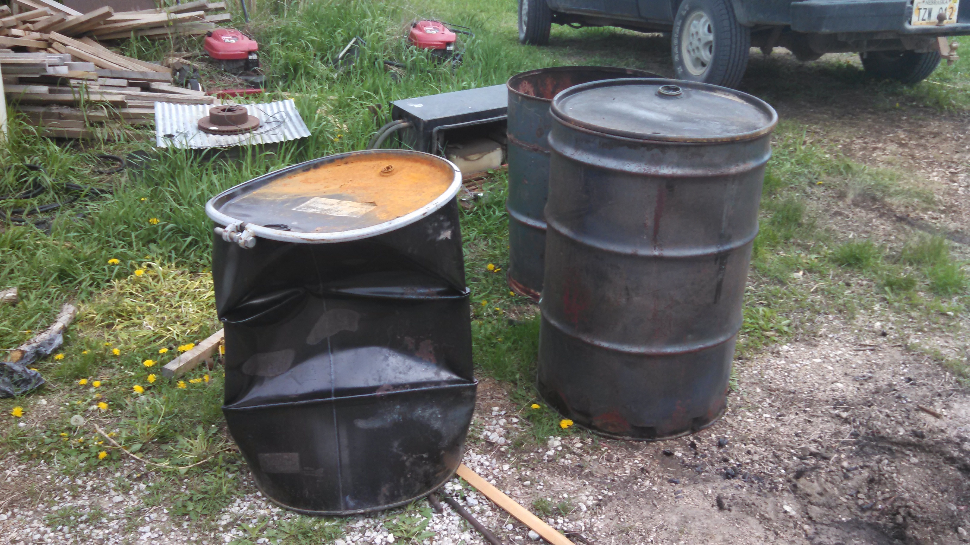

Yes the same thing happened to me when I first started saving my charcoal up in sealed containers , the red hot coals created a vacuum in my drum and squished it ,just the same as Toms drum , now days I let my coals go cold in a not so air tight container first before storing up .
Darn it.I wanted to be first at something here even if it was screwing up.
Hot coals plus good seal equals crushed can
How many hot coals did you put in there Tom. I have been wanting to make a couple large batches to have some on hand for play time. I think maybe I’ll take a little time today. I have some construction demo wood to get it going I need to get cleaned up anyway.
About a third full. Little below the first ring. I made 3 batches before using same method but that lid had the gasket removed. Also used smaller wood chunks this time
