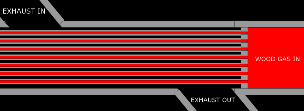

Thermal tar cracking with exhaust heat exchanger?
wouldn’t a heat exchanger after the exhaust manifold be able to crack the tar from wood gas?
It would of course it would not work when the engine is cold.

Jim,
Please listen to Matt R. He knows what he is talking about. Your heat exchanger is neither hot enough, nor does it have the white-hot carbon to complete the chemical reaction. You could use a similar design to pre-heat your primary input air. :thinking:
Jims idea is not dumb thugh. I was thinking about something similar a while back. Pirolisis gas is way richer thain woodgas.
Jim, we speak of tar cracking but that is not a actual correct term. What we mainly do is oxidise tars in a gasifier to CO2 and H20 then reduce those to CO and H2. Cant achive this with heat alone, at least not with the temps possible wifh exhaust.
Bottom line, hard to do if not impossible. Matt is right.
