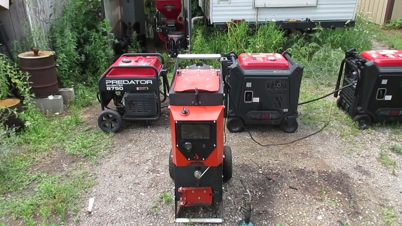

Ok going to post this video here, running the inverter generators in tandem. This here Im running the 9500 with the 8750 inverter generators. Note that the 8750 is NOT parallel capable; however the 9500 is and it can sync to the 8750. But the 8750 can not sync to the 9500. So the 8750 must be the master and started first and then you start the 9500 and it will automatically sync to it.
Any inverter generator that is parallel capable does NOT need any special cables none of them. All you need to do is build a Y cable and join them. The cable ports on these are hard wired directly into the output legs, the only reason they make them that way is for safety reason’s. IE you unplug one generator while the other is running; you will have a live plug with prongs.
Also is the 2023 DFX-S3 final revision. Moving on to the VersiFire and next generation controls. I will soon be posting a lot about the Versifire especially if it works!! Im expecting this to be a massive product for this company way beyond what we sell in gasifier systems.
