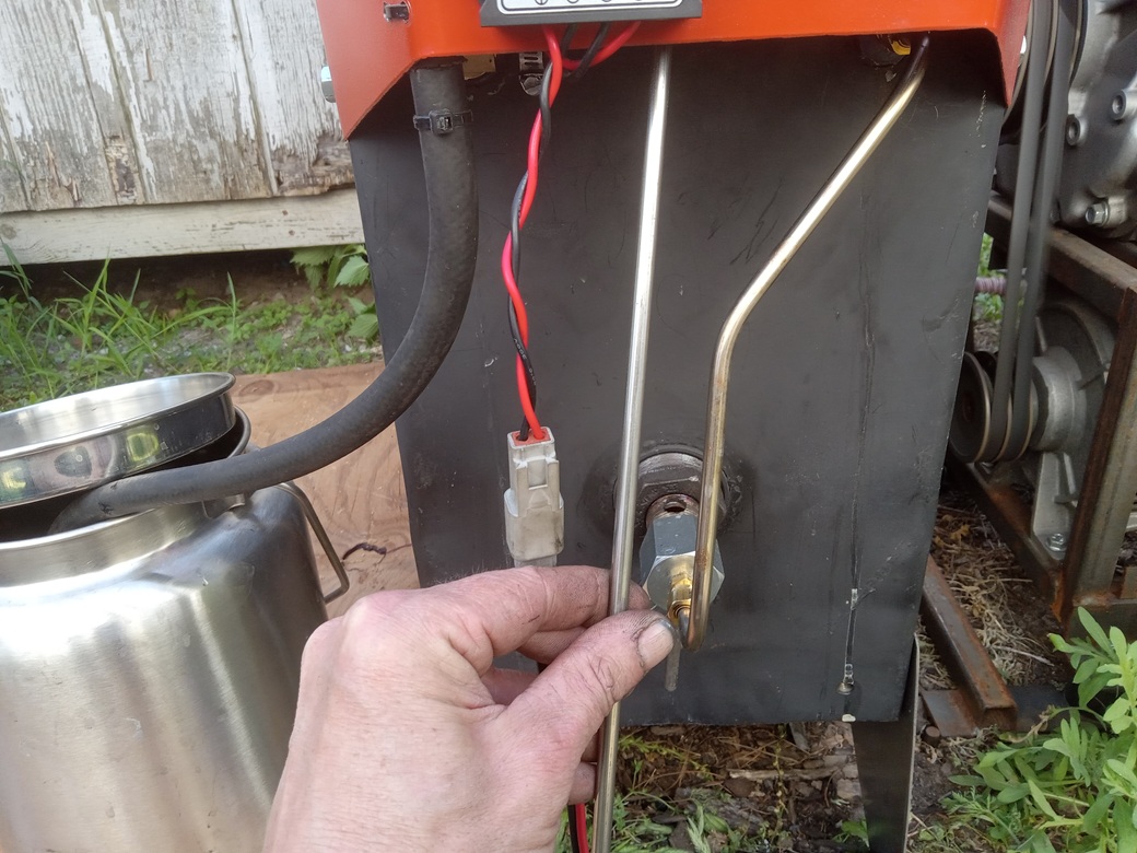

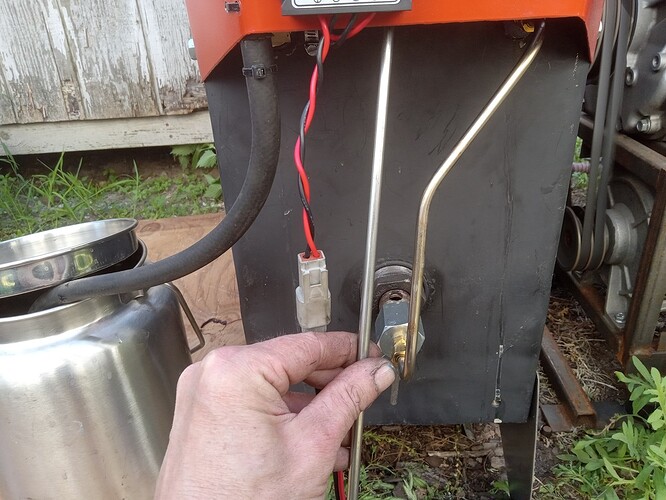

Ok so this is last years model with this new water / steam loop update. However this version dont have the ceramic insulation. But it is a larger size so its should have more natural insulation but I sure its not as good as the 2 inch Ceramic Cloth Im using.
Ok so this is workiing as expected except it did not resolve the pump presure switch instability. Oh well there is a fix I found last year, using a solid state adjustable on/'off relay. This allows you to pulse the pump with a higher adjustment on the control valve. So Ill add this control and integrate it into the pump housing where the water tank used to be. I sort of expected this but not like how its actually working. So I ordered one of those relays and for now; Im using a mechanical relay. When its working it does allow a bit more water in. The relay is now the issue as it hangs once in a while but its still fairly stable. So what its doing is once you get the flow really stable it puculates and the steam atmozises this water sort like a fast pulse!. Its pretty cool as long as its glowing in the nozzle; the flow is good.

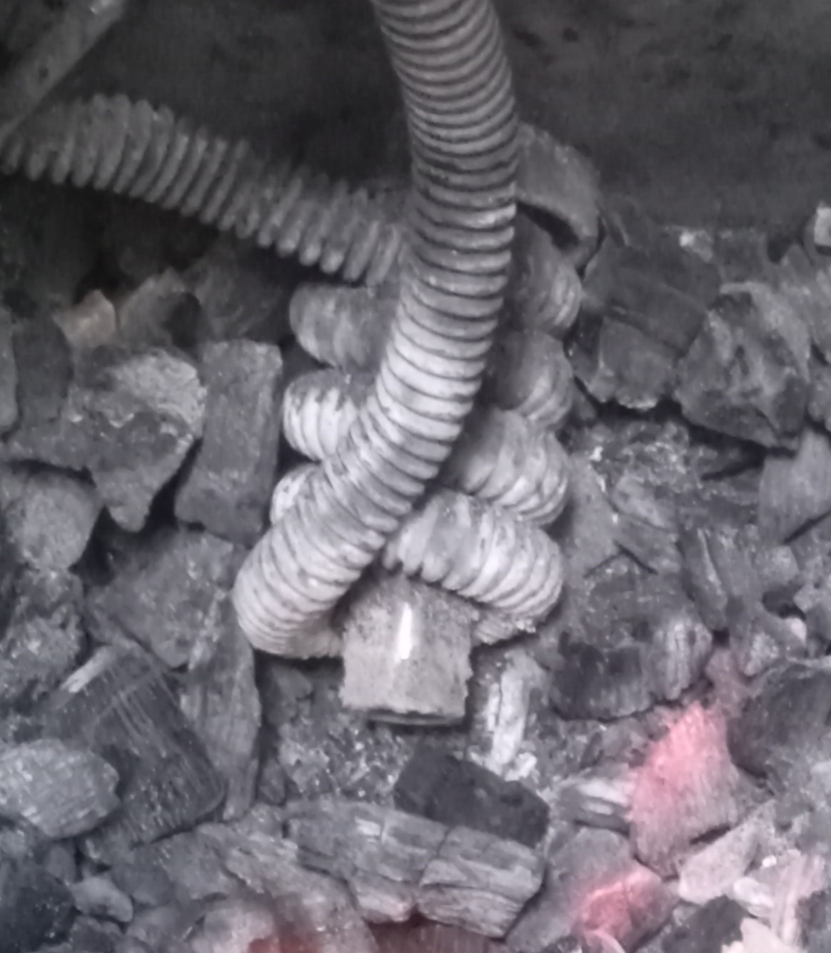

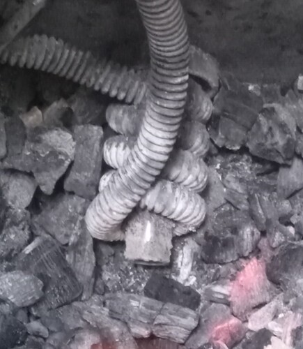

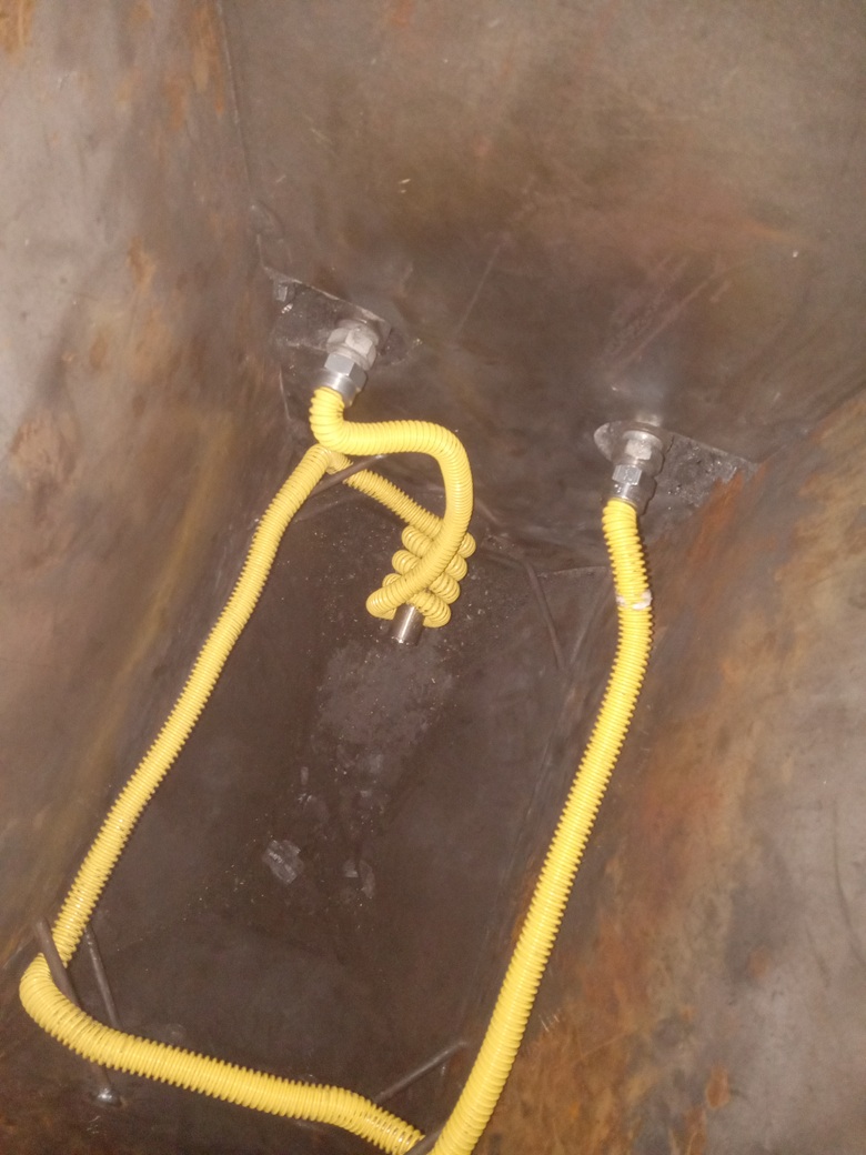

Ok I just ran the CXF Si for the first time. The steam injector there is atomized water coming out with the steam. what Im wonding is if this water is flashing to steam once its out of the nozzle and presure change, plus the heat from the oxidation of the charcoal at the end of the nozzle?

Yes, the atomized water is almost certainly flashing to steam due to the combination of the pressure drop and the intense heat from the charcoal bed.
The physics behind this process, known as flash-boiling atomization, works through two main mechanisms:
  1. The Pressure Drop (Adiabatic Flashing)
When the pressurized water/steam mixture exits the injector nozzle into the lower-pressure environment of the CXF Si, it undergoes a rapid drop in pressure.
  • Energy Excess: Under pressure, water can exist as a liquid at temperatures well above
[image]
[image]
). When the pressure drops, that liquid suddenly contains more energy (sensible heat) than it can hold as a liquid at the lower pressure.
  • Phase Change: To shed this excess energy, a portion of the water immediately “flashes” into steam. This expansion happens internally within the droplets, often causing them to shatter into even finer particles, which further accelerates evaporation.
  1. Heat from the Charcoal Bed (Oxidation Zone)
The charcoal bed acts as a massive thermal heat sink and an active reaction zone.
  • Radiant and Convective Heat: The “oxidation of the charcoal” at the end of the nozzle creates a localized high-temperature zone. This provides the latent heat of vaporization required to turn the remaining atomized liquid droplets into gas almost instantly.
  • Steam Reforming Potential: In systems like the CXF Si, this steam isn’t just a byproduct; at these high temperatures, the steam can react with the hot carbon (charcoal) in a thermochemical process to produce syngas (

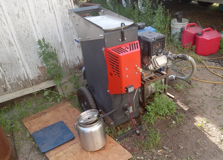

So far this has ran for 3 hours and 10 minutes and it stalled. Usually I shake it so fuel from the back moves to the front. I cant do that with how its up by the shed. So I had to open the hopper and just move it. So I know its not spent and this is typically the end of a full hopper before. Average run time I think was 2.5 hours and I never hit 3 until I started pushing the steam more. If it goes to 4 hours thats a pretty significant change.
Edit: it ran four hours and I think it consumed around 5 to 6 liters. If its spent it likely around 14 lbs of fuel, pretty typical. So that was a 5.4 kW net per hopper about 2.5 lbs per KW.
Ok after more testing Ive found the 2025 updated version likes 2 liters per hopper load. That would be if it were set it and forget it. However I can get more if I let it warm up but this machine cant sustain higher steam output and I figured as much. Its why the new one is designed the way it is.

Ok so what Im expecting. This unit will have slightly less " usable capacity " However I think it will still have comparable run time on the same amount of fuel. Its 4 inches narrower but it has 6 inch more depth. Becuase the walls are tighter like I found on the earlier 10 inch machines they consume more of the available fuel. Where the larger ones they just create a cone in the center. So if it runs the same amount of time of un interupted run time. It doesnt matter if it holds more fuel. You still have to open the hopper. So just put more fuel in it versus adjusting un used fuel. Id rather put more fuel in than dig inside a hot hopper anyways. The water evap loop Im expecting it to work much better. The loop is tighter and closer to the hot zones; simply because the of size, It should run a bit hotter simply because its smaller and then I had enough length of the SS line to wrap a coil around the nozzle and that is at the end of the evap loop before the stream exits. This area at the nozle shiould be the hottest zone. Then the added insulation so it should retain a lot more heat than the old ones. So hopefully Ill hit the 1ltr to 1 kg or get close. I at least hope to exceed 500 ml to 1 kg.
Just to make sure I’m up to speed, you’re pumping a regulated amount of water into the water line, or is that stainless can just an extra supply of water to top off a gravity tank?
Im using an RV pump with a flow control valve and a solid state relay to pulse the pump. This way I can open the valve more so the pump never triggers the built in presure switch causing it to stall. So now I use the relay control to create a foundation for the flow and then can use the vavle in a more open state to fine tune it. I have it set to flow 1 ltr an hour but I think its still fluctuating a bit. I can see where a controller might make this even more efficient to precisely flow the exact flow the gasifier can handle based on its reactor temp.
