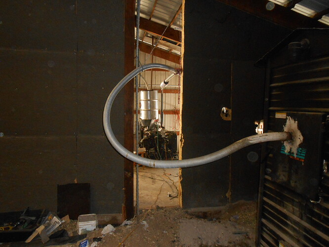

Matt told me to direct exhaust to boiler . I am running engine on propane .

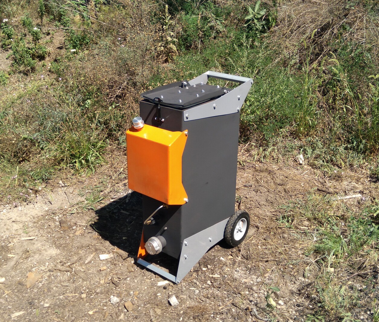

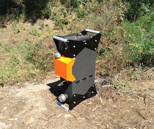

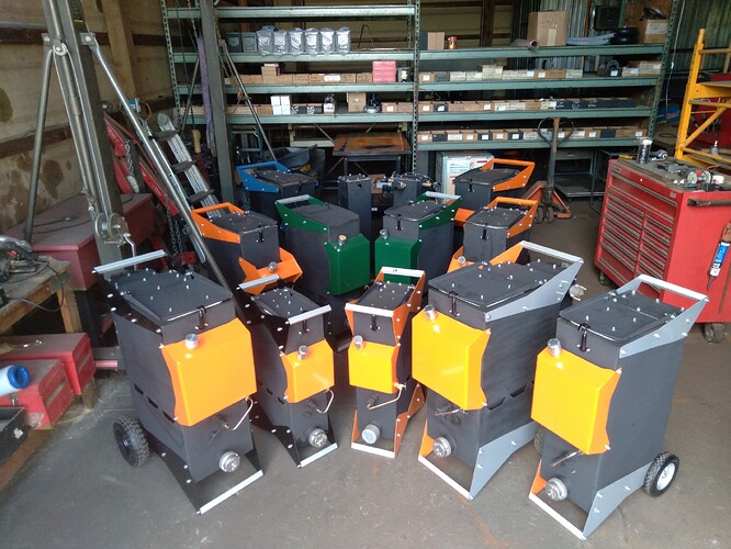

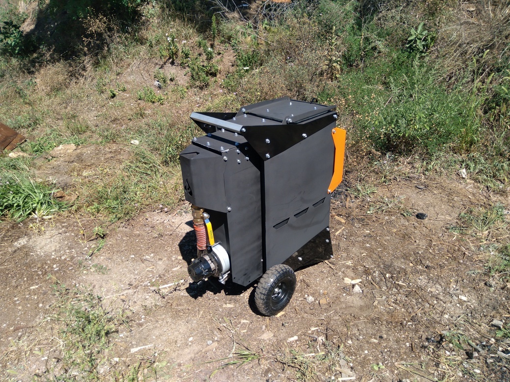

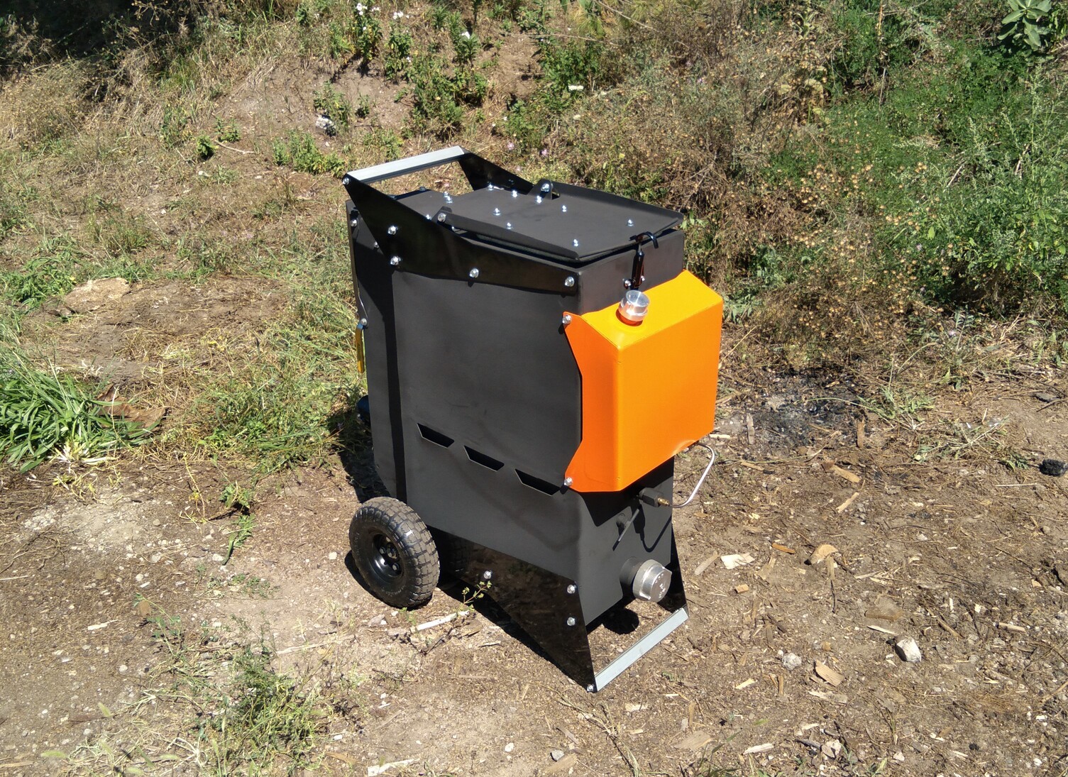

Shipping out the Spring / Summer builds this week. Ill be updating the site for the 2022 model year this weekend and start planning for fall production. Here are the (M-1 thru M-3) 2022 models. Things are cranking back up!! Paint supply issues forced some creativity that will now be standard offering :fire:
2022 M-1 SE Gasifier
2022 M-2 Mule Gasifier
2022 M-3 Utility RTR

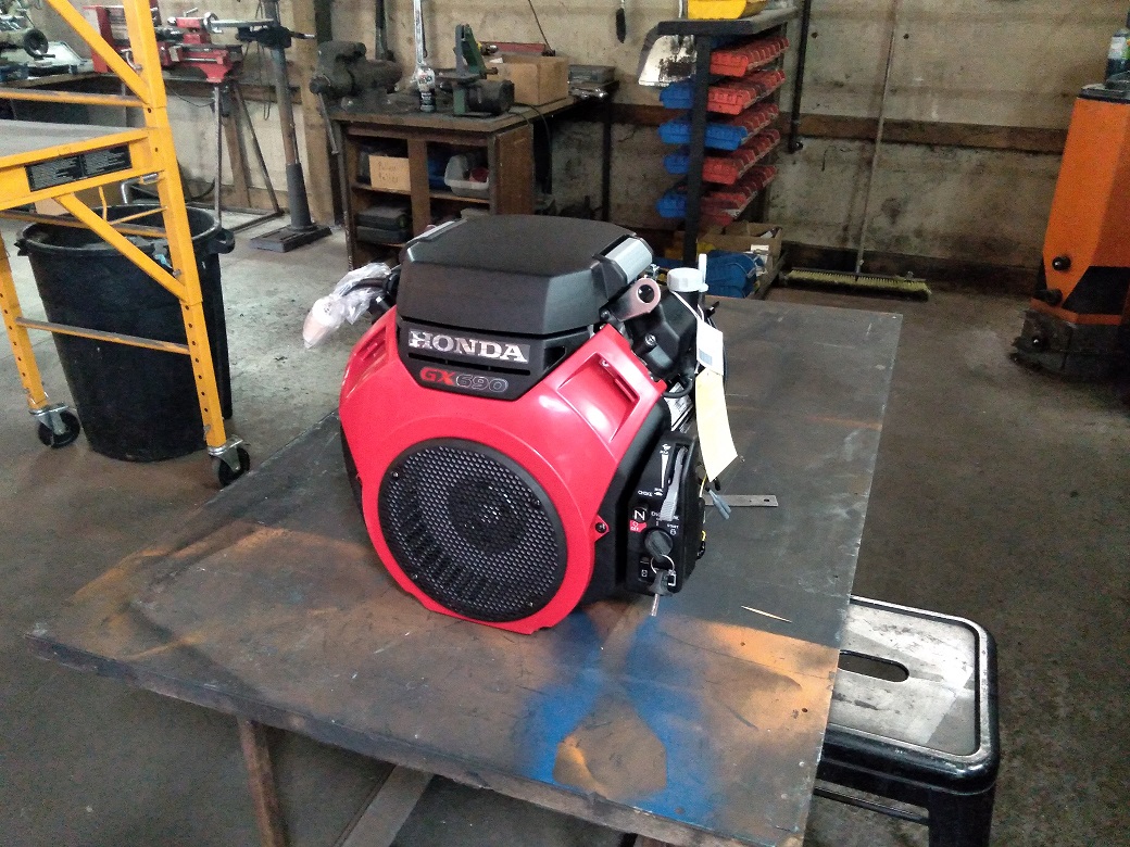

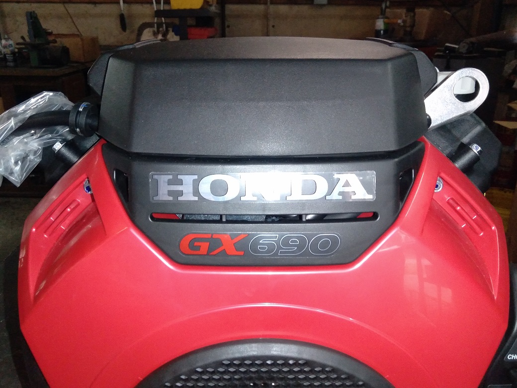

How much did that set you back goodness gracious. Even the clones of those cost about 800 or more.
Not mine its for a client build. This is the power plant for the new 5 kW power unit with automation. Believe me Ill post a lot on this one. I have the power head here as well
Oh yeah forgot it was $1700 shipped and I think this gen is done. I more than likey will not be able to touch the new ones for less than $2500 in the future. But hey its a Honda!!!
I wish I could find a wholesale place to get the 50cc 4 stroke Hondas or clones. I wanted to tie in 4 to a single drivetrain for a bike idea but to get the kit engines you have to buy the whole kit. Seems like a waste.
I use Power Equipment Direct and Jacks Small Engine Warehouse. I could not get this engine from either they are basically it at as far as I would put trust into those vendors. I had to order from Northern Tool. They are your next best bet if you can find them from a reputable vendor.
I think there is a supply issue as even Northern Tool had a delay in getting this to me. When I quoted this order I could get this engine for $1100 delivered too. Client drug his a feet a bit due to the Flooding over there in Belgium so I had to wait and now Im eating a lot of cost as a lot of stuff has skyrocketed.
I was hoping an engine like the GX690 could muster a bit more than 5kw on a woodgas but you would know best Matt. 22hp is ~15-16kw shaft power on petrol but I imagine the hp rating is a bit generous, then woodgas vs petrol and finally genhead (in)efficencies. i was hoping a predator 670, nicely tuned, would get 7-8 kilowatts into a battery charger? Seems now like that might be a stretch.
It can, I pulled 8 kW out of these all the time. But you cant put your rating the edge like APL does. People get angry about that. You have to factor in fluctuations and find an range that is a consistent.
8 kW is 80% of the actual gasoline output. A dumb system can not sustain this I always cut the rating to 50% of the gasoline rating.

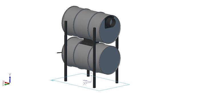

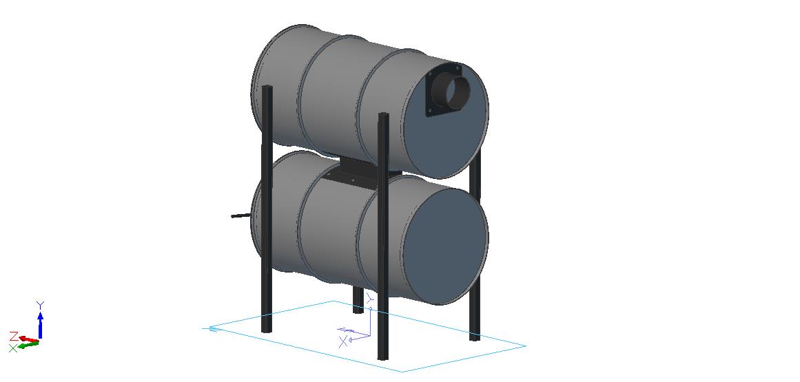

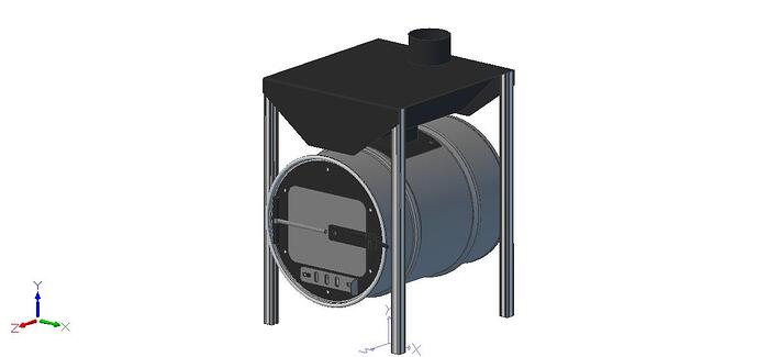

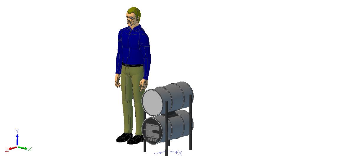

Micro Barrel Stoves are now in development. I will be building two versions to bring to market over this week and next weekend. They are based on the 14 Inch barrel drums. I will offer one version with a cook top attachment and a mini stacked version.
The cook stove version will be for heating the RV this year and will have the cook top add on. This will be built using the shorter 10 gallon drum that are about 19 inches long.
Then there will be the stacked version, the plan for that is for heating the shop this year. Seems how I can get free slat wood from down the road and pallets for free that fuel is the plan for heat this year and should work great in these smaller barrel stoves :fire:
This here is the base version
