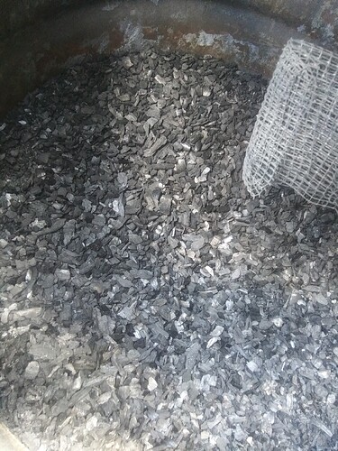

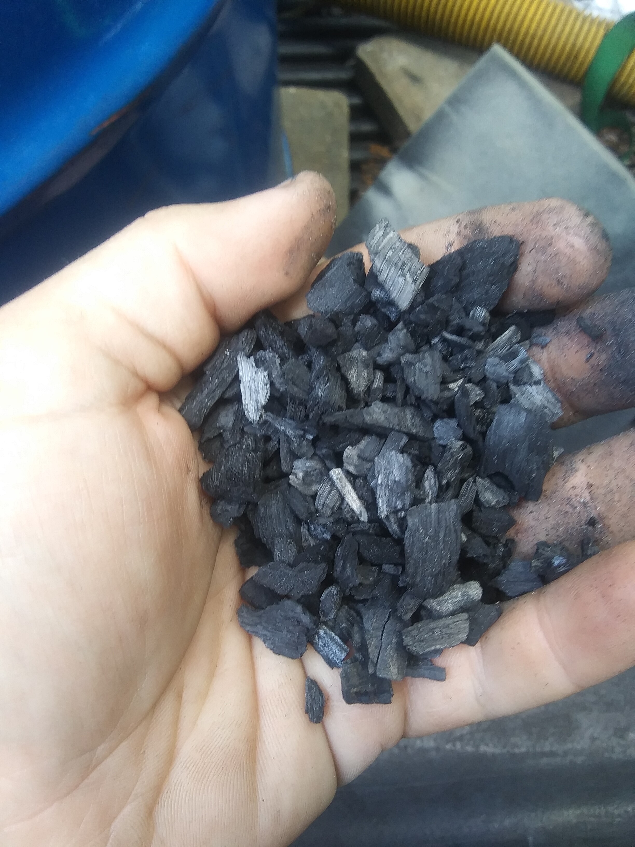

If you’re concerned about measuring distance to hopper capacity, I grind my charcoal down to small flakes using a cheap electric wood chipper. Very small efficient sizes. About 5 gallons weighs roughly 9 pounds.
Assuming you get at worst a mile per pound you could then calculate distance from the volume of your hopper.
These are more like flakes than small chunks due to the chipper blade.
Very small and fill up nicely with no major air gaps.

That’ll make it easier to process into engine spec sizes. Gary Gilmore says a size range of 1/8" to 3/4" cross section charcoal is ideal for an updraft unit. You can sift it out using hardware cloth mesh to get out the undesireable sized pieces.
Before I grind my material I pre sift my cooled down charcoal using 3/4" sized screen so I can keep a more diverse range of pieces. My chipper takes them down to very small sizes.
Then once chipped I’ll sift out the fines and dust.
It’s really tempting to throw in big pieces of lump charcoal but it’s the difference between weak gas and strong gas. Smaller pieces mean more surface area to produce and self filter the gas.

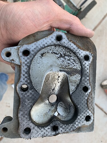

I was also wondering how dirty chargas burns, because I was playing with polishing the head of a flathead engine to keep as much heat in the cylinder as possible, but found that liquid fuels only kept it clean for about a hour or two. But it was about 100 degrees cooler for that time period.
It was reading around 140 for a hour and a half, than jumped back up to around 260, and would get up to 260 within a couple minutes from then on, so I was wondering if chargas would be a bit dryer??

Carbon buildup in small engines can happen in less then 30 minutes on gasoline. Check out project farm on you tube and all his fuel substitute videos all tested on small engines he removes the head between runs and compares carbon buildup residue as part of his conclusion on how well a motor would run on a given substance in a emergency situation. Iv been proding him for years to run his see through cylinder head engine on a gassifier so we can get a clear picture of temp and burn time since woodgas seems to get compared to propane a lot I’d like to see them run side by side and he has been toying with the idea for some time but hasn’t built one yet
