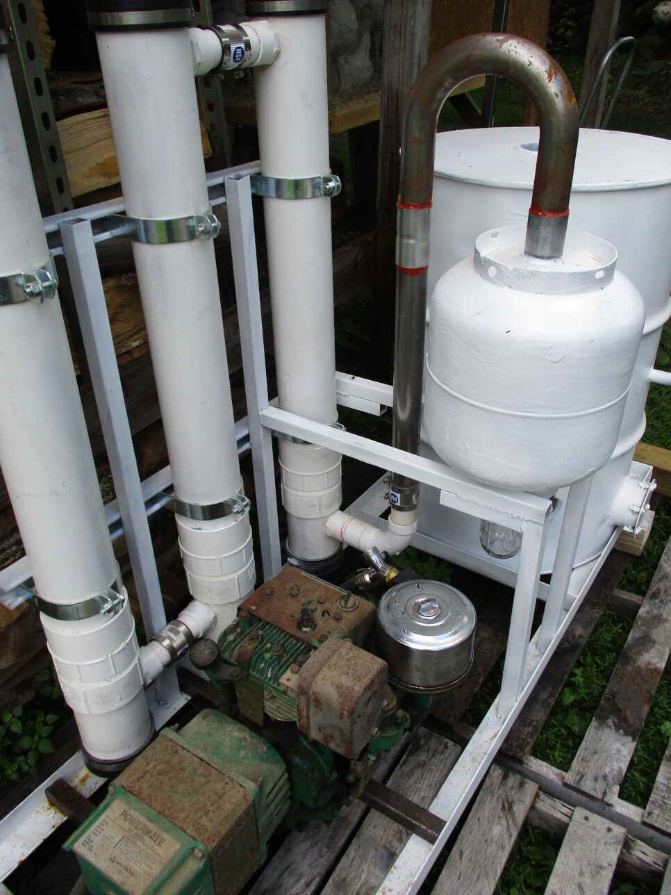

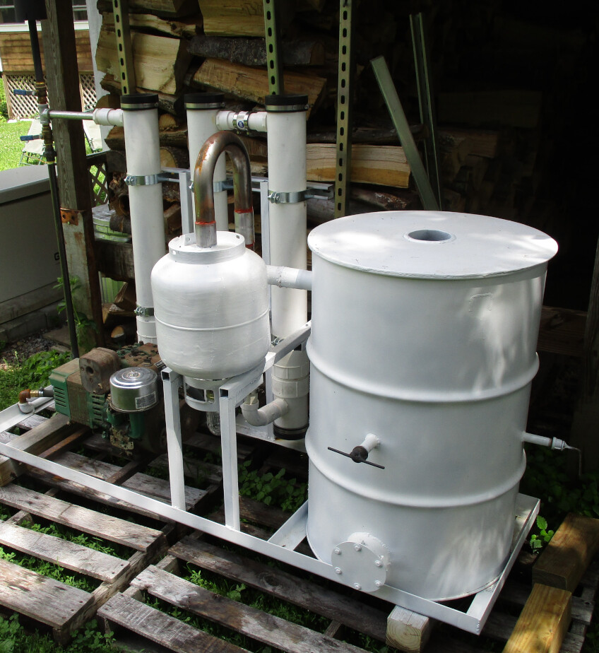

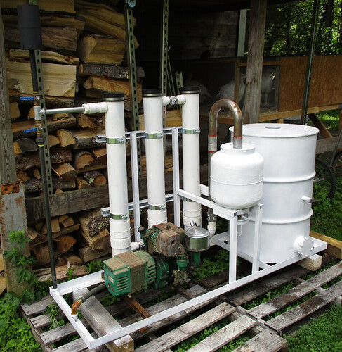

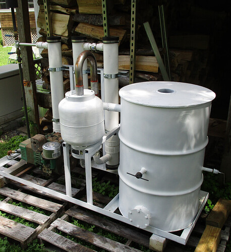

I just finished putting my gasifier together and have yet to test it. It is a 4" x 18" tube in a 50 gallon barrel which (according to the FEMA document) should be able to power a 15 horsepower engine. I’m mounting an old 8 horsepower generator to the frame after I clean it and make it pretty again.
Anyway, I don’t know how to start and adjust the gas/air ratio  for proper performance… is there a standard mix ratio or is it all trial and error? What should the valves be set at when first starting the generator?
I always start my charcoal reactor with my air at all the way closed, then tickle my way open until she starts.
Be ready to take that engine apart, FEMAs make a lot of tar.
Thanks Cody, I’m hoping that the three column filter system will minimize the contaminants but only time will tell I suppose. I appreciate the starting instructions, I’ll be giving it a try later this week if the sun decides to shine again… too much rain to play outdoors lately!
I’d say still try it out with flaring, your unit can still be converted to an imbert style system or a GEK style perhaps. If you haven’t yet i would suggest check out the library on site and get Wayne’s book, it’s a wealth of knowledge.
As cody said, femas are known for making tar. Having said that, I ran a fema about that size firetube on a lawn tractor. It worked pretty good. I found that fuel had a hard time flowing down in that small of firetube. Pellets worked well. You only need one valve to adjust the mixture. Pipe going straight through from the gasifier, it will draw what it needs. Then a valve to allow air in to adjust mixture. Ball valve is pretty hard to do. A gate valve will give more precise control.

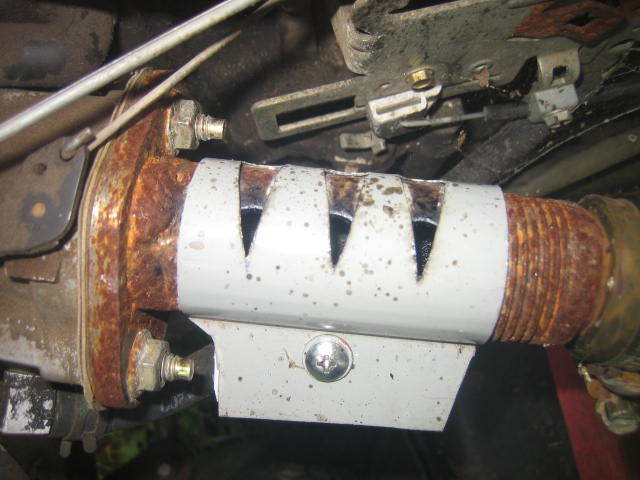

For your consideration, my simple, cheap, and effective mixer for small engines.
