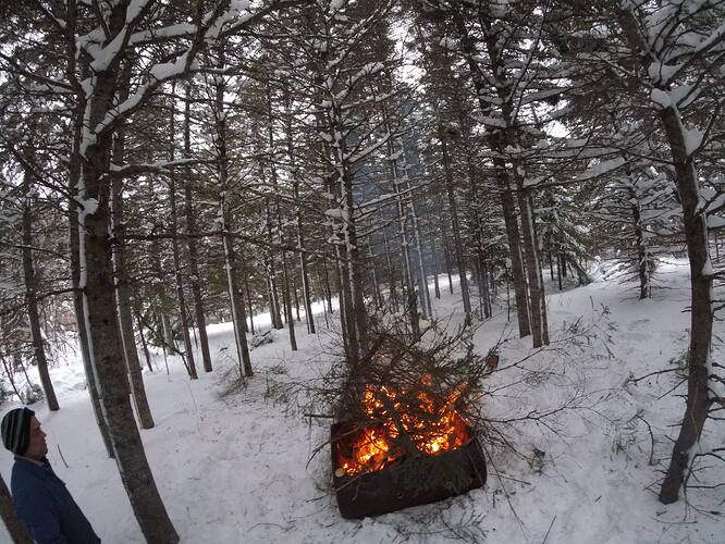

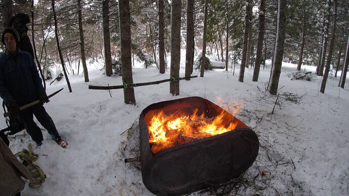

Christmas holidays are perfect for charring dry spruce heads.
Make fire, picnic with family and, as a bonus, harvest charcoal
I like the idea of the old fuel tank. They are readily available around here. I was burning up and old barn that I stacked the lumber in 6’x6’x6’ piles ( Dept of N’tl Resources law) I worked the fire with a rake as it burned. When I got it to hot charcoal I did like you and shoveled it into a 55 gal drum. It was summer but I had to put on an insulated jacket, a hoody, and welding gloves to shovel the coals into the barrel—that cured me of ever wanting to be the fireman on an old coal train. TomC
I have seen three different videos showcasing " old " styles of making charcoal that involved encasing dryish fuel in dirt, sod or a clay shell. I wonder if those methods give a higher or lower percentage of charcoal than an open burn? The open burn seems to give better operator control of the process. A shame to not harvest the heat in a cold environment but like most humans I find an open large fire to be comforting.
Making charcoal in a dirt shell will give more tars and an open burn will give more ash. That is why we prefer to use kilns or retorts. We want maximum charcoal with minimum tar or ash. This fuel tank idea looks like a good one. For those who heat with wood, just fill a can with sticks or pellets, cover with a loose lid and build a fire around it. works great.
Oval fuel tanks have a lifting handle on each end. Add about 15 feet ( 5 metres ) of stout rope or medium chain and you have an open sled to carry your other stuff to the forest.
