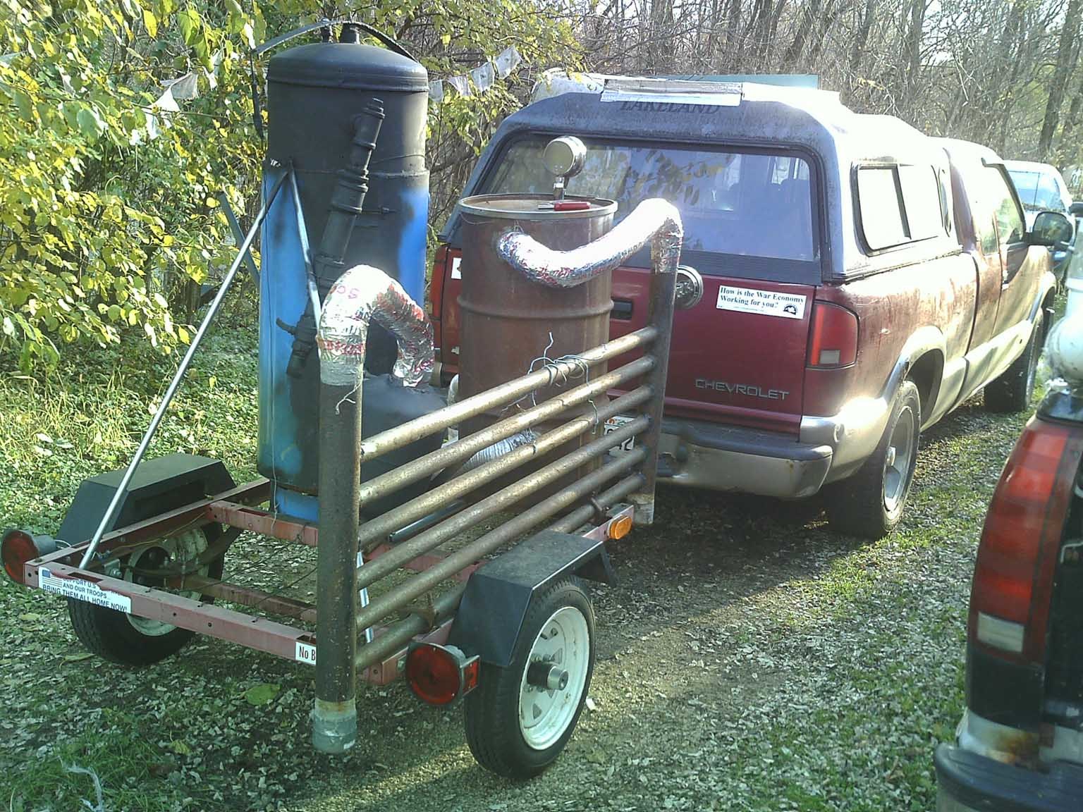

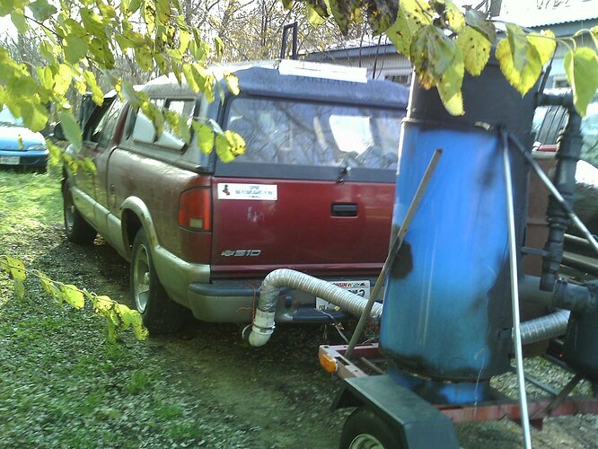

Kevin, Just be careful !! Even Doug ??? from New Zealand, I think, the older woodgas wizard built his gasifier into an international travelall and almost killed himself with CO so he warned about automotive use … Things get hot and you need to get at them in a hurry sometimes too. Wayne’s low profile AND airtight gasifiers as well as a symetrical cooling rack system keep him just under the radar as far as appearance goes. I don’t mind sticking out a bit and grow a long beard etc etc etc … My latest system is plain Jane .. It is very light and I can hook it up and take it off without a jack and I forget it is behind me when I drive .. I am waiting on some flex pipe I ordered to finally seriously roll with it .. They thought I’d have it on Friday … I’ll look your zip up on the USPS site .. It is 40 here right now at 7 PM and going down. They predict snow by the weekend (again)

just thinking a little less noticable. seem like around here they are looking for any thing too pull over.like you say it would not be good for camping; i would like too sheet the sides with aluminum/ with open top and ladder rack for more utillity if cash permits in time. your set up looks apealing. its light, easy too tow with gas missor cars, if i get cash some other time i would like to build a lighter wk gasifier to mount on
trailer.another wood gas meet makes it close to vassar, mi 48768 , or akron would be close, let me know so i can get too meet you and BBB folks.THANKS MIKE/ time too go weld about 10 more back welds on the tube finns.that part is done tonight. THERE is a sawmill by me there should be plenty of wood in spring or summer for sure , not sure in the winter how much he has too get rid of, mostly cotton wood.The other guy has big trailer loads of ash & oak hard wood for $100.00 .a while back he had at least 4 semi loads pree cut leaned up to his barn at least 10 feet up by 80 foot long,lots of hard wood not far from vassar 3 miles.any body is over this way just email me i get his number check on his wood supply.
