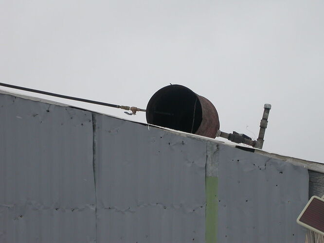

Gasifier on Barn Roof. This happened a few years ago and I thought some of you would like a laugh. Some of you may remember seeing the pics elsewhere.
When You are experimenting with a pressure gasifier Don’t make your flare line too small. I had two flares on this one 3/8" and one 1 1/2" I capped off the larger one and was shooting flames several feet with the small one. You can only run in Flame Thrower mode for a short period before You Launch it to the Roof.
A spring loaded lid would have prevented this. You can have fun playing around but you may need to patch the hole in the roof when you are done.

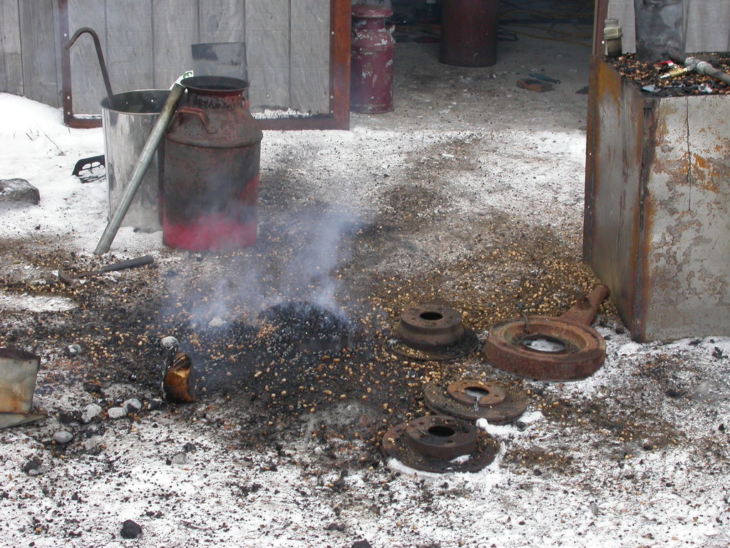

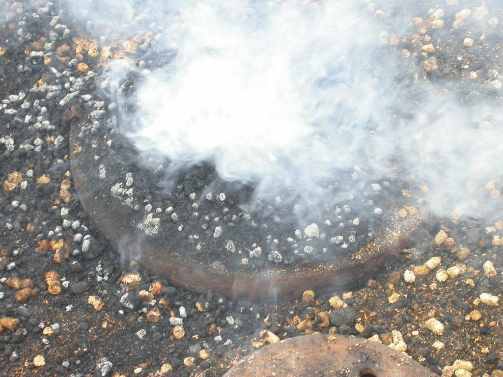

Pics of aftermath. And a Pic of a decent flare the night before.

I just saw this - man that must have been scary for a second or two. I think the one that tells the story best is the morning after photo of the remains left behind… rotors, other drum like pieces and scattered fuel. Looks like a launch pad of sorts… What kind of pellets were you using ?
