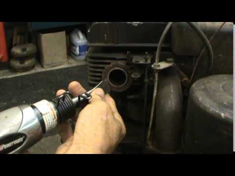

I forgot to consult You Tube before posting this but I found this there later. It is one way to do it.
A less invasive way would be to use PB Blaster (penetrating oil), and just saturate the joint with it. I’ve worked in the oilfield on components that were torqued together with thousands of ft/lbs, and PB Blaster worked almost every time. Sometimes, to make the oil penetrate the joint a little better, you can hammer the stuck part to shock the metals and allow the oil to dig in just a bit more. In certain situations when the metals bond severely tight, a few hours to a day may be needed for the oil to penetrate the joint deep enough for you to break the joint and unthread the part. The method in the video looks way funner IMO, but if you cut too deep, you can damage the threads in the block and possibly require a larger drill size and tap which weakens the block or head.

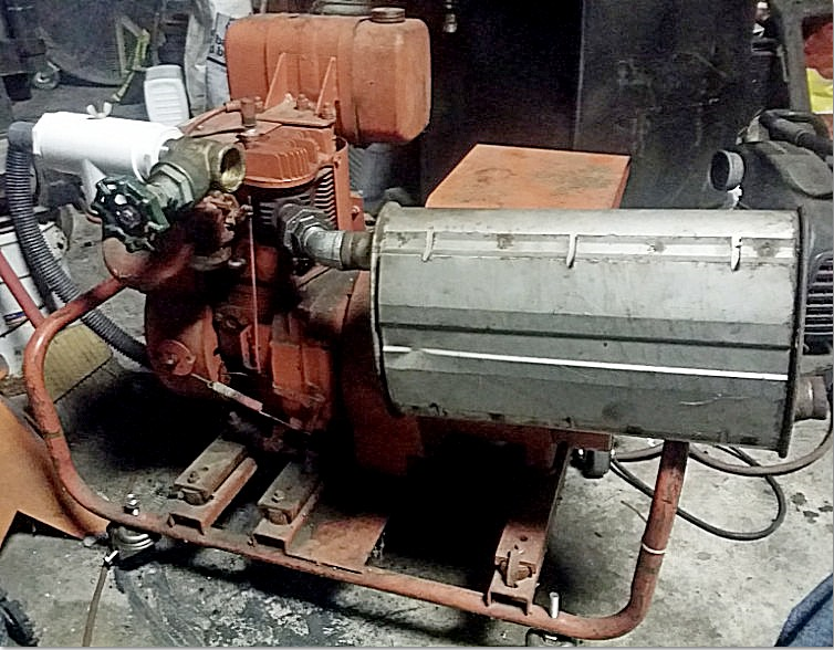

Thanks Mike, That’s what I did and it worked! Here is a pic with the car muffler in place. I don’t expect to run it on gasoline because the carb is gummed up from non use and it starts so much better on wood gas anyway. I had it running for 30 seconds or so by squirting carb cleaner in the mixer tee and I would have to say it sounds about 4 times quieter and with a much lower tone.
Nice Don , is that a 1800 rpm unit? Did you get it ? Or leave the sleeping dog lay? That a liquid cooled unit on right? My motorcycle exuaste is 3/4" and I used a bicycle seat post and used the height adjusting clamp for an exuaste clamp.
It is 3600 rpm and 1 inch exhaust. I used PB Blaster to get the threaded muffler off but left the nipple in the block.
