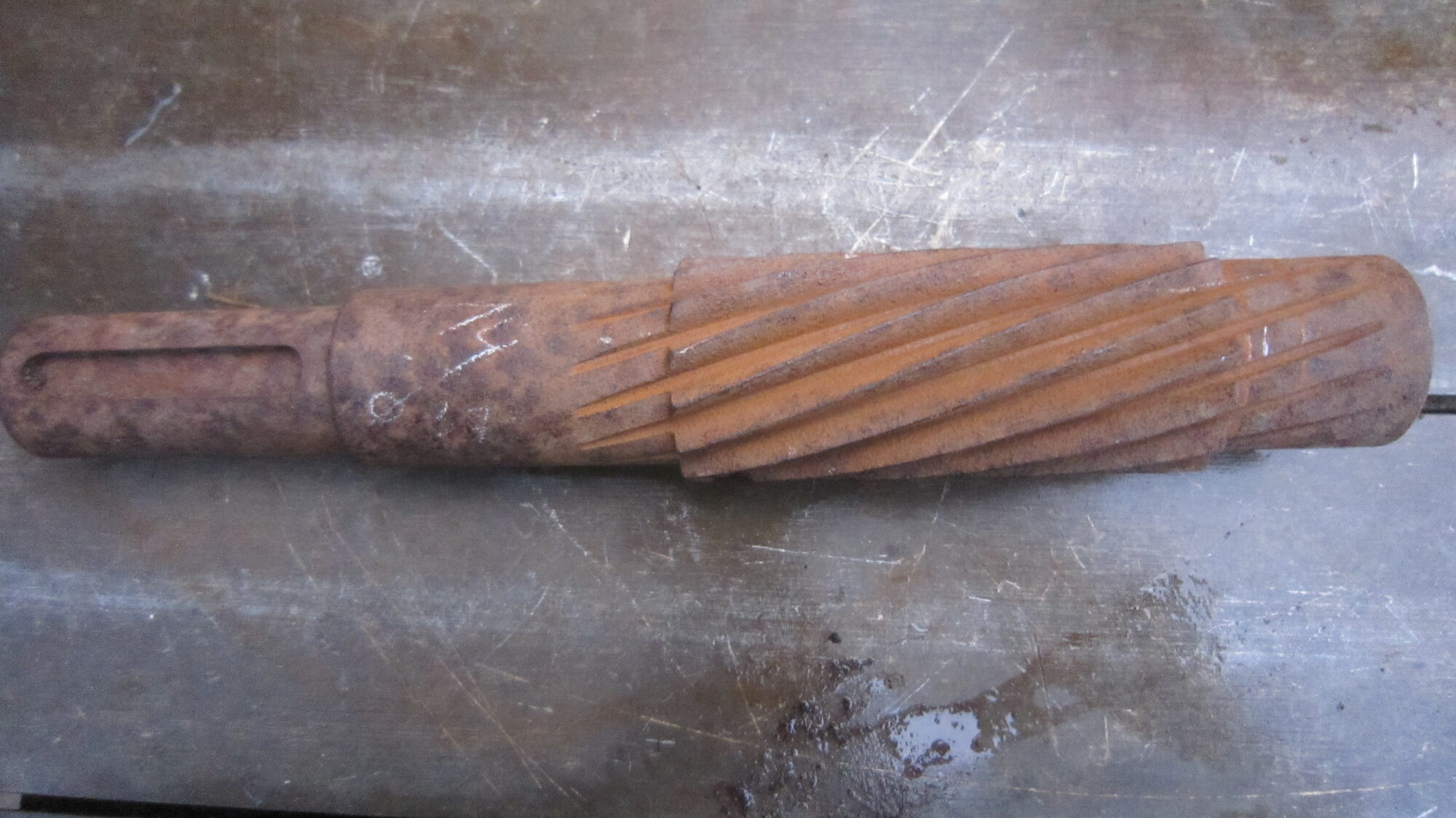

i found some pieces like that in our scrap pile…it is a piece from a gear and hardened…i think those pieces are generally hardened on the outer surface ind inside they are more soft for avoid breaking …i must cut with the angle grinder pieces large 1cm from the part with the grove…(for crop transport)
the angle grinder will cut it without problems i think and i get than some discs…but can i drill a hole than in the center with normal drills, or is the material also in the center very hard?
who has experience with material like this?
or must i glow the complete piece in the forge, and when yes, how long and what cool down method?
thanks for tips

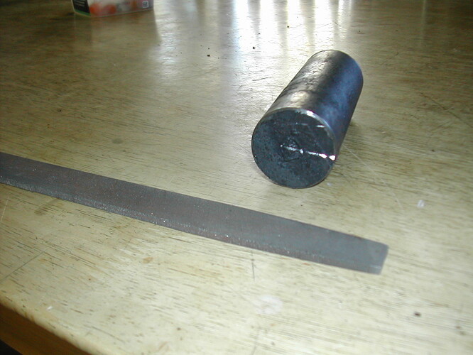

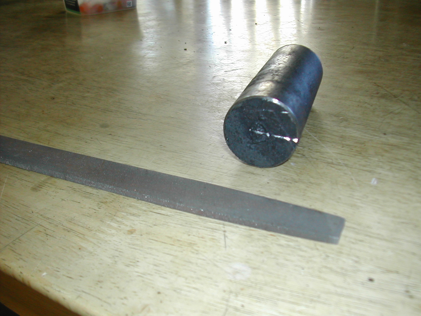

If you can cut the material with a file you should be able to cut it with a drill.

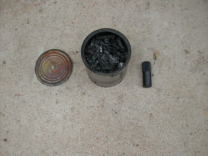

If you must soften (aneal) the material heat it to orange color. Then cool it slowly surrounded by charcoal for insulation. I use a big coffee can 150mm. You must put the lid on the coffee can or you will burn up all the charcoal. One more LINK

rindert, thanks for explanation…would ash also be good for cooldown or is charcoal better?

I have not tried ash. It’s a good question. Perhaps you can try it with a piece that is not important.
