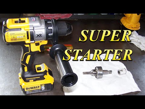

Or try this
I might try one of those if I can’t find one with a sprag in it. One video said sometimes the direction lever flies out of position from centripetal force which locks it, and you might not notice it.
Here’s another one where a guy used a sprag from a Chevy starter.
For a Counter Clockwise engine like a Honda.
I saw one like that. I might just get the racheting thing. I have motors that spin both ways. It will be the easiest. And probably cost the least overall unless the rachet locks and I end up in the hospital. Thanks for encouraging the Amazon to come to the door ![]()
