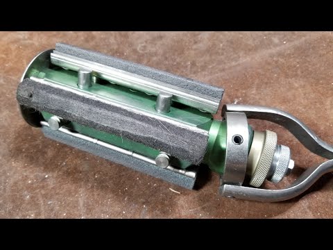

Here’s something I’ve recently learned. You can resize engine cylinders in your garage, which allows you to do an engine overhaul for relatively little $$$$.
I found this video about a micrometer cylinder hone. Then discovered that cylinder bores are hardened at the factory to 1.5-2.5mm skin depth. This is much deeper than anyone would rebore.
This is one of those old style AMERICAN tools, its big, clunky, expensive, it works very well and lasts forever.

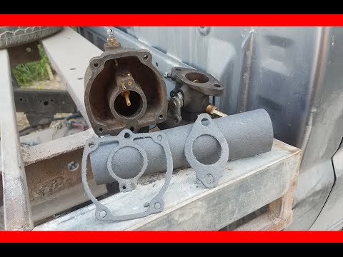

The gasket between the bowl and the carb on my 6hp briggs dried up and broke. Can I use like rtv or do I have to go buy a new one and if so, are they a standard size?

Nope never use RTV or any sticky sealer product on carburetor to manifold/or/head(s).
Never, ever.
Here’s why. Many, many carbs in there bases have grooved passageways for flows.
The old Stihl MS80 carb did not. The new replacement does.
Any filler goo will clog these up.
Just use a gasoline rated fiber gasket sheet scissors cut. And punched or drilled for the mounting bolts/studs holes.
None readily available?? Temporarily use a colored printed breakfast cereal box sheeting. Cut out two matching with the shiny sides stacked outwards.
Safe jet removal? I’d have to see a detailed picture.
I don’t think RTV is gasoline rated. I’ve never tried using it for a float bowl.
There are no holes. It is the one between the bowl and the carb. It looked like a big o-ring, but It didn’t flake off like one.

The edge squeeze out inside will likely gasoline react enough to break loose getting sucked up into the center feed well.

Here is for principals on carb gasket making:
You being soft zinc casting versus his cast iron want to use only light tap-tap’ing around for the outer impression you will be cutting later away. Afterwards; (you the reverse of him) rough cut out the center first. Start with the center cut out small. Able to fit down then to tap impression, then small fine scissors spiral work outwards gapped to the inside of the outer tapped impression. Last you cut the outside to remove the impression and just fit inside the raised edge.
Might take you 2-3 tries, but this can be done alright. Me. Summers 1970 and 71 in a small engine shop. Such skills learned never really goes away.
Ha. Life is great if you don’t weaken.
That works. I used to use old telephone book covers because they had a layer of thin cloth in them. Don’t know where you find that type of material anymore.
I was thnking snap ring pliers but coating them is an excellent idea if it doesn’t make it too thick.
I think I have seen that method used for a gasket on a tractor.
I THINK in small engines class, we were supposed to take the gasket material, poke the holes for the bolts out, put it on, cranked the bolts down, and then remove them to leave the impression. OR that might have been the shortcut, and you were supposed to coat it with the indigo stuff from the metals shop, and set the gasket on it.
Then cut it all out with a utility or exacto knife. That got around kids smashing up their parents lawnmower carbs and aluminum engine blocks up in class. And I wouldn’t have remembered that without you making me think about it.
If it is what I am thinking it is, the library probably has some.
The plastic coating on boxboard is #1 PET plastic, the stuff they use for water bottles. I think they use it on cereal boxes, but for sure frozen foods and like soda and beer 12-24 cases. Incidentally the thickness of the coating is why a lot of recyclers won’t accept them.
Boxboard with a piece of plastic cut out from a water bottle might actually work better then two pieces of boxboard since the cardboard layer is thinner. Once that heats up, the pressure seemingly would press the plastic into the cardboard.
Hi Sean, i’ve actually tried gas resistant rtv on my riding lawnmower, almost exactly the same carb as yours, dont work, exactly as SteveU says it clogs the inlet for the nozzle, everytime, 3 attempts ![]()
This little gasket is cumbersome to make, because it’s so thin, but it is possible to make from gasket material.
Original should be like an o-ring with square cross section.
Ptfe thread seal tape works as a emergency solution if you wind it carefully around the bowl, about 3/4 of it’s width on the outside, the fold the rest over the edge.
About 5-8 tight turns.

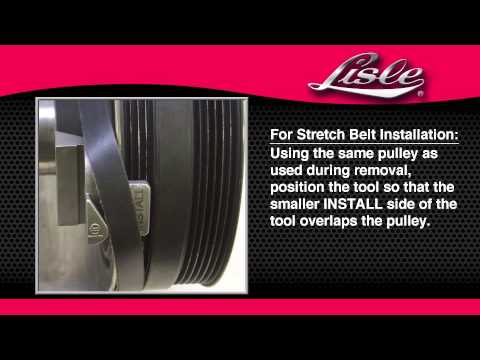

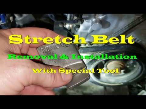

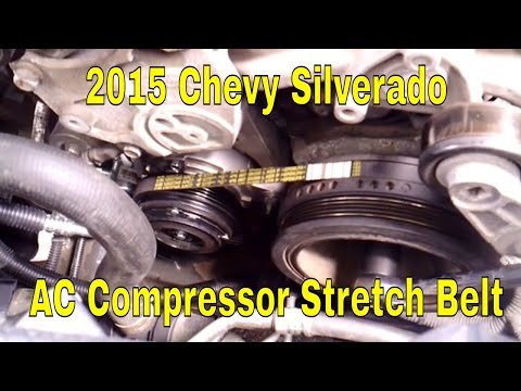

Or some can be done with this aftermarket “universal”. Watch these for just how much these belt when new can be safely stretched and recover:
So to do the power steering pump now noisy belt on the Wife Ford Edge; driving 25+ miles to buy this tool, I read the 1 star reviews. WILL NOT work on 2007-2014 Ford Edged due to inner fender wall clearances. Users had to use wooden popsicle sticks plus the “Zip-Ties” (nylon tie-wraps) method. ??? Here:
The TIP is to also use a few cut nylon tie wrap lengths UNDER the belt too to help it slide on with less chance of being steel pulley edge nicked, damaged.
Always learning
First time I’ve even heard of a stretch belt.
You should be glad not knowing about them, and very happy as long you dont need to replace one, a real PITA.
At work we don’t have any special tools for them, only some hard plastic wedges, often we help each other, one turns a pulley, the other guides the belt from below ![]()
yeah. That is why I asked. I wasn’t sure if they made a gas rated gasket material. ![]()
Apparently I can order a whole new knockoff carb with gaskets for 10 dollars off amazon or ebay, or buy gasket material for 5 dollars locally. hrm how cheap am i?
