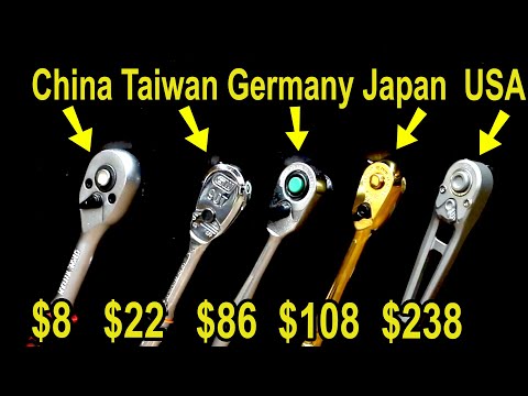

Good Morning All,
The Project Farm guy has a new tools video out comparing 1/4" drive hand ratchet tools.
I like this guy a lot.
Watch and enjoy. Learn. And then I’ll show you want I learned to use to get best access, make-time and earn a living wrenching on modern vehicles:
Here is the reality of working on modern vehicles . . . you really need 3-4 different 1/4" drive ratchets plus some very special extensions and adapters to get accesses; and get the jobs done quickest, and safest:
That fine toothed, round headed, yoke swivel handle ratchet, is SnapOn. My #1 go-to. Always teamed up with a good all-the-way through durable plastic handle extension. This one a MAC. I first had one in Metrinch brand. The best part of that whole tools set.
Watch how I can shift from power breaking free; to finger tips speed:
And then figuring the other hand is part holding, and positioning even able to one hand pop it off and catch the ratchet and still be able to finger tips spin off a nut, or spin out a bolt:
The other hand then holding freed up; able to reach down to catch that loosen nut or bold from dropping off, and disappearing.
Back to my primary use three:
Note the head thicknesses and the reversing flipper stick-outs.
The L.H. one, the most versatile, expensive SnapOn.
The center one a simple straight forwards Craftsman used ONLY for brake nipples bleeding. The squirting brake fluid corrosive; and rubber and plastics reactive. So’s I WILL Not trasnfer this as a later same ratchet use problem to under hood. Or Worse! Inside the vehicle. This Craftsman easy to wash out with break clean spray or even snap ring disassemble, clean, and re-lubricate.
The R.H. ratchet is my two handed, lower arms and shoulders power break free ratchet. Been replaced a few times. Broken. This current one? Hmm. A Craftsman made-in-Taiwan I think. Has held up.
And it works best with long standing off wobbly-ended extensions:
I got these off of the MAC tools truck. My first exposures set of these were 3/8" in that Metrinch set bought. Still working.
My fourth 1/4" ratchet used is s-o-m-e-w-h-e-r-e about the farm . . . garden shed replacing the Stihl weed eater carburetor? As the first found, and grabbed?
It is a very thin headed version I got for some tight, tight, crosswise front end of engines working. Cadillac crosswise V-8’s water pumps. Tight, tight, tight. Branded a Craftsman. Made in Japan.
So just like woodgasifiers: one-for-all would be far too compromising, and use-limiting.
Never had, never even seen an extension with a screw driver handle on it. What a great idea. First set of tools I ever owned were Craftsman. Built my first chopper with them. I guess that’s why I’ve always been so fond of them. I still have the original 1/2 drive ratchet. 58 years of use.

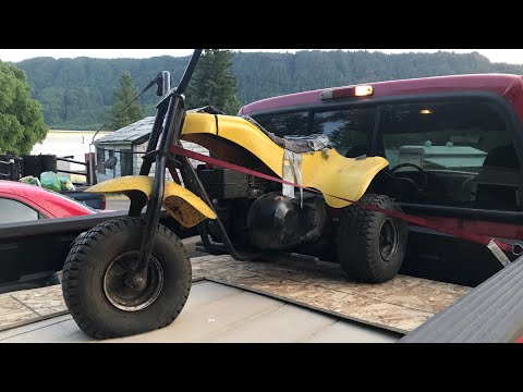

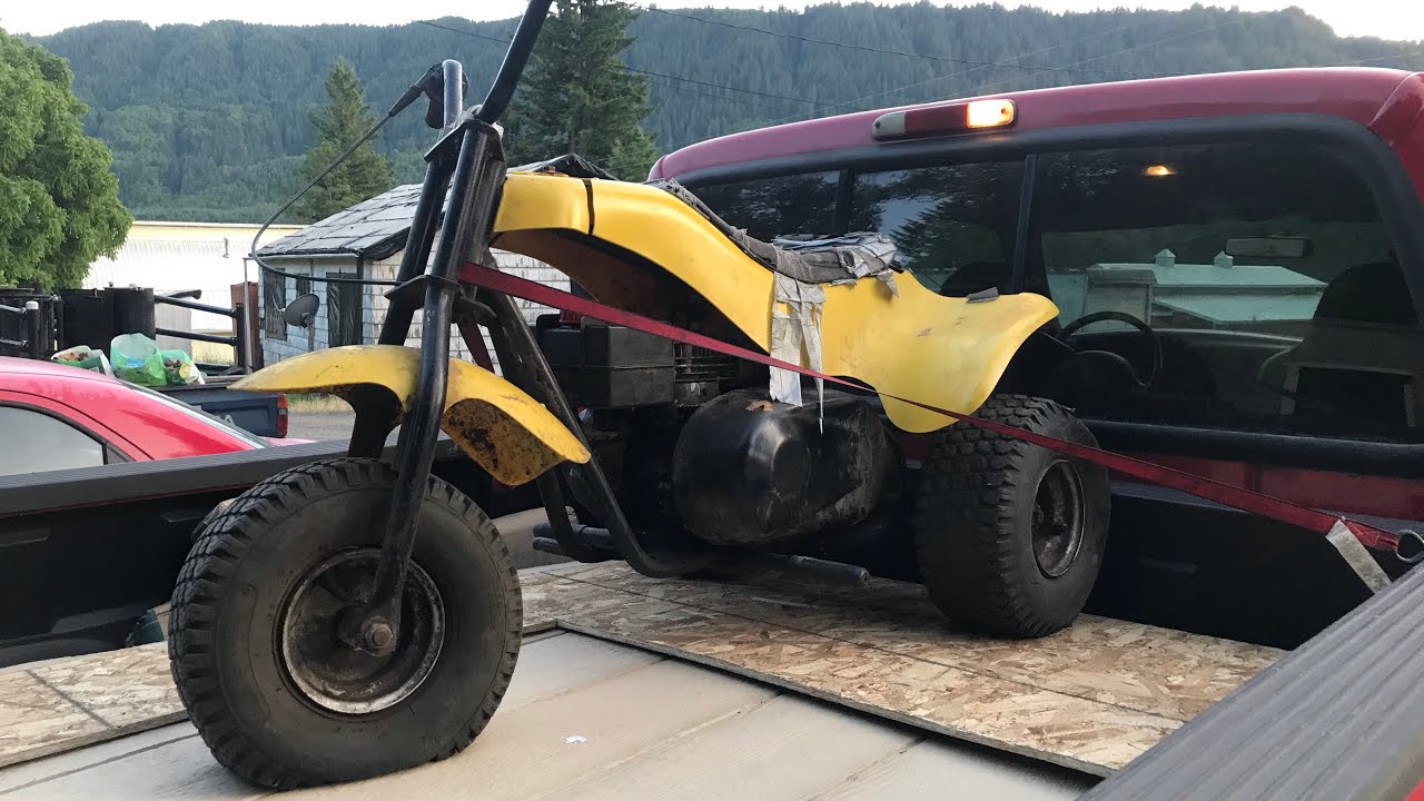

I’ll put this one here,a trick I learned years ago for patching broken plastics back together
Thanks Used the tip right away. Fits perfect​:grinning_face:
Mapp gets the staple too hot, and you burn away the plastic material and leave a carbon deposit layer on the staple.
They actually sell the hot staple guns on amazon for 10-30 dollars. But it is about the same price as buying actual plastic welding tips to attach to a hot air gun. Some plastics can’t be welded, and you have to identify the type of plastic first.
I’d never have the patience to bend and insert all those menders. I’d just fiberglass over the old shell. Maybe a holster to fill up the old hole. :cowboy_hat_face:
