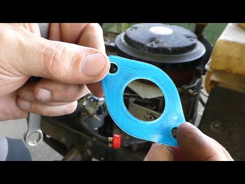

Another tool in the toolbox, 3d printed TPU gaskets. A couple of people on youtube have proven they can print a gasket out of TPU (Thermoplastic PolyUrethane) for the carburetors on their small engines. TPU seems to hold up as long as you don’t get it close to 200 degrees Celcius or over 392F.
They’re resistant to gasoline and oil, one guy kept a damaged print in a jar of gasoline for over a year to see if it would melt and it hasn’t.
I’m going to see how well this works for my square body and it’s going to double as a phenolic spacer. If it can survive the hot hot conditions of an air cooled engine I think it’ll be fine on a water cooled engine.
TPU is a rubbery material and is fairly flexible. I’m using TPU 95A, the number means it’s a Shore Hardness Scale A of 95 and that’s roughly as hard as a shopping cart wheel.
Incidentally because I’m having to make these gaskets in CAD I’m building up a library of different gasket flanges. I’ll be uploading these to Thingiverse where you could just use them as guides for cutting your own paper or cork gaskets.
If anyone has any requests PM me and I’ll try my best to copy it in CAD and upload it to Thingiverse. I’m also using these to make my own steel flanges to use as something to trace onto the metal. I’m bad at paper drafting but I sure am good at stencils and transfer punches.
I don’t think a TPU gasket could replace any spot that gets hotter than 150 Celsius, so it could work for an OHV cover in a small engine or a carburetor gasket. I like to stay as far away from the limit of a material because I have to consider longevity.
thank you. I never thought about actually -printing- them, just cutting them from a sheet.
Vinyl cutters, drag knife style, can be great for gaskets though the material will be about as thick as the consumer grade ones can handle. Best to use a new/sharp blade for gaskets.
My wife has a “Cricut” that doesn’t see that much use but some past projects she used it for came out amazingly well.
Cricuts work great for a standard gasket, I’ve seen videos about that a lot.
