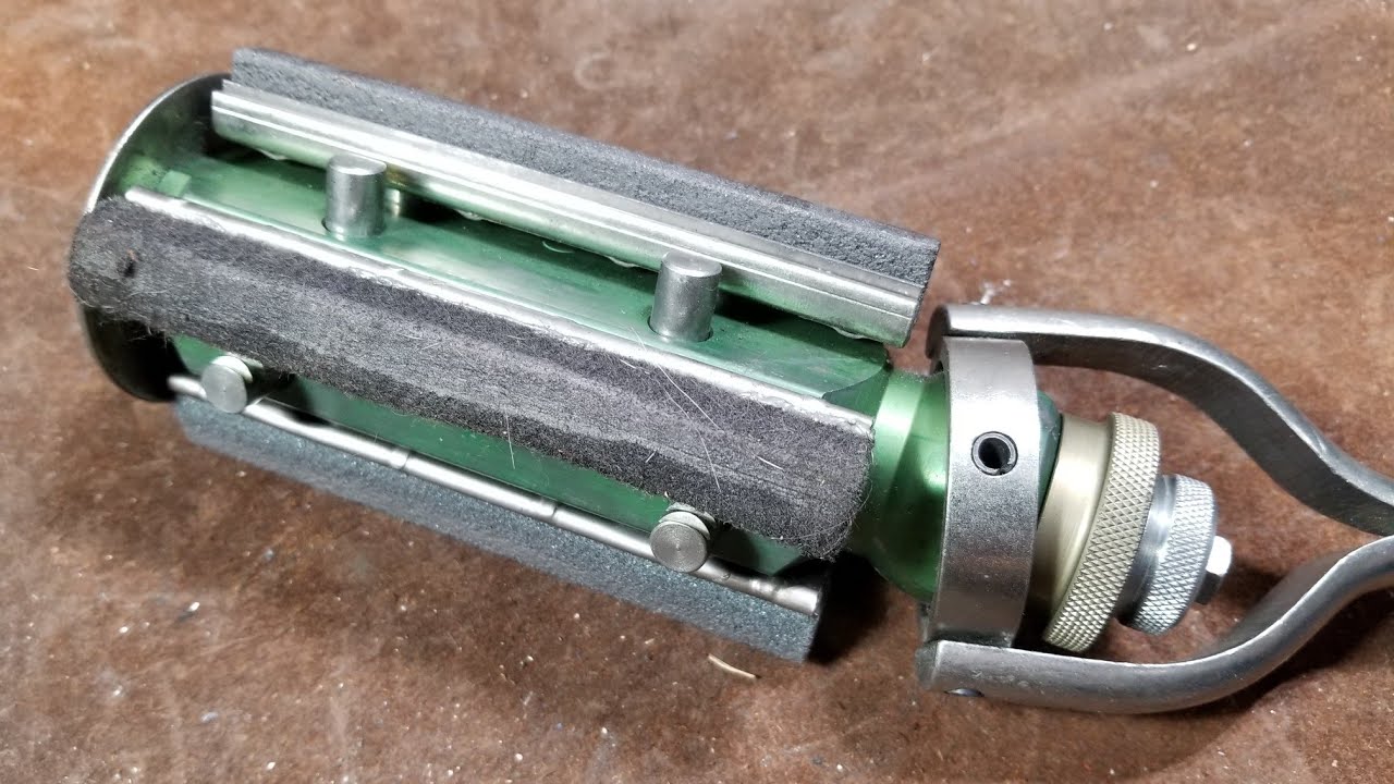

I agree with Bruce, most engines like that are not economically repairable. But if you are GOING to do it anyway. Guilty party here. Then I recommend a micrometer cylinder hone. You will need to clean the stones. I found that an old Dr.Collins Perio toothbrush is the best.
