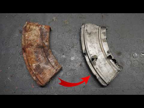

I just saw this video about rust removal. has anyone else seen it?
If it is real, he is pretty thorough, and makes a lot of sense. The comment that caught my attention said “… i submerged a cast aluminium water pump with metal bolts entirely seized and full of corrosion, after the treatment it spun freely, removed all corrosion and all bolts were removed with ease. …” (he also mentioned testing with an ultrasonic cleaner on other stuff, so he may have been using it for this as well.) I have a couple of steel hangers someone put in a cast piece of aluminum, and i can’t get them out.. so maybe this will work..
The recipe:
  • Per 1L of H2O
    1: 100grams Citric Acid.
    2: 40grams Sodium Carbonate == 63Grams Sodium Bicarbonate == 30grams Sodium Hydroxide.
    After reaction has completed, add final ingredient.
    3: Arbitrary amount of liquid dish soap.
Interesting video. I’ll give his method a try. After I burned up the stuff in my shop fire, but the time I get some of the salvageable stuff out of the debris a lot of it was rusted. I went through a lot of Evaporust trying to salvage what I could. For more surface types of rust I always liked phosphoric acid brushed on. When the surface turns chalky white the rust is gone. Now for bigger stuff I use washing soda and electrolysis, but this method is similar without having to mess with a power supply and anodes.
I have used straight white vinegar for soaking red rusty threads on galv fittings and leave them soaking for 2 or 3 days come out looking like new , but you must oil them straight away or they start rusting all over again . try it and be amazed at how the simple natural things work
I have used saved pickle juice and will sometimes add 75% vinegar to it if there is a large amount of rust. Like if I want to remove the mill scale from a big piece of steel. 5% molasses in water is a cheaper way to do it.

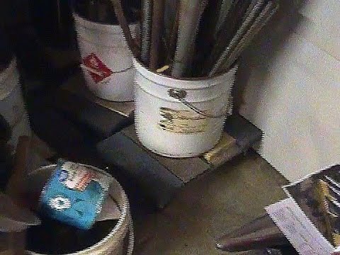

One way to store steel rods and bars in the hobby metal shop:
Here I show a few of my storage methods for bars, rods, tubes, etc,. but then I focus on one way that has worked out well for me.
