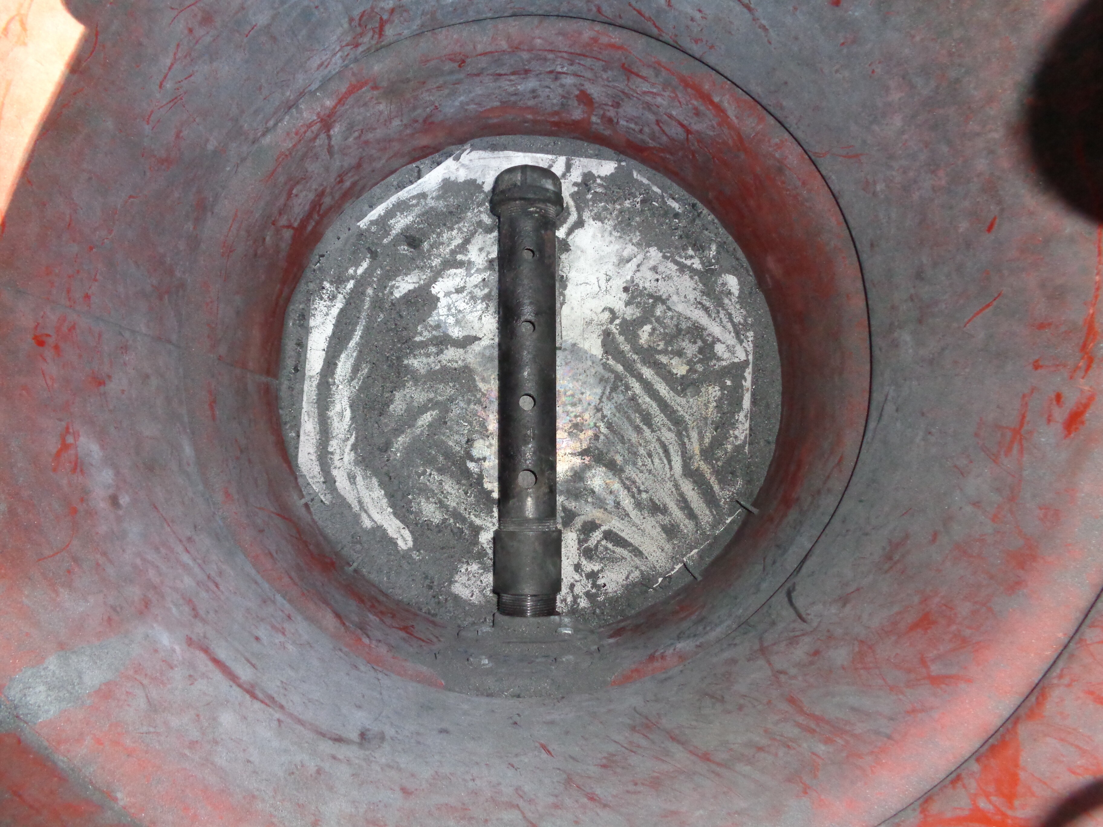

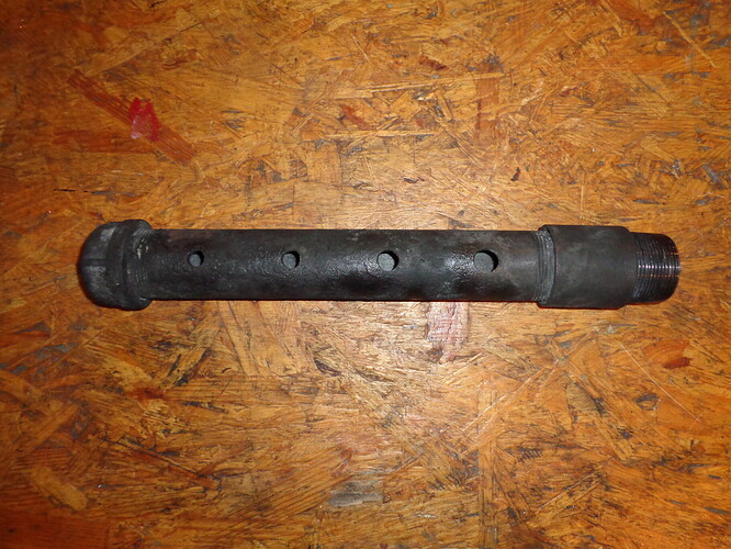

I did the annual clean-out of the Toyota gasifer today. I was curious to see the difference a year without exhaust gas return made in the nozzle condition. It seems to get blacker each year, but there continues to be no particularly noticeable erosion of the metal. I maintain about 2 drips of water per second for cooling and extra power. Thanks again, Kristijan, for the flute nozzle design. The slag was in the form of porus clumps. Planning to take it to a car show tomorrow. We’ll see how that goes. Here are photos of the nozzle.

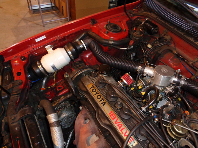

Since my trips are short with many stops, I decided to make some changes which permit easier shut down and restart.

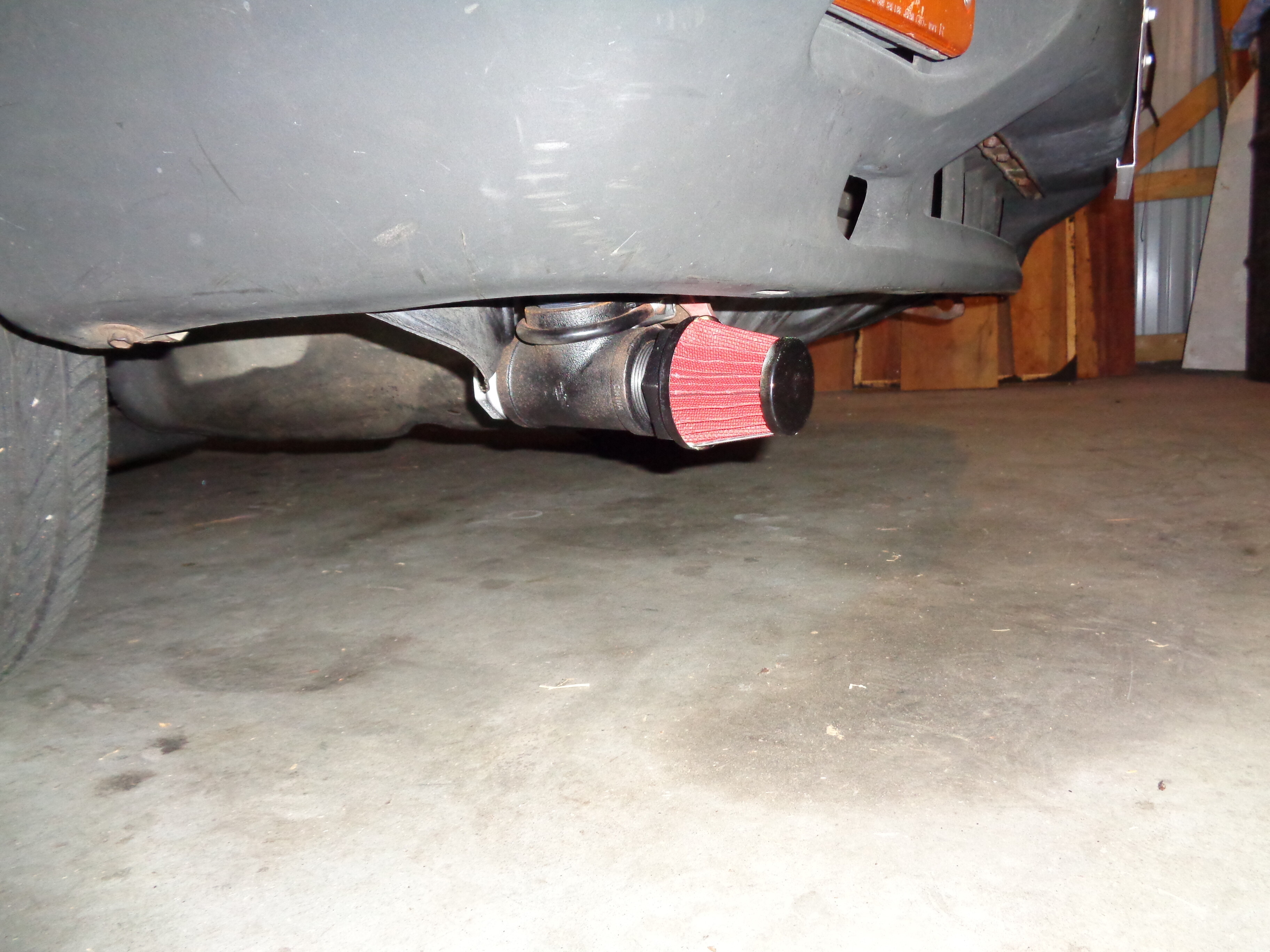

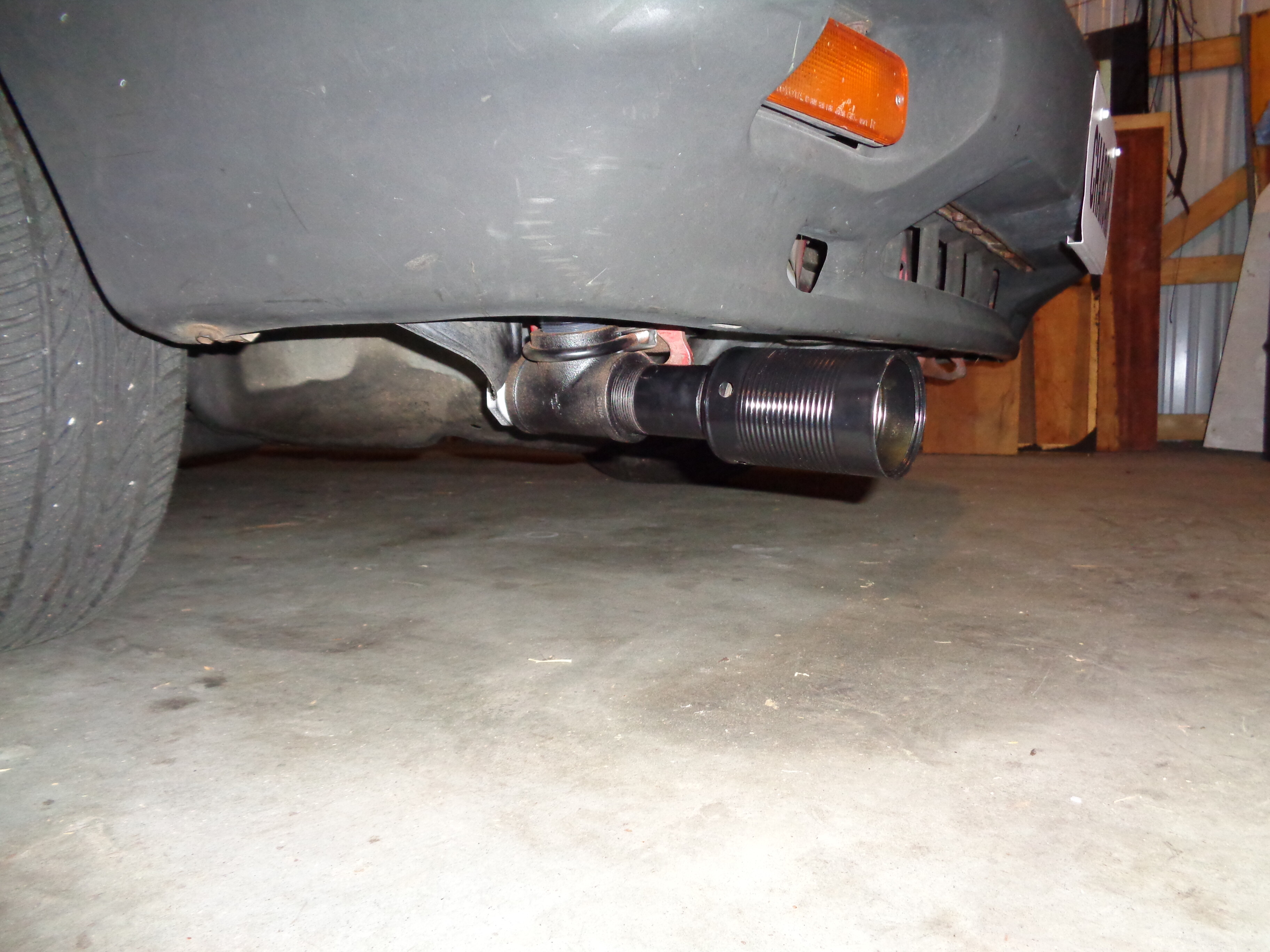

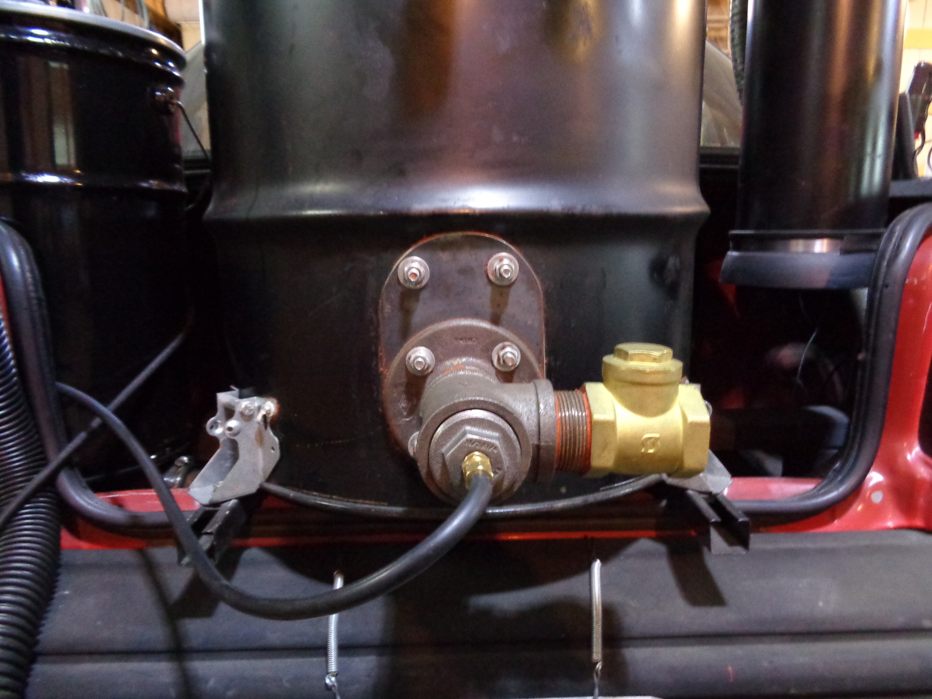

Instead of the stand-alone blower and flare burner arrangement I have been using, I permanently installed the blower where the windshield washer fluid tank was located. The blower is connected to an outlet/inlet underneath the front of the car to which I can attach a flare burner or air filter. The way it is set up, I avoid using a valve. I don’t like the air inlet location, but did not want to cut any holes and wanted to avoid opening the hood when starting up (Suggestions welcome). I use the flare burner on initial startup, then change to the air filter. I can leave the air filter on the remainder of the time.
On the reactor, I added a check valve to the air intake and changed the water drip nozzle which is removed when lighting up.
Looking very clean Steve. I still need to put in a blower or two in my setup. I still start up on gasoline but I’d like the option for a flare.
Steve, wish you luck with that checkvalve. I never had luck with them. Idled real bad with one installed.
Thanks Cody. Kristijan, this is the swing type check valve (no spring) and it’s tilted so that gravity just causes it to close all the way. So far, I haven’t noticed any difference in the idle.
I have made one other change which I failed to mention. After seeing some others with larger engines using smaller nozzles, I got another pipe for my flute nozzle and drilled four 3/8 inch holes in it. So far I have not been able to see any clear difference. The other pipe had four different size holes which averaged out to about 1/2 inch each.
