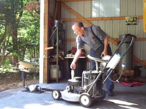

I haven’t yet posted a video my charcoal-powered lawn mower, so I made one today. This genuine cold startup was not as smooth as I would have liked:
Steve , "not as smooth as i would have liked " what you talking about any smoother and you would have slipped over !
Great demo now move the camera and mow some grass .
keep up the Great work

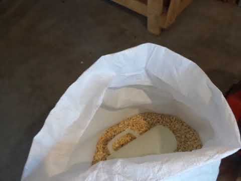

You know its almost Christmas when you hear the mill grinding corn for grits and corn meal Christmas presents.
Beautiful mill! Even double screened just like charcoal :slightly_smiling_face:
Steve, that’s probably the first video ever on grinding corn on charcoal. Very nice setup.
I had no idea what grits was until Kristijan and I were offered at Wayne’s place :smile:
Thanks, Kent and JO.
