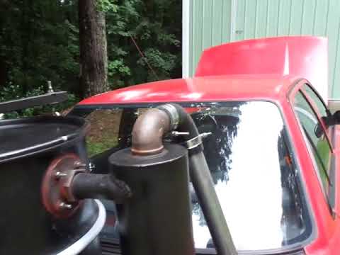

So, now that I am once again able to upload photos, etc., to my project thread, here are some updated photos of the car.
The hose to the engine air filter has been extended out to the front of the car so I can conveniently attach the flare burner when starting up.
I may have changed how the water drip is attached to the gasifier since the last photo.
The way the gas line, blower, and filter are arranged, I only need one valve, the air mixture valve which is located on the left side of the T fitting on top of the carburetor.
I will try to upload the latest brochure here. The photos shown above have been included along with some text update, and an updated drawing of the gasifier.

Since my startup procedure has changed somewhat since the first video, I decided to make an updated one, a short road trip, and shutdown video.
