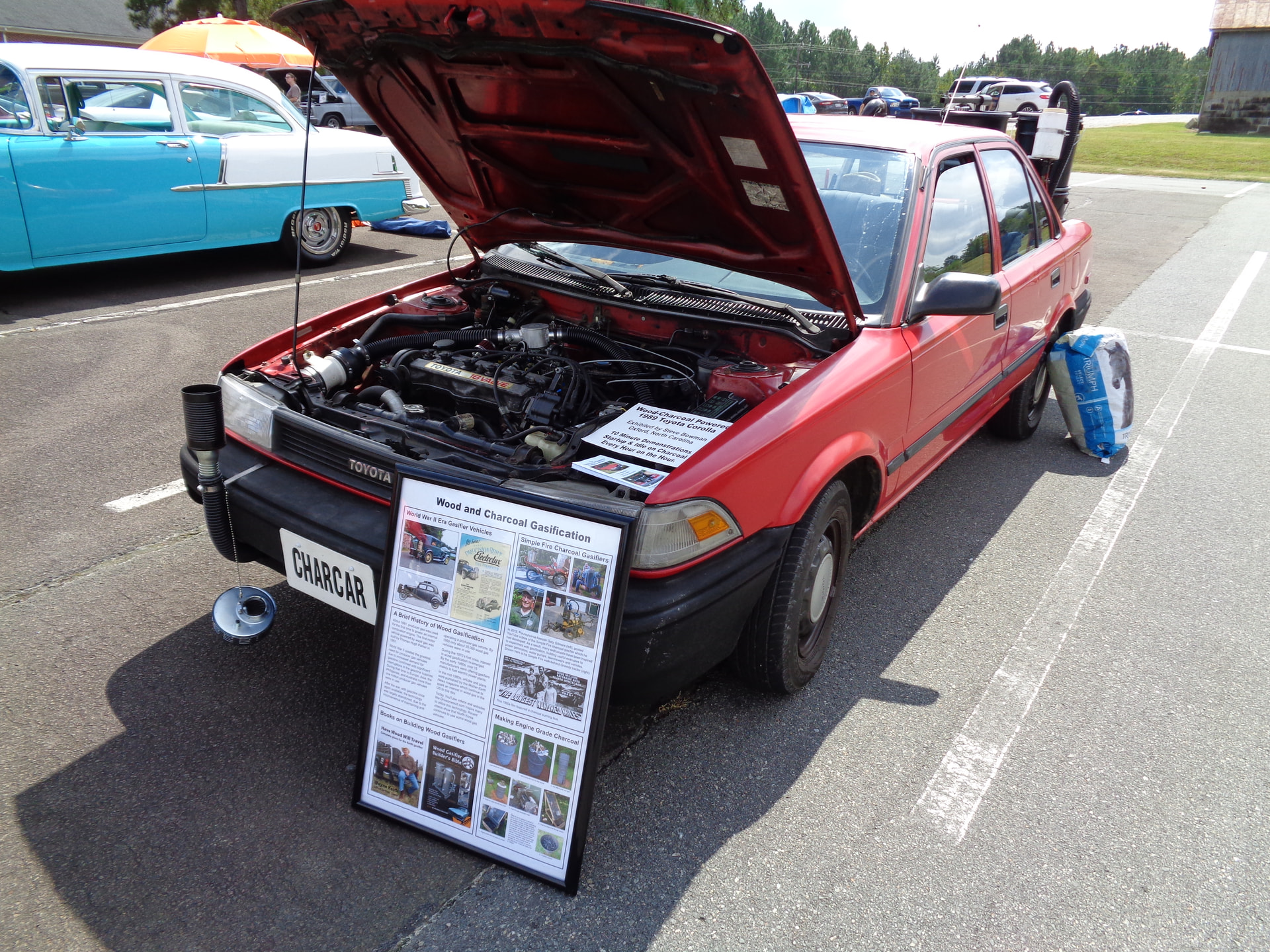

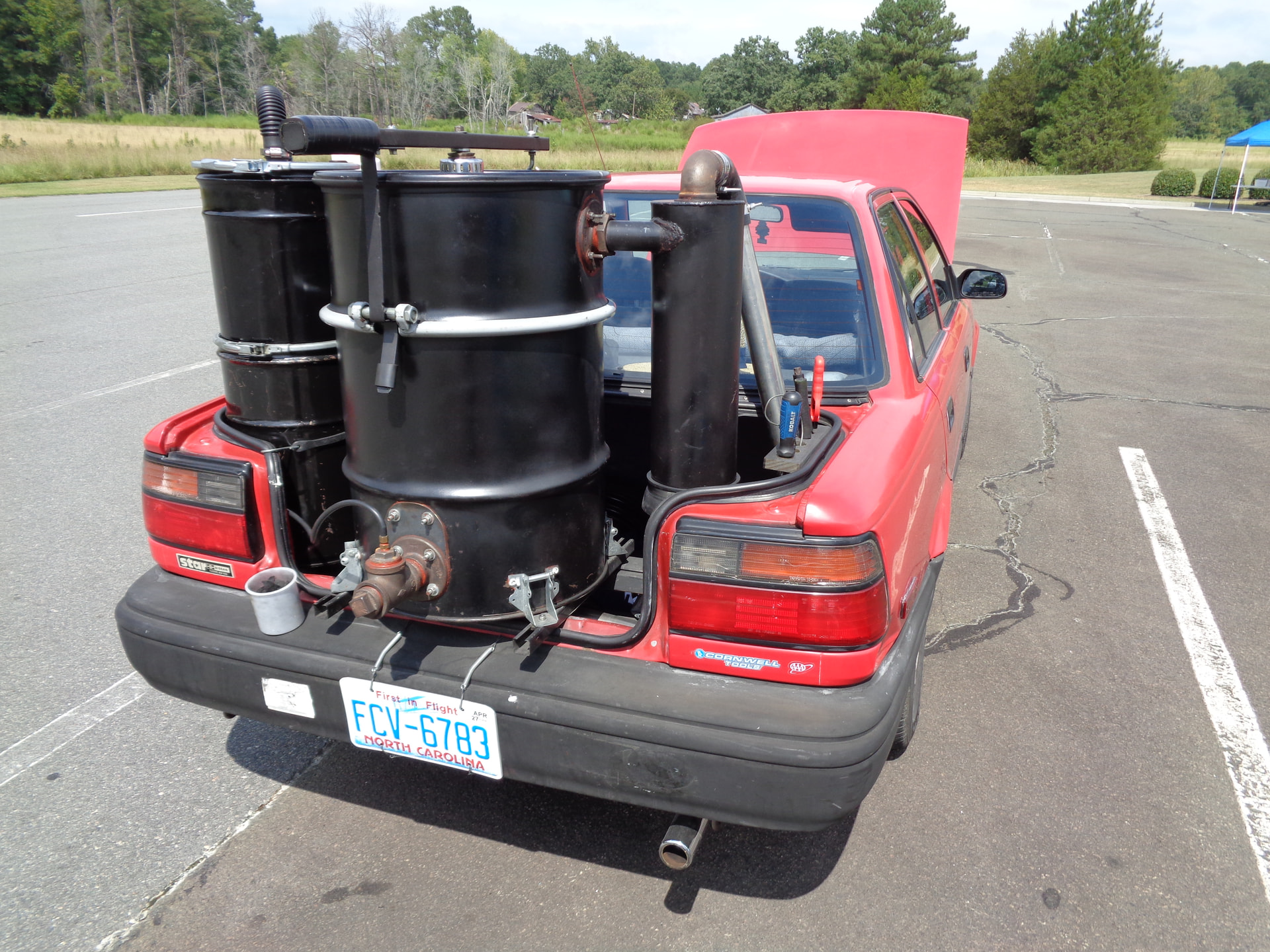

I took the CharCar to a cruise-in early in the summer where I forgot to take photos. Today, I was at the Pleasant Grove Baptist Church Car Show, Creedmoor, NC. People were leaving before I remembered to take photos this time. So, here are a couple of my car—very little change from previous photos. I did a start-up demo “every hour on the hour” and had spectators each time, except at the end when I started up to leave. There was a lot of interest, but as usual, no one was interested enough to want to build a gasifier. It was a fun day. It was not a large show–maybe 30-35 cars and trucks.

you have changed to a flute nozzle now, what experience have you with slag buildup around the nozzle holes?
Giorgio,
Thanks for your response. I changed to the flute nozzle in 2018 after only about 5 months with the Simple-Fire “stock” straight stainless pipe nipple nozzle. I got a lot of large and hard clinker or slag build up with the straight nipple. With the “flute” I only have white crumbly slag buildup around the holes and no metal deterioration of the nozzle from the heat. I have been very pleased with the performance of the Leitinger “flute” nozzle. It was really a quick and easy solution to the heat related nozzle deterioration problem in updraft charcoal gasifiers with side entry nozzles. I drive the car maybe once a month now and just cleaned the gasifier out last week, two years after the previous cleanout. Everything is still fine inside.
