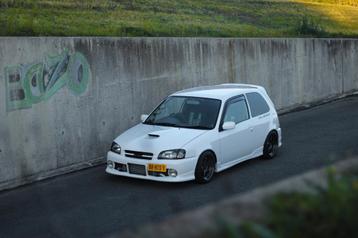

Here is a add I found of a Starlet. 1300 cc and more then 200 hp. Sturdy engines. :grinning:
