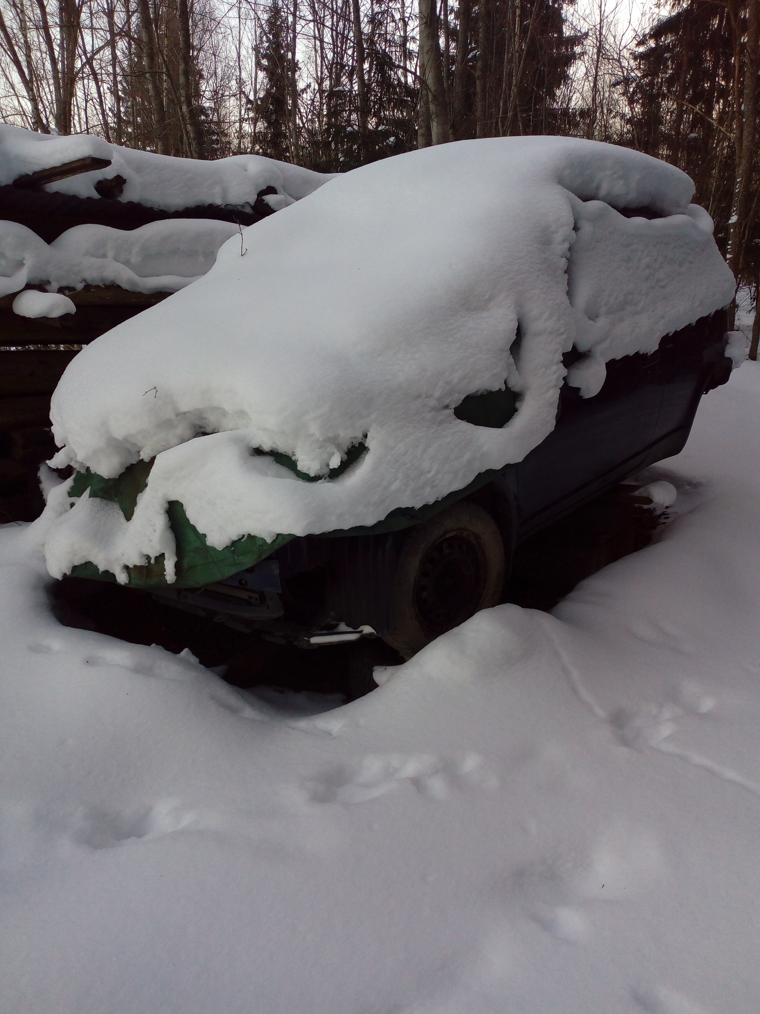

This car i have at home, buy it for the tires , but engine is ok .
Is that realistic that engine converting too charoal gas?

Looks like the snow we just at my place.
Jee , we have a good winter!

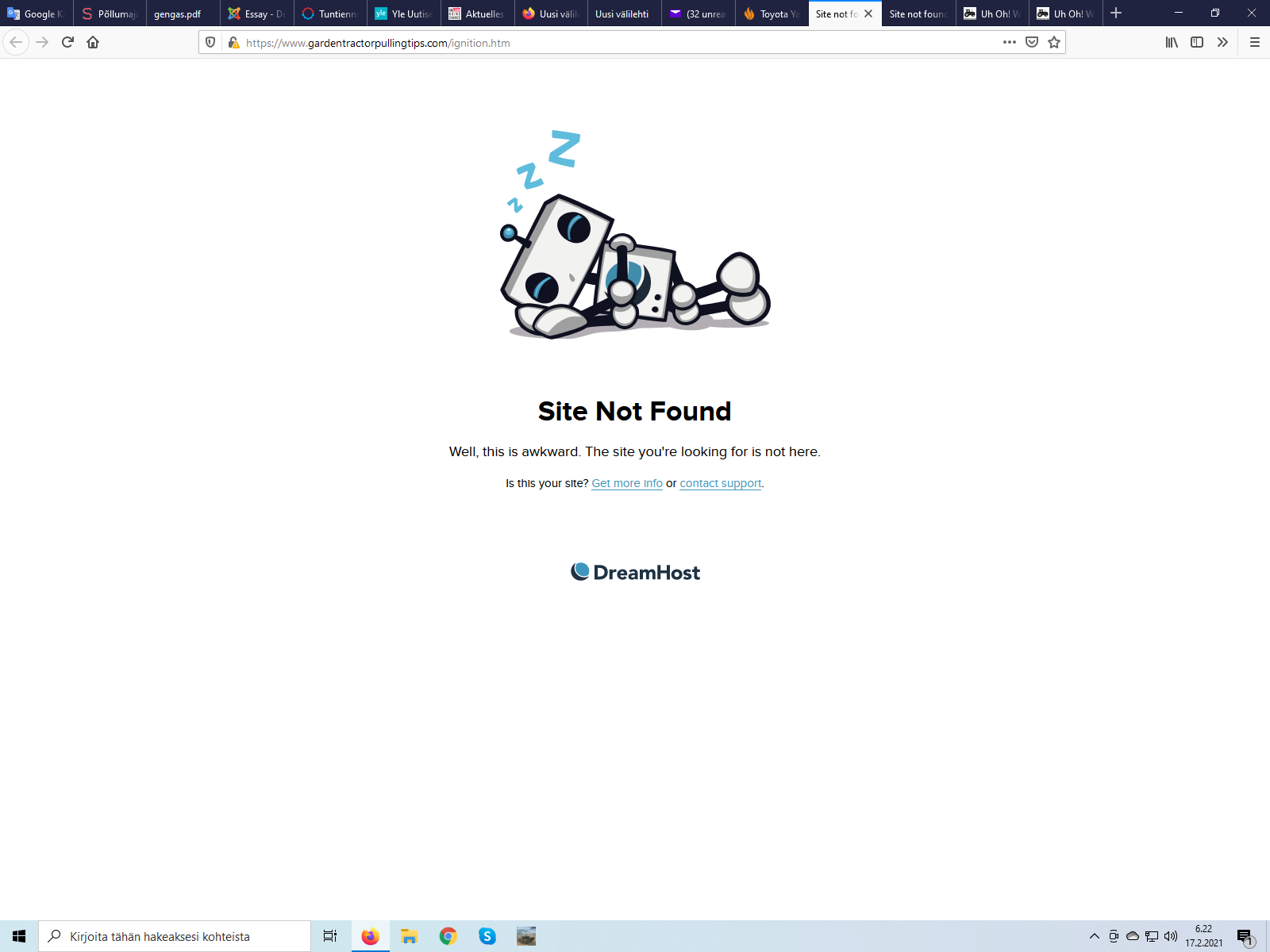

I give you the full Ignition systems link. Not the abbreviated sub-link. The English is very standard English. No colloquial. But very technical wording specific. This may give some translators with limited knowledge difficulty.
https://www.gardentractorpullingtips.com/ignition.htm
The specific section I would direct you to is “100% Maintenance-Free Crank Triggered . . . .”
This is the one showing how to make a single to 12 cylinder ignition system from ABS wheel sensors and 1980’s vehicle ignition amplifier boxes.
Read. Understand this whole article and you will never fear ignition system on any engine ever again. You will impress your friends and family with your abilities.

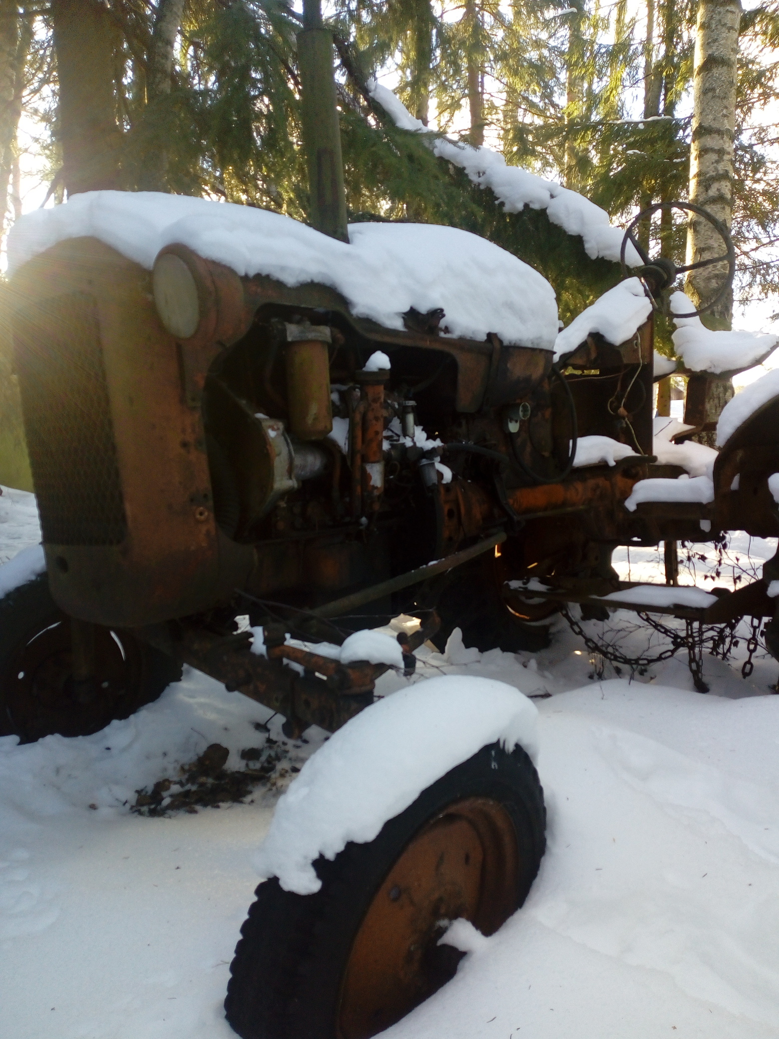

Allis-Chalmers D-270 – D-272 (1954-60)
Diesel
The is me projeckt-tracktor need repear break.
That can be 1 option converting-to-charcoal-gas ore wood-gas

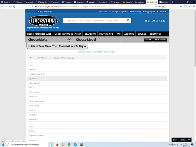

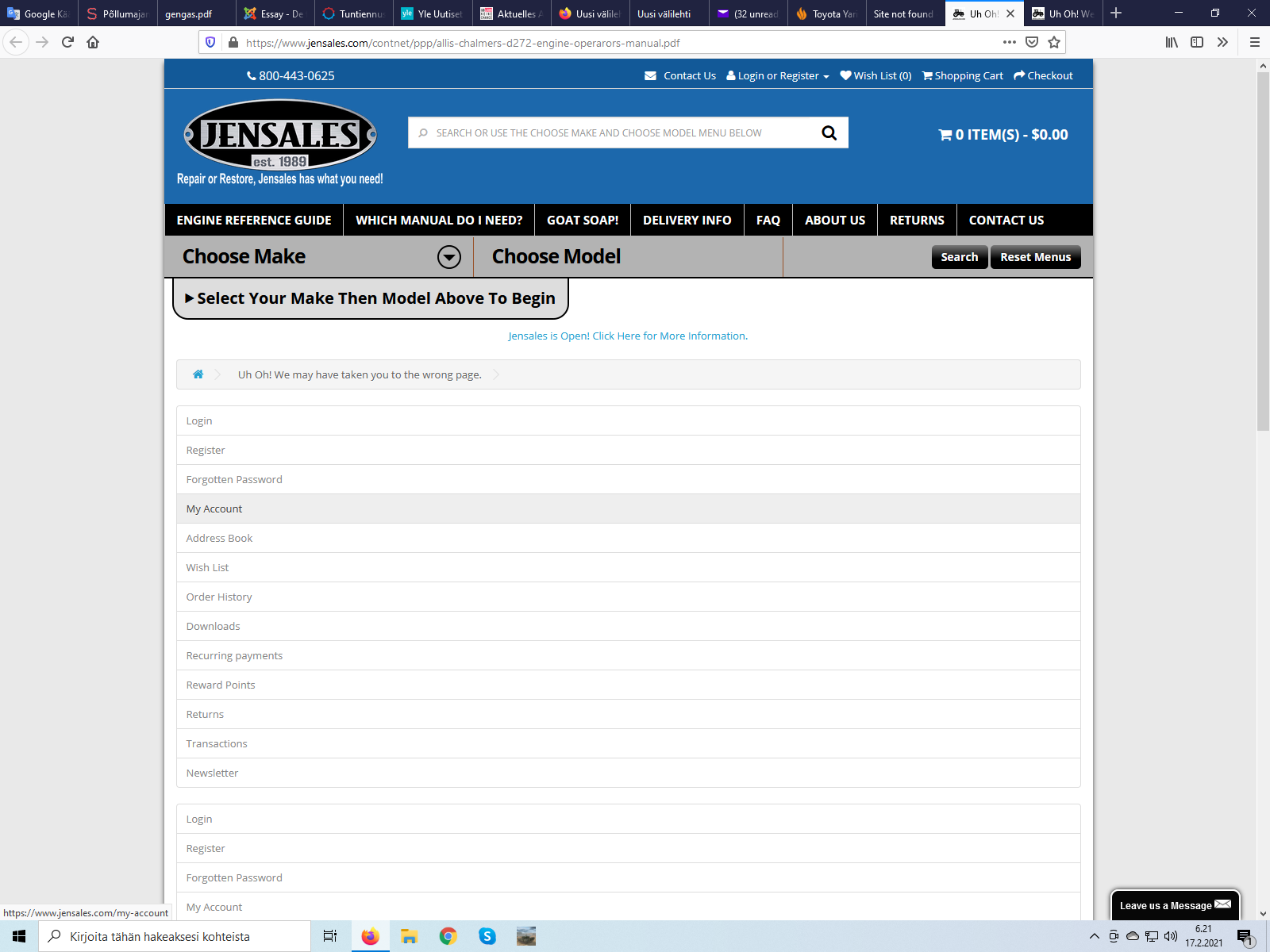

https://www.jensales.com/contnet/ppp/allis-chalmers-d272-engine-operarors-manual.pdf

Yes I know. I can find . . . as a downloadable pdf. But the link I use fails to transfer.
I found it by searching
Allis Chalmers D272 Fuel injection system
I wanted to see the fuel injection pump style.
For the ignition one try, searching as:
Ignition Solutions for Older Small Engines and Garden Tractors
then open the site

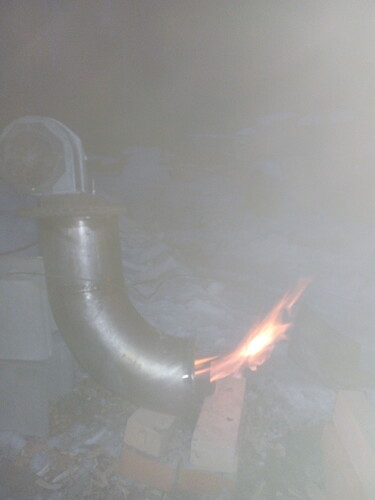

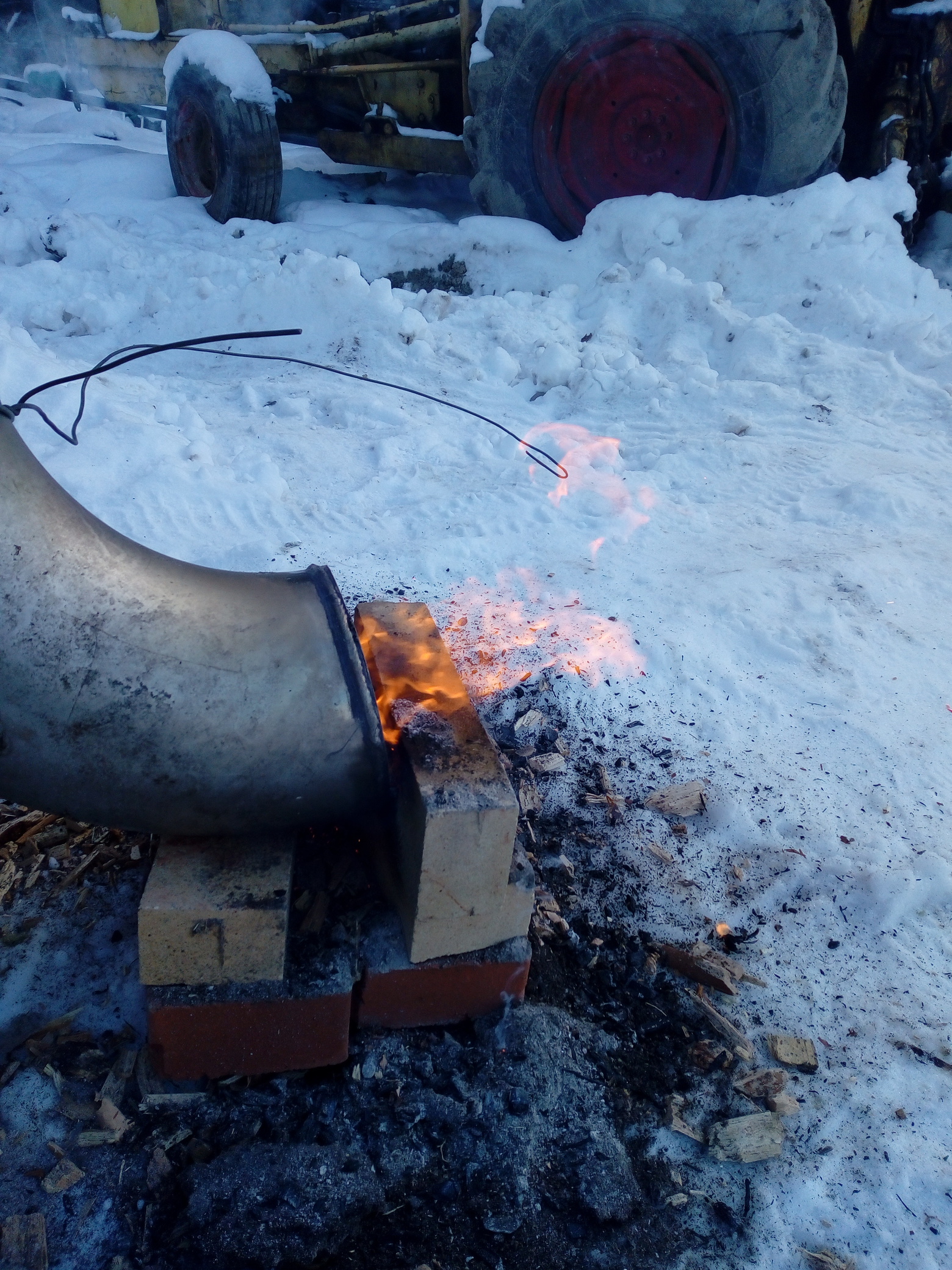

As for Haapios project. Dont give up on electronics just yet! Chances are it will work fine as it is. My Seat was 98 and worked marvelous on woodgas. My Chevy was 2006 and woodgased great. Both had electronics, chevy didnt even have a distributer. Their problems were my fault. Knowing what l know now, after 11 gasifiers built, they wuld be great reliable dayly woodgas drivers.

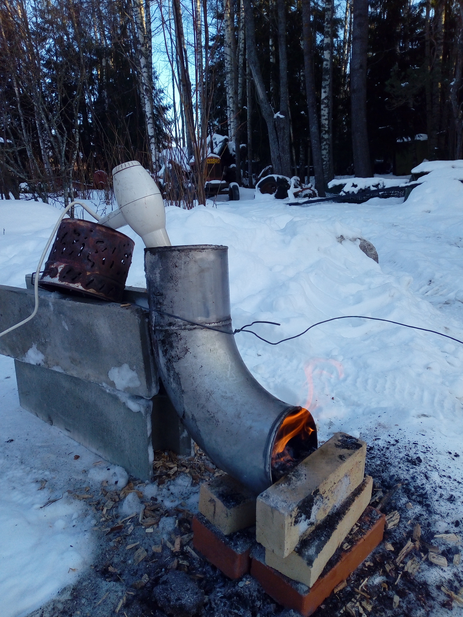

So, Haapio. My advice is just build a gasifier! It will surely power something
yes that’s the way i go.
and like most have a small tracktor.

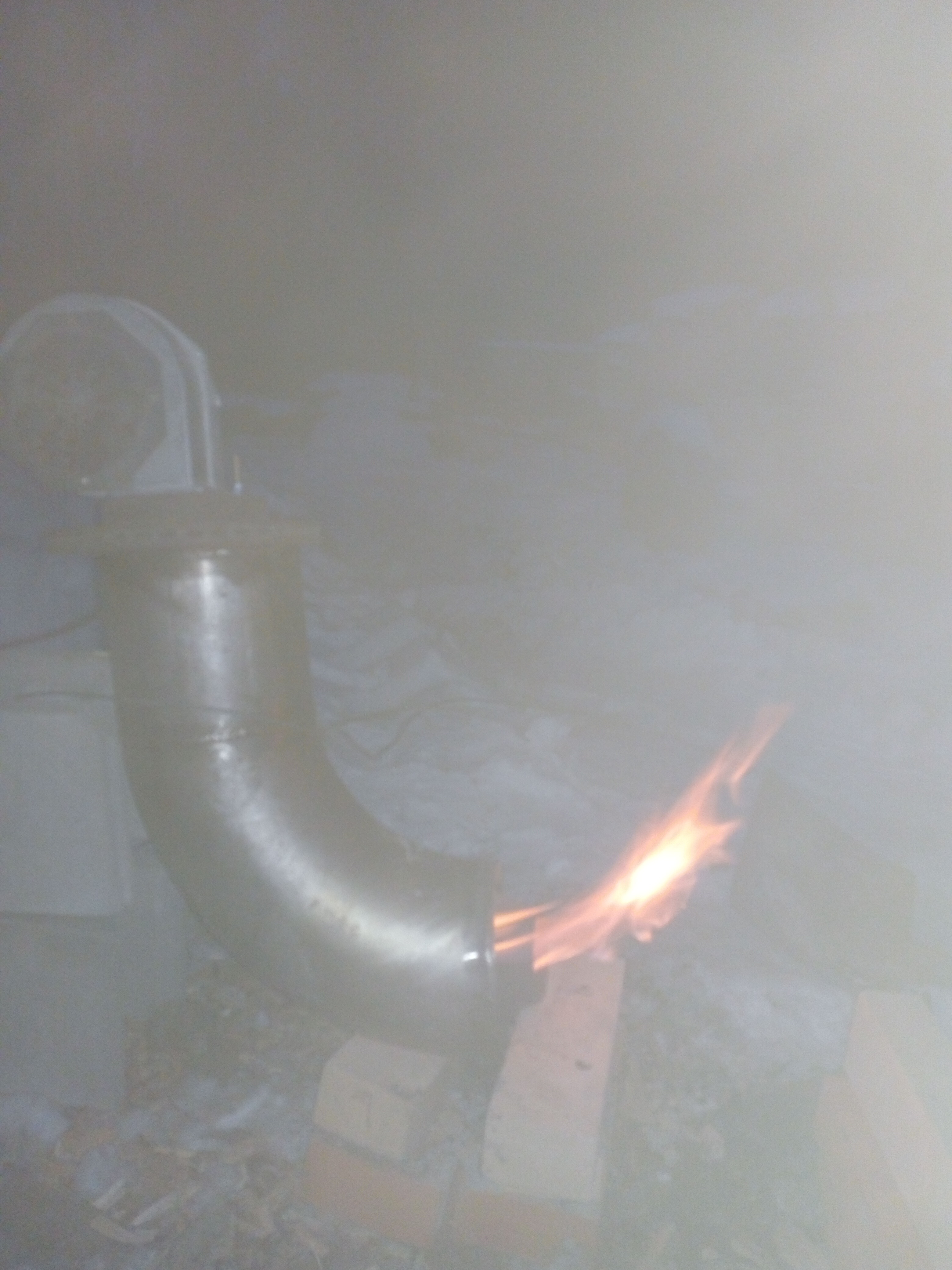

and now need long cold pipe
Yes keep working on your gasifing side of it.

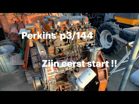

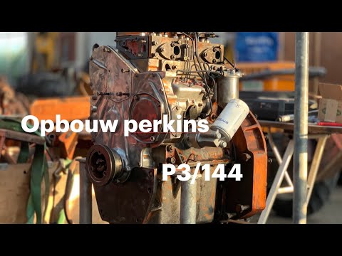

For others: your Perkins 3 cylinder 144 engine injection system.
At he very beginning. At 5:00-5:30. Then ending video first starting up.
Not impossible to spark adapt. Use three hall effect or magnetic trigger sensors (ABS wheel from your Yaris) triggered off of the front injector pump drive gear.
Amplify/trigger through three individual auto ignition boxes. Spark plugs down through the injector holes. Each with it’s own coil-over-spark plug from your Yaris.
Need three machined inserts for the injector holes spark plug adapting. Straight lathe work. Using aluminum or cast steel.
