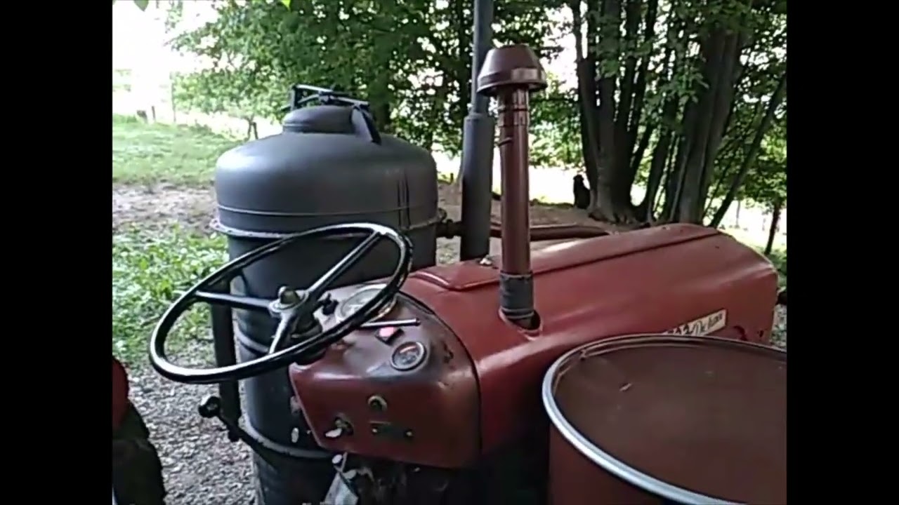

The lower nozzle is built-in, I added a basket to keep the charcoal near the nozzle. I did a test, the power is more than excellent, if you suspect that the proportion of diesel fuel is high, look at this … the fuel is so muted that the engine stops without wood gas.

Tone,
Would you say that you have more power when you are using woodgas than diesel fuel? I have thought this might be possible.
Greetings Rindert, this slope, which I drive in the video on wood gas in fifth gear and easily overcomes it, only on diesel fuel also overcomes it, at somewhere the same speed. The power is actually similar, but I have to say that such gas starts to form when the gasifier heats up and inside some more wood over the burning charcoal, when I tried only charcoal, the power is significantly less. The results are interesting, almost unbelievable, I can’t explain them, obviously caused by high compression and intense ignition with diesel fuel combustion into detonation, where all combustible substances burn at high temperature. A compression ratio of 1:16 is obviously already the upper limit for wood gas operation.
Just one more piece of information, I took measurements on my diesel generator on wood gas and I can say that the diesel engine at 2500 rpm develops somewhere 1 kW of power per 100 cc of working volume. The IMT 533 has a 2300 cc engine, which would mean 23 kW of power, or 31 hp, and diesel fuel is expected to produce 26 kW or 35 hp at 2000 rpm (factory data).
