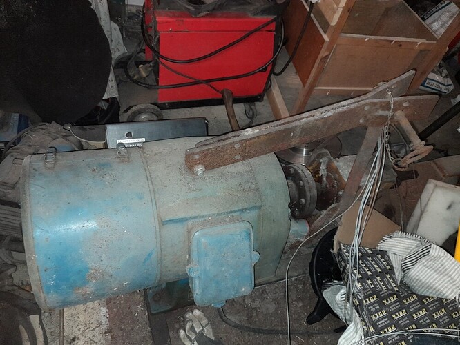

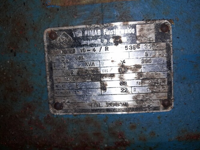

One more thing I came up with, I have a small electric unit of 15KVA, how much hp, is needed to run it?
Zetorn fixes it, but it is quite large.
