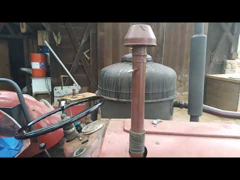

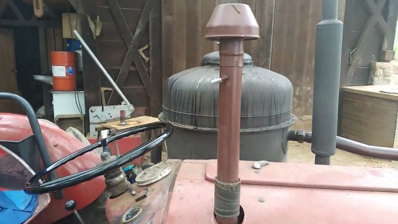

Hello Edy, thank you for the kind words. I only made a few short runs on 100% wood gas, so I can’t give an “official” report yet. I can say the following that it works very smoothly, the power is a little worse than with hybrid operation with diesel fuel, I also have to play around with the settings of the working revolutions and the power regulation, this works perfectly for me when starting with diesel fuel. I also intend to make an automatic gas mixer that will maintain the mixing ratio, since in hybrid operation this changes according to the required power.
