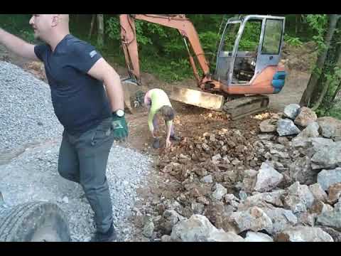

My dear wife and son-in-law Jan helped me in the quarry…

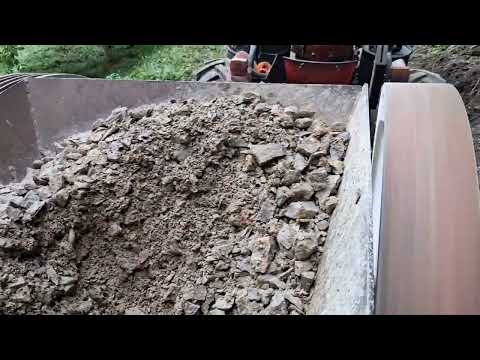

Picture from this afternoon, about 5 tons of cargo over hilly terrain, removing stones from the plot and driving it to another location. Fergie does a lot of heavy work, all on 100% wood gas.
I don’t miss diesel fuel at all, when after a few minutes of warming up and driving at full load, the gas becomes strong, and the tractor develops power equivalent to diesel fuel.

Here, on this plot, there are about 100 m3 of rocks to be removed, these days I’ve removed about 20 m3 (35 t), I still have a lot of work to do, well, it’s not necessary to do all the work this year…
