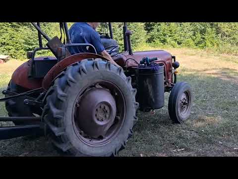

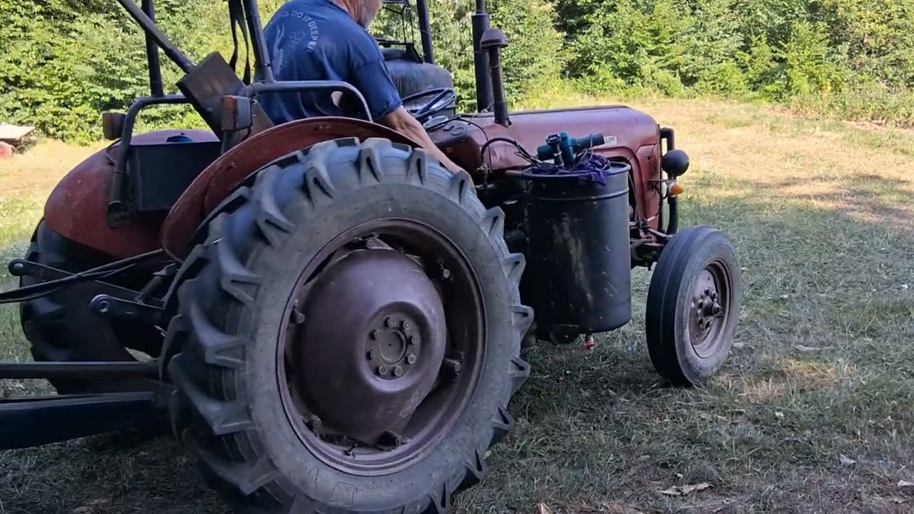

We’ve been talking a lot about the CR of the engines lately, and since it’s easy to change on the Fergi, I did it. I put in some 3mm metal spacers, which will reduce the CR to 1:12.9.
I needed some custom tools for this procedure.
I think recently Mr. Don asked what the inside of a wood gas engine looks like.
Another picture after the test drive, I stopped at my neighbor Brankot’s, who invited me for a beer,…
