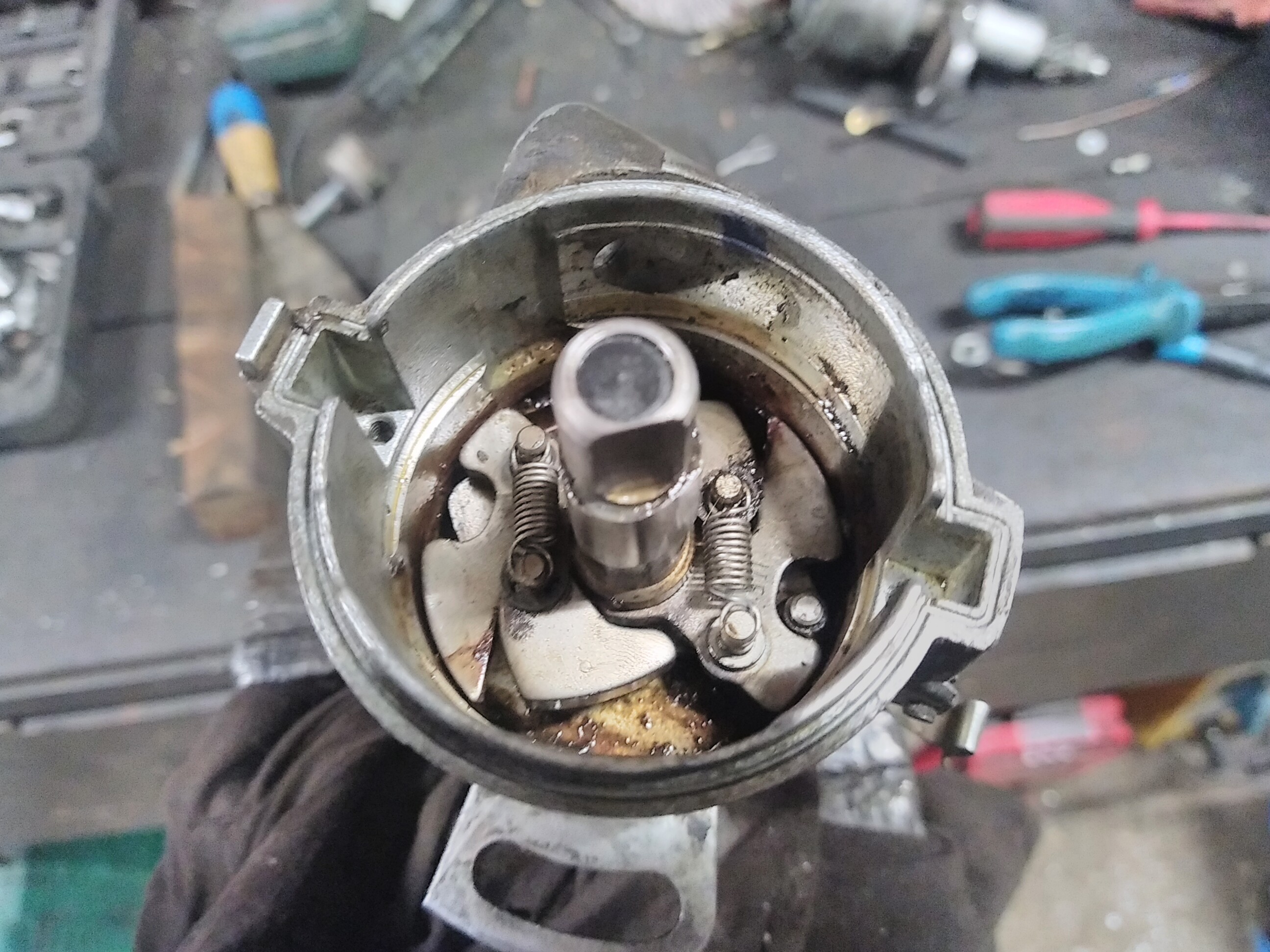

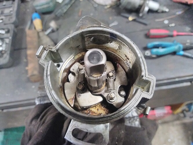

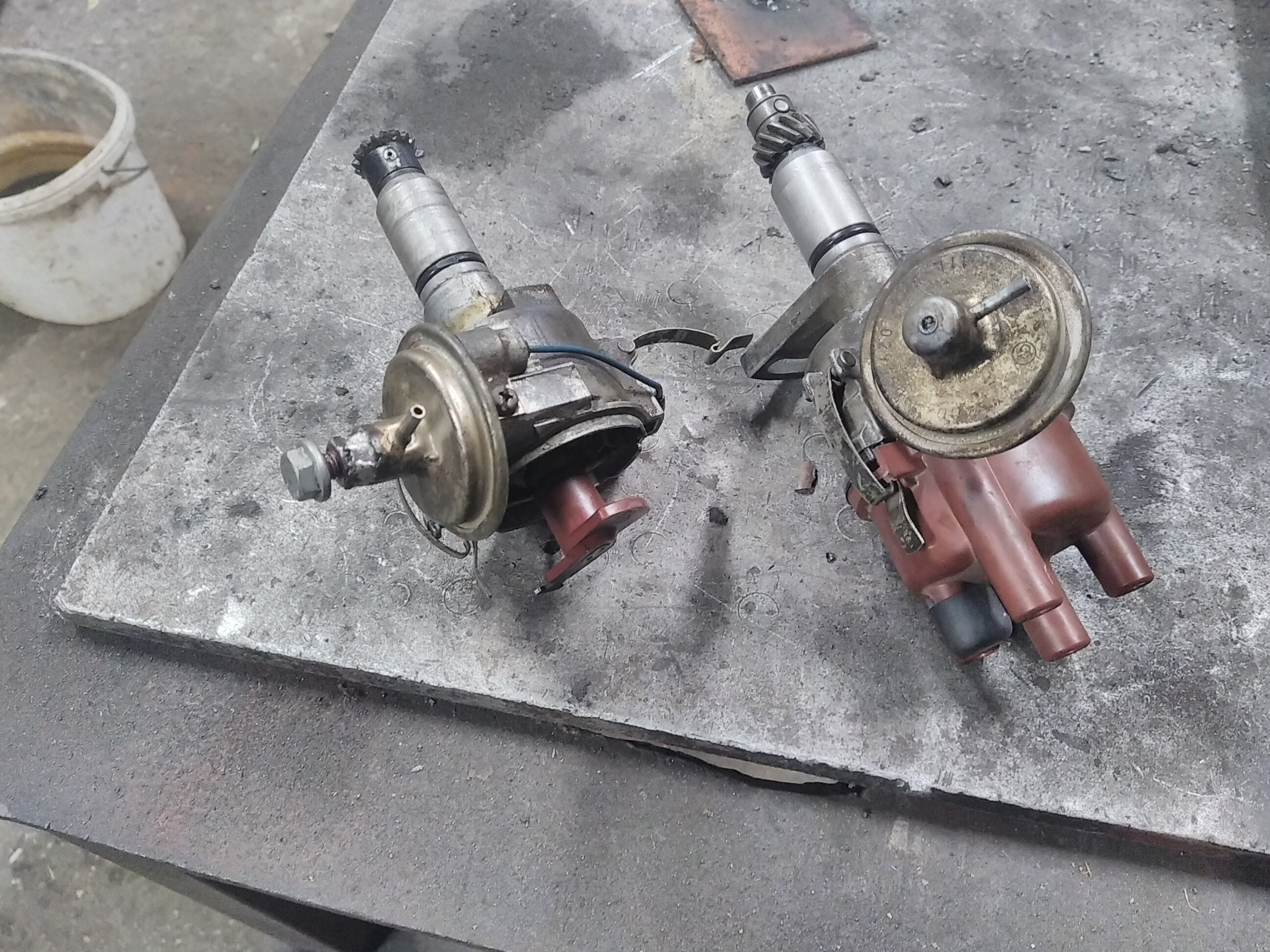

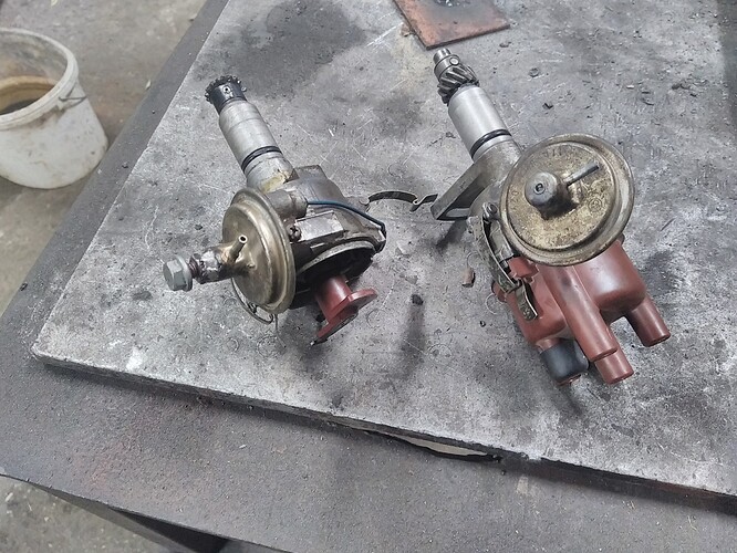

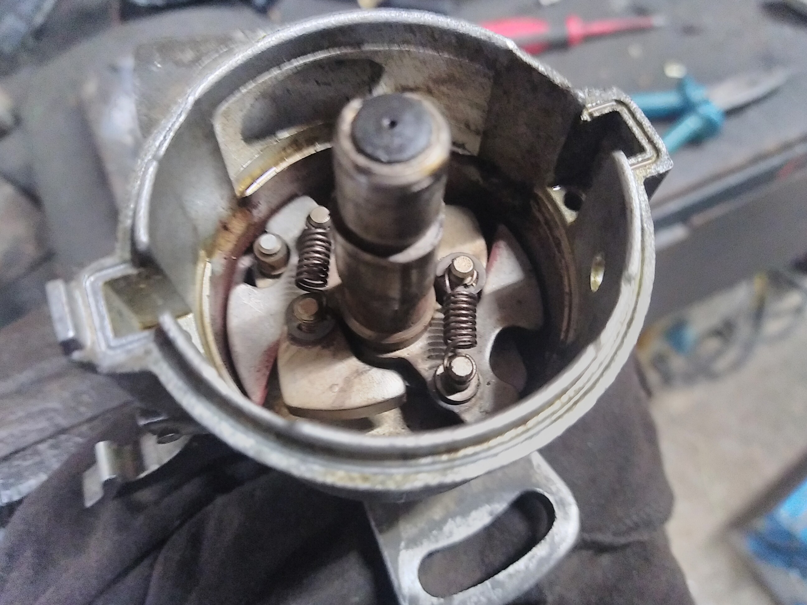

This afternoon I took some time to make changes to the ignition distributor, I replaced the springs on the centrifugal regulator (I tested it with a cordless drill, which reaches 1600 rpm, the max deviation reaches about 1200 rpm) and added a screw for adjusting the vacuum regulator (the original has a small adjusting screw, but it has very little travel and is difficult to access, so it is not possible to make adjustments while driving).
I also did a test drive, the feelings are good, I get more power at higher rpm, it works well even at low rpm

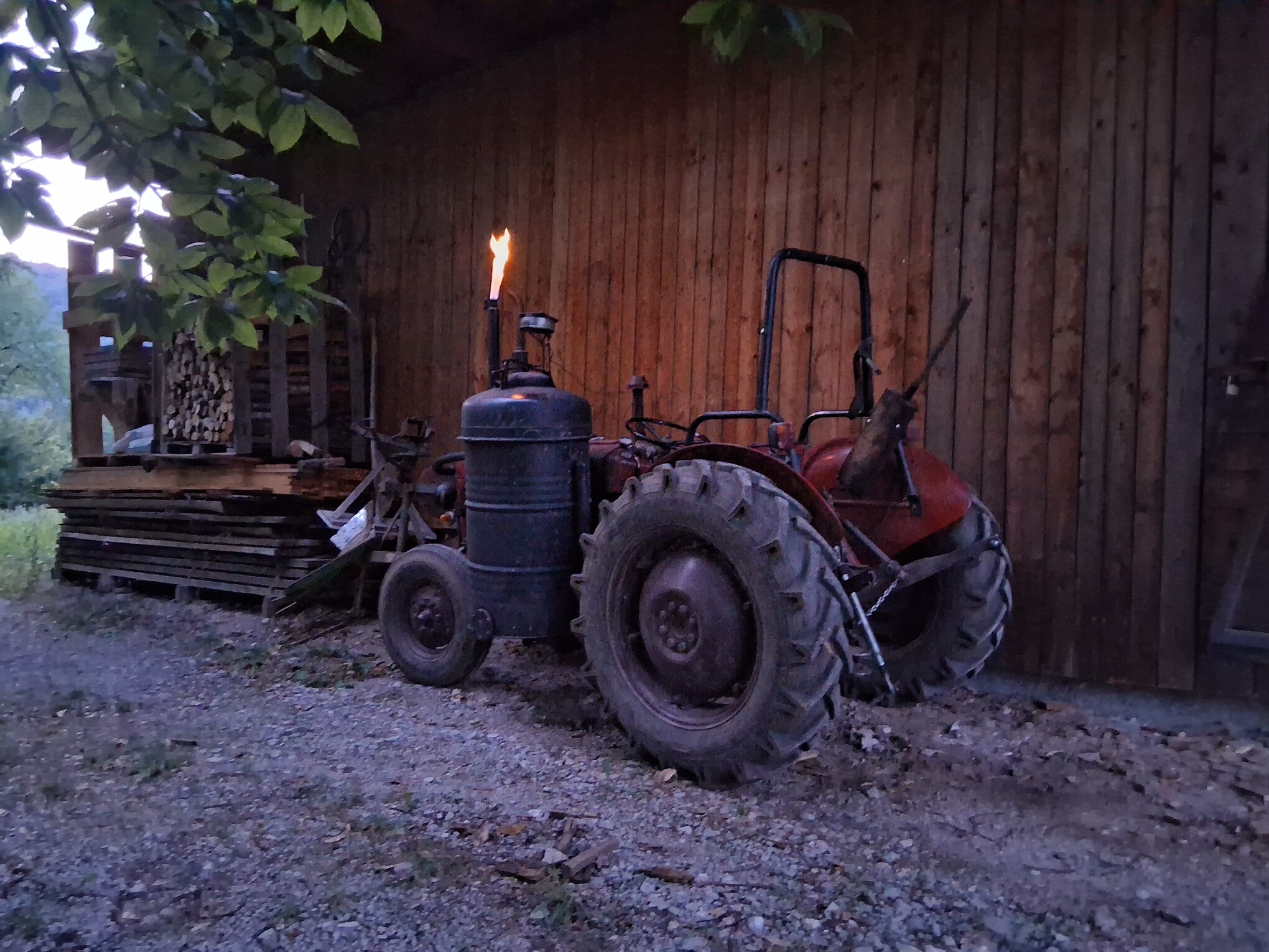

I’ve been very busy lately, no time to ride Fergi, well, today he got some work in the field,… I almost forgot what a pleasure it is to ride on wood gas. After I made the settings on the ignition regulator, it works like a song,… :smiley:

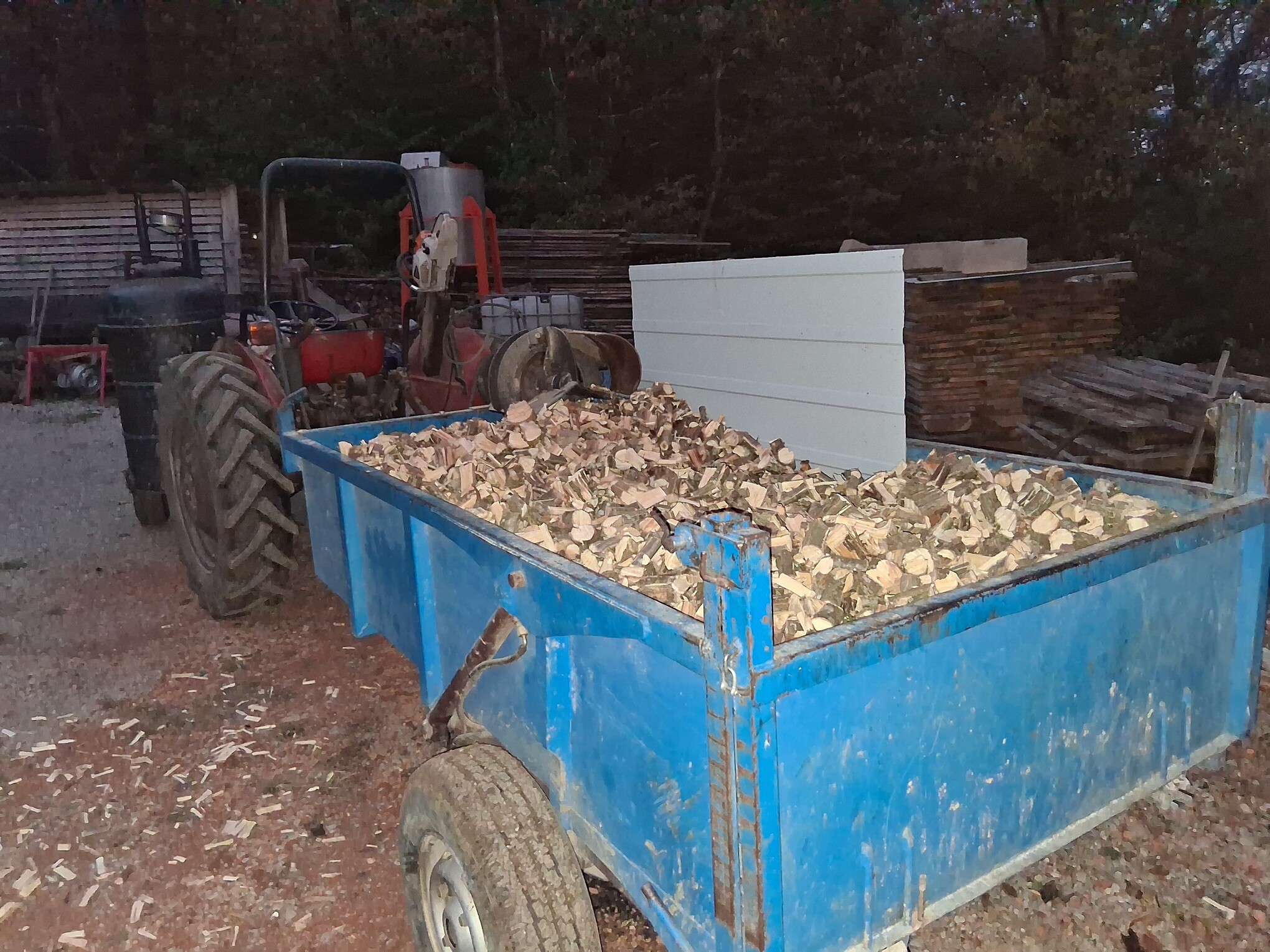

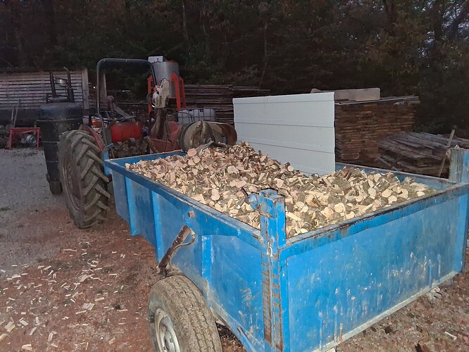

The hard work was done by Fergi today, transporting the excavator to the location where I had deposited the sand, and then 5 heavy loads of sand uphill, approximately 15 m3, I still can’t believe how little wood is needed to do such a difficult job.
Tone, that’s exactly what I’ve been thinking. I remember before woodgas I was dreaming - what if a basket of wood (15-20kg) could take me into town (15-20km). To my surprice I noticed half of it takes me there - and back.
My hoppers sometimes last 1.5h puttering around home in the woods. Only a couple times a year, on longer open road trips, they last sligtly less than an hour and I could wish for more. But I can live with that.
