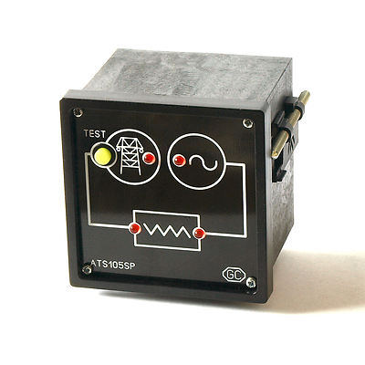

This is a bit overkill but next you want some controls to sense that Utility mains have gone down and get your back ups running and connected as well as monitoring the system and returning you to utility AND shutting your emergency systems down.
Plus its got buttons and lights and screan to tell you things…people like that…
https://datakom.com.tr/dkg-309-canmpu-automatic-mains-failure-unit/65/79/ProductDetails?lang=5

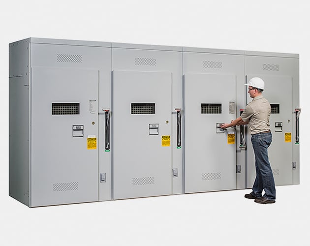

They say "Wally old man " go and put this lexan window in that S&C switch… replace the broken safety glass…
Safety glass? Lexan?
Are you sure plastic will not liquefy and blow out under a major fault.
What if that switch fails you do not need PPE to switch because its metal clad but is it still going to do its job if I use Plexiglas glass?
Now I am the stupid trouble maker for refusing to do this without explicit proof from S&C this is OK to do?
How many other people just randomly do that?
How many people are just doing what they are told around here and random substituting parts from the cheapest supplier ( our global procurement program to save money )
I have one foot stuck in the past, I do not like to wear the heavy suit so I don’t but I get mad about using parts that would require me to where a flash suit because the super sized power system and dubious parts. ( I never need this before… )
And I have that other foot firmly planted in the the reality of today where you can’t trust things to work right anymore and you need to be afraid they will blow up and set you on fire.
