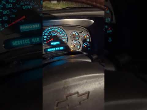

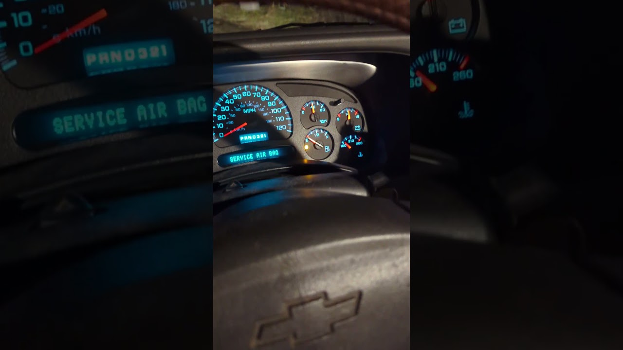

2004 Chevy Suburban 2500 with the 6.0L engine. It’s started this rattle at idle and under load at low RPMs. Idling it’s hit and miss, under load it’s steady. Moves up and down with RPMs. I was worried enough to cancel the trip to town. Is this a rod knock? Exhaust leak seems unlikely. Maybe lifters?
This engine has seen some abuse, uses a bit of oil. Good oil pressure, not overheating. Runs good otherwise and the noise goes away at driving speeds… Or at least I can’t hear it.
See the video. I run it some under torque lock (in gear with brakes on) and some in park. Definitely louder under load. The hit and miss aspect is what throws me off… Doesn’t seem like a rod knock would do that.

Loose harmonic balancer?
Chris it sounds engine external to me.
These have a trait of snapping off one or more engine exhaust manifold bolts with age.
Then a noise that comes and goes with exhaust manifold heat changes and engine torque twisting.
Listen up through the wheel wells. Louder?
Can happen at the same age, on both sides; confusing.
Yes; hard to do; but visually look for any missing bolt heads.

Only had one harmonic balancer to go bad and it sound like the video .
Pull the valve covers and check all the valves are coming back up and seating. That dont sound good, I dont think thats not an exhuast leak. If there is bent valve it will rotate around and cause an intermitent sound like that. Eventually it will bust off and cause more damage.
Incredible difficult to diagnose sounds from a video but my 2 cents (ain’t worth nothing we don’t make Pennie’s anymore)
I can hear at least one if not two exhaust leaks, cheap the rear most manifold bolt they break off constantly on the ls motors the 6.0 more then others
I agree with Steve the knock sounds external, in day light hood open give the throttle a couple good wacks and watch the accessory drive the and watch for belt jump or idler chatter, the ac clutch and idlers were super common replacements. Worth pulling the belt off and repeating the test as well see if noise goes away
It has a lifter tick for sure as almost all ls do
Why I say it’s hard to diagnose from a video because I hear 3-4 separate sounds that indicate issues, non to major.
