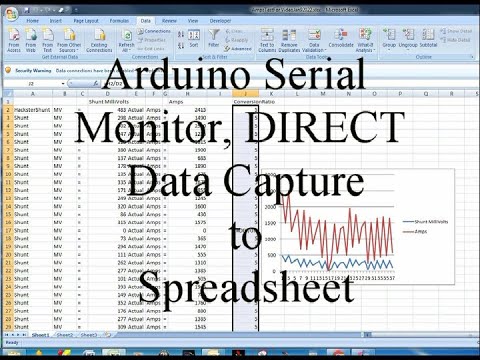

I know there are 3rd party programs out there that assist you in capturing data from the Arduino to put into a spreadsheet for analysis, And I know that you can add an SD card reader to your project. But I wanted an easy way to get my data into a spreadsheet without the hassle of downloading some 3rd party program that might or might not come with some spam or spyware. I didn’t want to go to the trouble or expense of adding in the SD card reader for what might be a one time need to look at the data in graphical format, etc…
So here is my solution:

Yes, you can use the Data/Text to columns approach. But I like using the intermediate step of saving to a notepad file first.
Microsoft seems to move “Text to Columns” around in different versions, but “Data fromText” seems easier to find.
works fine either way.
