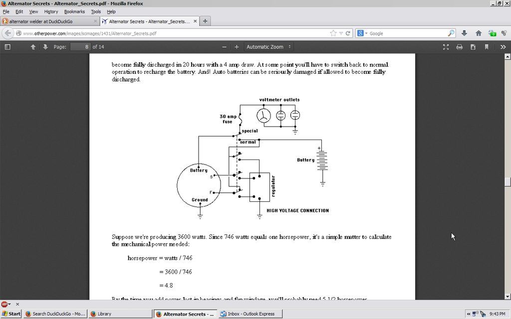

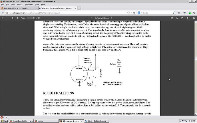

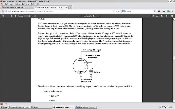

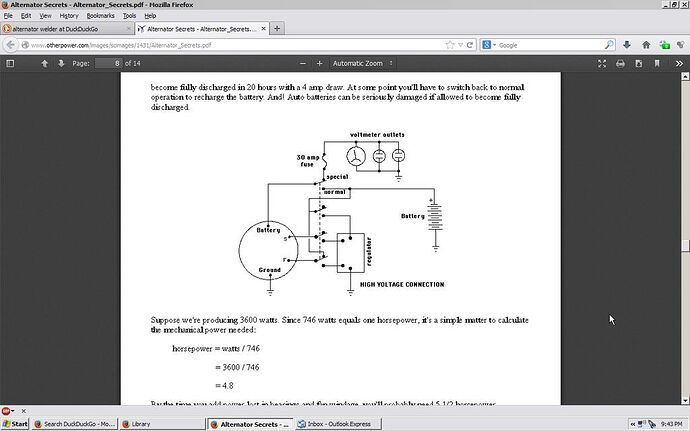

Im not sure if anyone still makes those magic "convertor boxes" like mentioned in the link above. They werent actually coverters or power supplys, all that was in that box was a receptacle and a switch. The switch disconnected the voltage regulator, full fielded the alternator field with 12 volts, and switched the alternator output to the receptacle. When the alt. is full fielded, the faster you spin it the more it will put out up to a point. You had to have some sort of throttle control to bring the RPM up for the desired voltage output. The diodes in some alternators won`t stand the increased voltage, once you pass the PIV of the diodes you can destroy them after a while. Depending on which vehicle and alt. you have, you can do this without the magic box with a few switches, receptacle, and some wire. Most late model vehicles have internal regulators, and on alot of newer vehicles the alt. is tied to the computer, more difficult to bypass the regulator. The second link in Byrons post describes how to add an alternator and wire it up as a welder. You could add a receptacle to that by tying it to alt. output and ground and also have a welder. All of this has to be switched to isolate the increased output from the vehicle electrical system. If all you want is onboard 110-120 volt power, the switching inverters (12v dc to 110ac) are fairly cheap now, i paid a little over $100 for a 1500 watter, it is extremely handy and more useful for more things than the 110 volt dc from these alt. conversions.
You can`t use simple transformers to step 12v up to 120v on dc current, no transformer action on dc. The alt. trick mentioned is the simplest way to do that. Heres a couple of pics of a basic externally regulated alt. , and of what the magic box does.

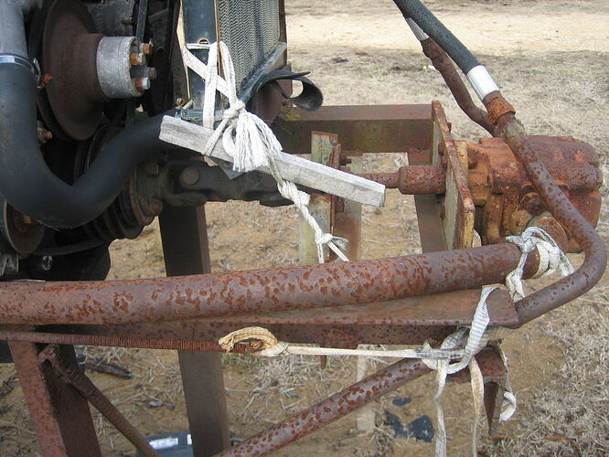

Gentlemen, is the any way to mount a hydraulic pump directly to the engine up front (not belt driven) like on my tractors. Then you could drive a pto and a number of other items with it.

I power my saw mill with a 4 cylinder Mercedes motor that also has a hydraulic pump mounted to the front. It’s not much on looks but I have been using it for 8 years.
If you were doing a lot of drive I think you would want some way to disconnect because it will cause a small power drain.
Picture below.

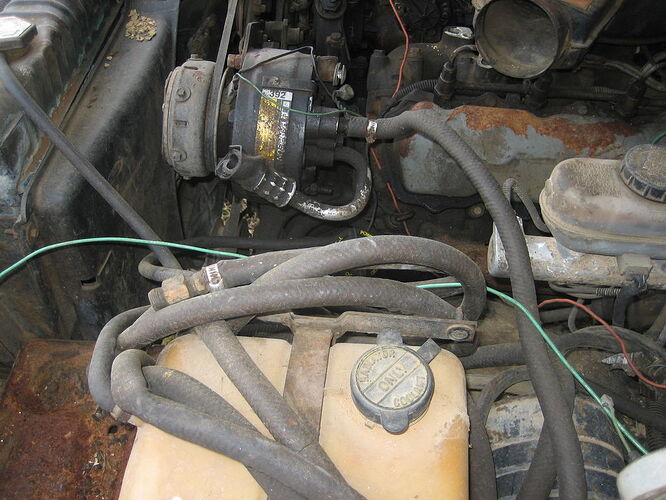

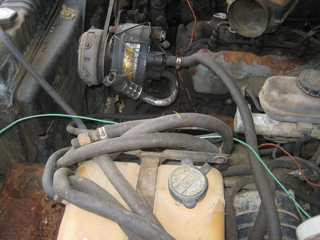

Also in the past I have always used the AC compressor on my work trucks for on board air. (I haven’t modified the V-10 yet)
