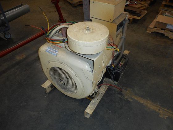

A Kohler R series generator is coming up for auction that has the above engine. Just how bad are flat heads with wood/char gas? I remember hearing a small flat head running on wood gas at Argos, had a nice sound. This one is 30 plus HP and set up for NG. If the price is right i’ll get it anyhow, love old iron. It’s a Wisconsin engine.

Here’s the auction pic:
