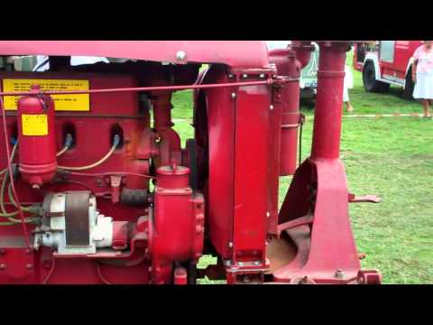

The Farmall F-30 is pretty close. Look at about 2.03 in this video and they have a good shot of the rear and you see shoulders on the rear axle. Farmall also shipped with steel wheels similar to those which I think are actually duals.

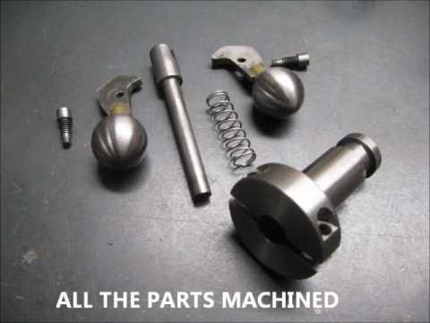

I could adapt one but the itch to build one is setting in. The $50 electronic ones are just a Chinese controller, no servo or sensor. But I’d rather do my programming with a lathe and welder.
Air might be an option but the ball thing would be the checkers.

I’m still in the flyball camp. :slight_smile:
The fly ball just looks too cool. They are one of the reasons I always wanted a steam engine just to actually be able to say look at this cool old mechanical system someone came up with.

Back in the day when I installed a belt gov on a sawmill engine I tried to use a push pull cable and I learned that good linkage was a good idea so now I’m thinking to combine the governor into the carburetor. Course now a longer fuel/mixture path might become a problem. I have a few junk Detroit governors to play with but I should check out the Farmall design because that is a rotate motion where the Detroit is a push pull, if I remember correctly.
