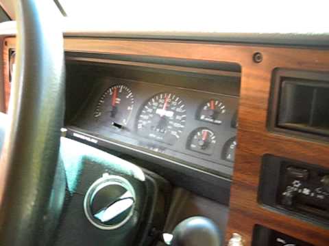

I usually put my window down and pull over on the shoulder and keep rolling and beat on the side of the driver’s door like “get along little doggie” and wave people past me. This also shakes things down. Most folks around here know what I’m doing including the sheriff deputies and state patrol guys / gals. I sometimes refuse to use the liquid. The hills are usually a mile long or so. I’m not sure of the grade but I’d guess around 6%. I will check one later. I did have a bad experience in Grant County. I was driving on the shoulder and they had been grading it and they left a huge pile of gravel on it over the crest of the hill and I could not stop or avoid it so my 91 olds flew over it. Didn’t need a grate shaker on that trip. This latest unit of mine starts up pretty quick and the truck is running on it in a few hundred feet typically and sometimes will start on it but even in 5 or 7 miles it is not accumulating any real condensate. I haven’t driven it much further yet with the new cooler so won’t really know till I do the Indiana trip. When I had the dodge intercooler on it, it made a pile of condensate on any drive but the intercooler plugged up with soot in around 200 miles. It has a pretty standard imbert type hearth and the upper part is insulated with ash and the lower part has a collar with no circulation and then the gas runs through an exchanger to preheat the air to the nozzles. It is self limiting. I don’t run things balls to the walls like the “boys” down south are doing. Mike
I checked the hill from the bridge below my house to the top of that hill towards Mineral Point and it is around a 4% average grade. It is around 6 tenths of a mile on that one. After that I have a long downhill that I use to stoke things up and then a long flat, but uphill stretch and then the long hill climb up to the airport which usually goes OK, usually 40 to 45 or so there. I have been able to make that first hill at 50 mph a few times if I hit it rolling but it is usually 35 to 45 as I’m starting from scratch here. The hill going into town the other way and the hills through town are steeper but I can’t drive over 25 or 30 that way anyway because of the speed limits. The hills on the roads that follow the fixed section lines west of here are for sure around 6% in many spots. I have my test routes. Coming back from Mineral Point I can usually make the airport at around 45 after a mile upgrade and then after the airport I can get up to 70 or so but have to be careful because the coppers sit in this stretch and then I hit the last hill and it’s a hard call, but usually around 25 or 30 cresting that and then it’s on the brakes at 55 to the bridge and home. You just get used to it and shift gears when you have to. I love to let the engine get down to around 500 rpm so I can hear each cylinder pop or go whoosh. That is one of the nice things about woodgas and high torque truck engines versus car engines … Mike
This was a few minutes in the blue Dakota after starting up on wood. We went up and down and all around. I never noticed anyone tailgating I was too busy holding on for dear life. It was a damn roller coaster ride full out all the time.
