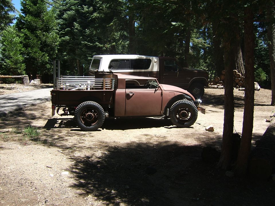

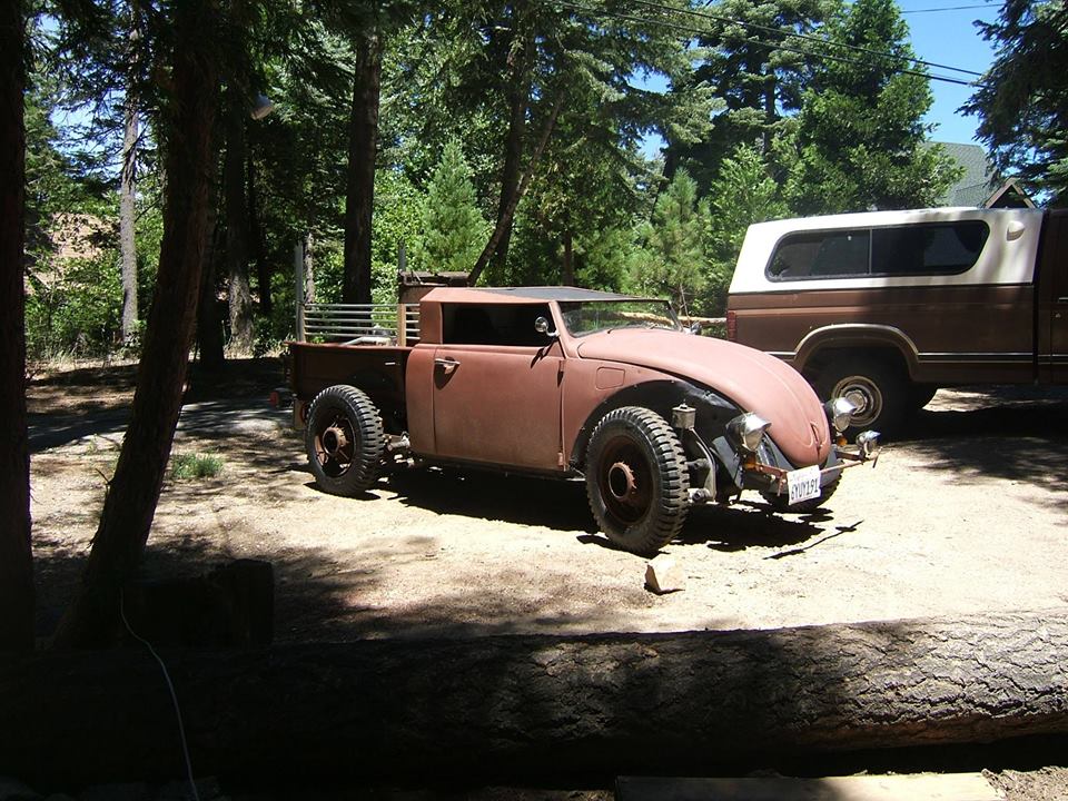

Welcome Xoie; First please introduce your self. Where are you posting from? Looks like you just joined DOW. Then of course we get pretty demanding for pictures and information on your build. It looks like about a 1930âs chasis ( maybe a Chevy) with a VW cab and about a '29 box. Most of all we want to know the engine and the type and specs on the gasifierâI said we are quite demanding. We get excited over new members and builds. TomC
ok this is a 1971 VW beetle. i cut the back off and put a 26 T box to contain the system. i have a 1600 DP with enlarged valves and lowered deck for high compression. the gasifier is a Imbert style. i built this car back in 2013. it has been to a show and it got 1ST place rat rod i have a complete history of the research and development on my you tube channel âxoxoXoieoxoxâ

Welcome Xoie, to the DOW site. Cool Rat Rod. VW FORD seems to be running well condsiterning the high altitude you live at. Hope to see more of your project on the this site. There are a lot of Imbert gasifier builders here. If you have any new innovations that you have incorporated into your build, that would be of big interest.

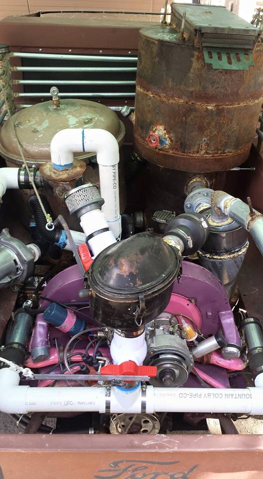

Iâm an imbert builder and ended up building a monorator hopper for mine to deal with the
water. It works great. Iâve posted scads of how I did it stuff in the âSmall Enginesâ section here
under the title âMy first small engine runâ. There are clips that show water collected for timed runs.
Check it out, you might get some new ideas for your next build. If you have any questions feel
free to pick my brain. However, as my friend John quips, thatâll be âcountryâ. Uhh, slim pickins!

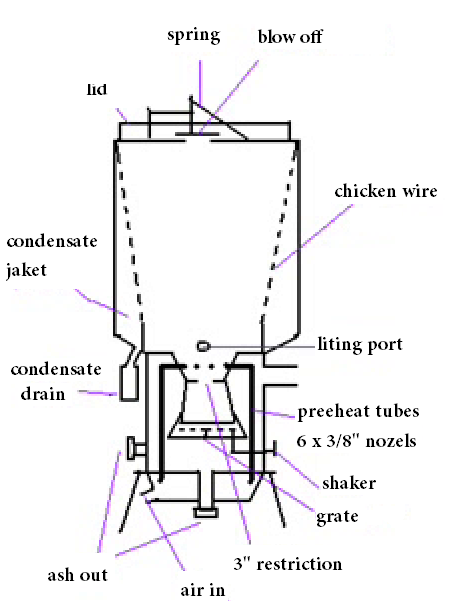

Xole (?) Thank you for joining us. I am an Imbet type builder so am very interested in what you have done. I didnât see the lid to your hopper but I did see you have a separate ââpop offââ valve instead of making the entire lid function as a ââpop offââ. I plan on doing that to mime as I put it back together. In your driving video I was a little confused about your top speed. It seemed you were saying 30 mph was tops, but I thought you also said it would do 60 on the flat. I realize the 30 was going up an incline, I think, so that isnât much of a comparison. Do you have some place where you have a direct comparison of wg to petrol? Thanks again for the posting and vide/slide show. TomC

the lid is the top of a ammo can with cross bars to hold it down =)
