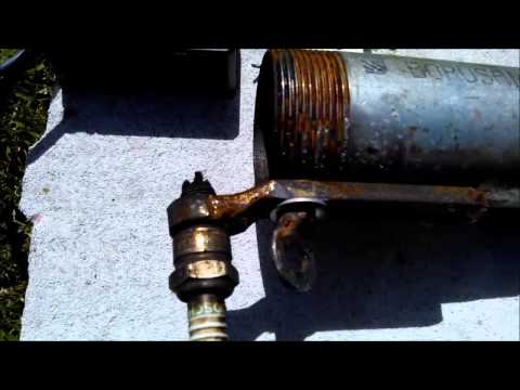

This was taken right after we first had a flammable gas, by the end of the night we had a white/pink flare and was consistent all night. One requirement from our customer was we had to have an auto ignitor for the flare tube. I tried a spark system that ran off an electronic relay for strobe flashers, but I could not get enough energy of it. So we then tried a glow plug of a 2002 Volkswagen Beetle. This does the trick!! So later I will set up a timer relay to turn this off and on while the blower is on.

Yeah that thing looks like a liability. lol the glow plug is just one more step closer to an auto ignitor for the gasifier too. The automated controlled air system on the units is part of a much broader plan. Most other valves we would need for a self running system will be simply open or shut. So we can easily build valving operated with air cylinders and will be very cost effective. So for the new air system is working to perfection and really neat and compact set on this one. So later on we will simply open an intake air valve and the blower valve and then fire up the blower and glow plug and we should get a self firing system. Cant wait for this!!! Unfortunately I did not have time to try and repurpose the AC compressor for the pump. The Harbor Freight pumps work quite and well if it aint broke dont fix it. Im just not going to order the AC pumps with the engines in the future and this should save us a little in the build cost.
