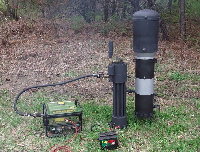

My little M-1-SGU is what started it all and it is what I would consider a micro gaisifier. I run a 2000 watt 2.8 HP gen with it. It will run a 1300 watt load for 5 hrs. I run pellets in its small form and it performs pretty decent. I will be installing a mount plate for a hopper vibrator for it going forward. Here is vid of it running a 4000 gen under 1500 watt load. http://www.youtube.com/watch?v=l-uLwejWSVc&list=UUIj9jrb2pG4mNb_njWMKxPg&index=2&feature=plcp
This unit can be expanded to make it bigger as well. http://www.vulcangasifier.com/M-1-SGU.html

One thing I should mention on the little set up. It is not perfect, it does require constant monitoring. Usually just a bump on the grate will satisfy it. Im hoping the hopper shaker will fix this. Pellets tend to clog things up. So every once in while the char needs to be loosened up. The grate depth on all my units is adjustable. When running pellets I found that the grate really needed ot be choked up so the pellets could be better consumed and when running the little motors on this fuel longer jets were in order. I have ran chips with it and ran into bridging issues. So I have revised this unit to flow better plus the hopper shaker will help.

I like your straight forward and compact design. Nice flare. I am sure there is demand for such simple and therefore probably affordable gasifier units.
Engines also seem to like your gasifier, since they can easily be hand cranked. An engine that can be started with only one or two pulls is the ultimate test for a gasifier. Two questions. What kind of filter medium do you use? How does the gasifier behave on wood chips?

As for filters Ive played around with different filter medias and just did not have much luck. Either the tars got thru any ways or it was too restrictive. Ive built a bulbler/media filter combo that worked OK but the bubbler was to restrictive. So I went back to tuning the gassifier until it made clean gas with out any filters.This took lots of pacients and days of tweaking.
Wood pellets I think is the way to go with the small gassers. Once I was able to get consitant fuel flow going thru the gasser, I could then establish the best possible perameters that the unit would produce good gas. Its not 100% as conditions change all the time in the gasser but it does recover.
I am open to ideas for additional filtration. My question is do you really need to filter the tars or can they be condensed?? To me (and Im still learning here) it seems when the tars come out they are in a gas form just like the moisture. Does the tar just need a lower temp than the moister to be condensed out?
Also I do have a simple cyclone/water trap, That I have just before the ICE that I mix the air fuel in. The idea there is to introduce cold air to further condense the gas and get out any remaining tars and moister. What Im now considering is a finnal filter that will use the activated char that comes out of the gassifier as a finnal filter and have this after that.

You cannot filter tars. They pass every filter, because you can consider them gas or fumes until they condense further downstream. Mostly just after a pressure drop, like behind a throttle valve. Best way is to avoid tars, by a well insulated hearth, right dimensions and a fuel that is consistent in flow. Every gasifier makes some tars, but the trick is to have only those that do not condense very easy.
Wood chips are not an easy fuel in a small gasifier. They tend to bridge, causing clinkers and tars. Not real hollow burns that stops an engine, but short time bridging. Hard to recognize, but if you make tar AND clinkers you have short time bridging.

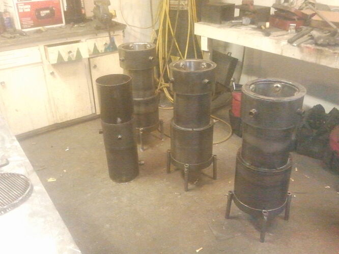

Cranken em out now!!! Three E-1’s and an M-1 with expantion hopper. Need to have em ready to ship by the end of the week.
