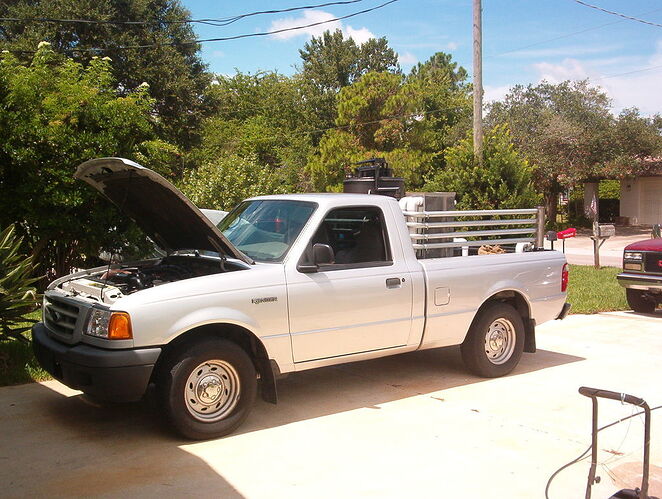

You can see the whole system on my truck below. The pipes and the condensate cans are all designed to get the gas down in temp to condense all the moisture. By the time the gas gets to the engine the gas is dry the pipes are dry. I gasified this truck just to see how wood gas runs on the newer computer systems. The truck itself is not a good candidate for wood gas for several reasons. When we did the packed bed wash down filter with recirculating water all the moisture was gone by the time it got to the engine, but there were other problems that make the water system too much bother to fool with and the results were no better than hay. The gray box with the white pipes coming out the top is the hay filter.

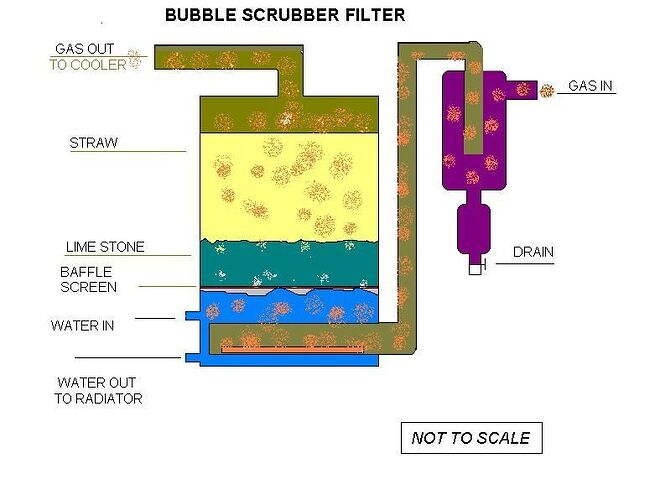

Hi Guys! Sorry, no picture yet but as soon as I can find one I’ll attach it. Lye (sodium hydroxide) is highly corrosive and aggressively eats aluminum and a lot of other things. As such concern is appropriate as to whether small amounts over time would make it into the engine and damage it. You would probably have to have a lye scrubber on the output to get rid of the traces of it. Lime (Calcium hydroxide) is a lot less agressive but still could be detrimental if traces of it continuously got into the engine.
I was wondering if any of you have ever measured the pH of the water condensate from the combustion process? In olden times lye was made by leaching it from wood ash. Hence the question. If the pH is significntly above 7.0 (7.0 is neutral, higher is alkaline) it might be able to be neutralized with a weak acid.
P.S. I did find a picture.
Thanks Guys. This is what I needed. It seems that dealing with frost in the cooler and constant water treatment under changing load conditions, that this is not practical for mobile use. It might work with a generator in a more stable environment. I will look into that.
