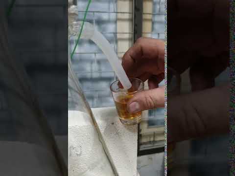

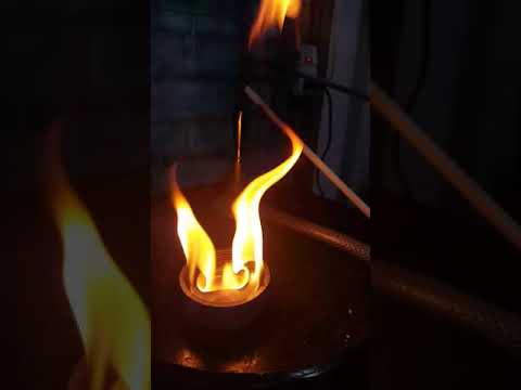

You might consider this to mix with the water… or use it straight ( hint: its not dynofuel and it is made with a charcoal gasifier AND: it is a solution for pollution )
Oh,… and if i can do, then most certain you can…

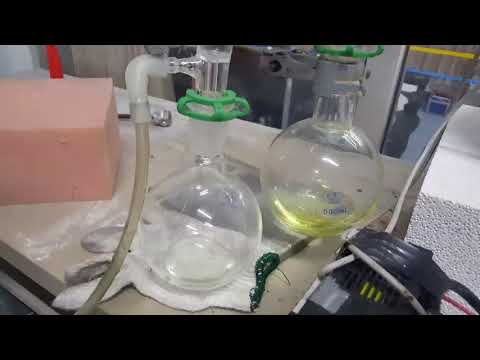

Methanol distilled from pyroligneous acid?
residu’s from charcoal/plastic waste gasifier mixed with tar, condensate’s and then distilled…
Is that a destructive distillation process Koen? Any catalysts used?
Hi Garry,
Seen the “low” temperature i use, i prefer to say “just fractional distilation” in the most simple version… To be easy duplicated and put to practical use.
I had both liquids in the freezer, they don’t turn into ice.
