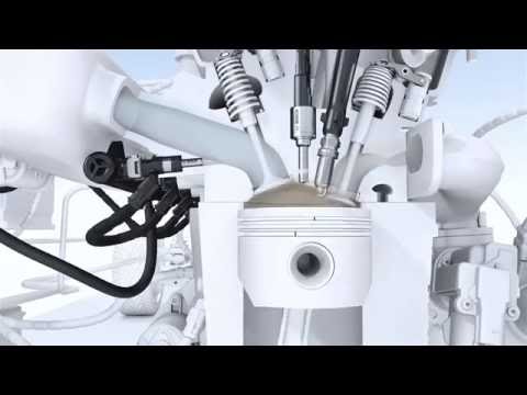

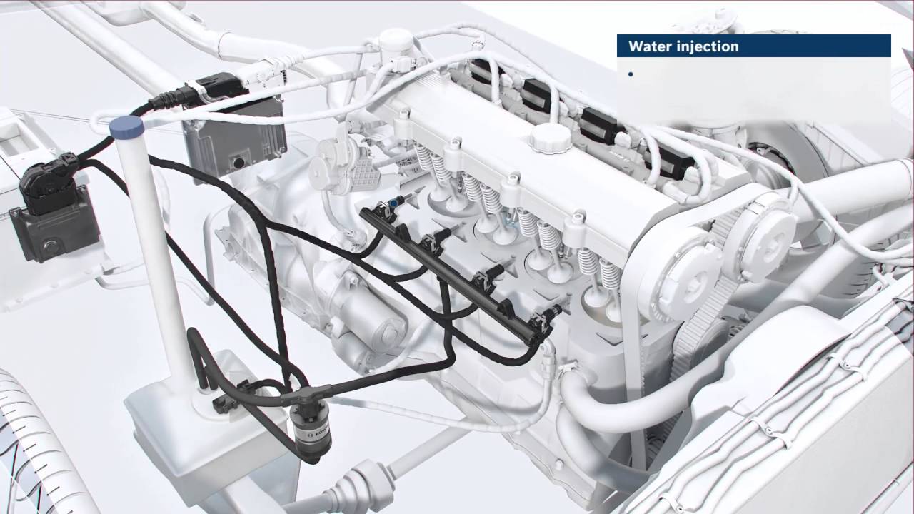

Not saying you are wrong necessarily, but increased water content in the charge air usually causes an increase in power and performance. Why would they want to take water out of the air?
Yes water injection works, key word here “injection”
Mist in the intake does the opposite.

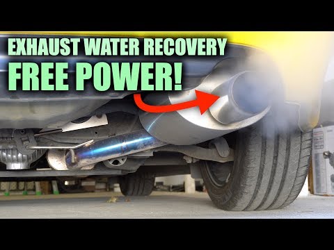

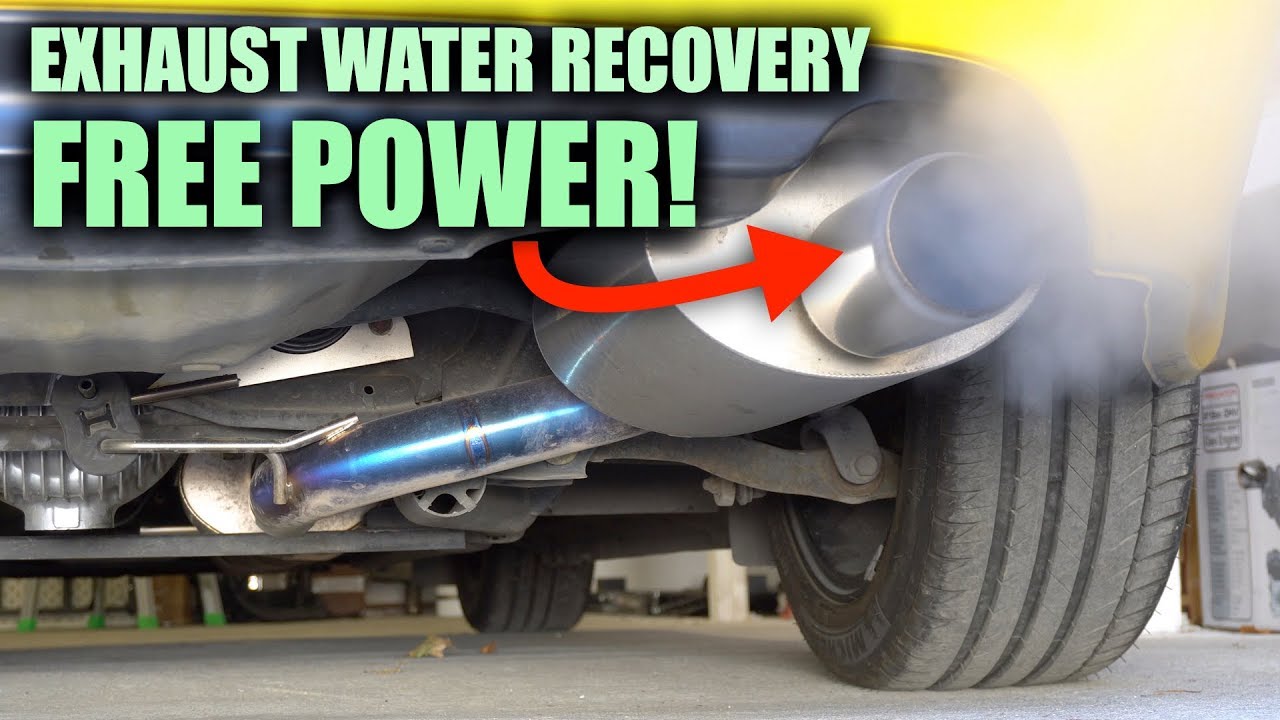

He does a good explanation of water injection, and also touches on the moisture removal in the intake air.
I’m not too sure Matt. A lot of street roders have been doing it for a very long time. Here Pat Goodman has aimed the nozzle straight into the carb. He calls ith injection but you have to actually look at what he is doing. Some of the old WWII fighter planes would do much the same thing
GM had water methanol injection in the 60s on their first turbo car.
It let them use boost with a relatively high compression engine.
But when you ran out of “turbo rocket fluid” you could not run the turbo.
This was the down fall of the system you always had to top up the injection system with more water/methanol.
The idea of getting your water directly from the exhaust is a very interesting one
Did you watch the video. What he is talking about will make sense. The idea is to cram as much oxygen into the engine as efficiently as possible, with a separator plus some cooling, this is basically free. Then when you get into the water system, the water system is direct injected to get those benefits.
He explains why the humidity is a problem.
