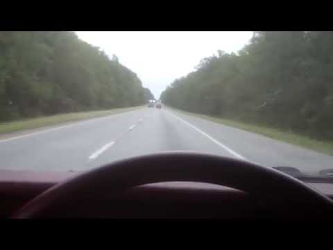

I have been out of pocket a couple of days . Below is a short video going through Tennessee. The traffic was moving pretty fast until the police slowed it down a little just as I stopped videoing .
how much # wood can you carry on the dakota, the freeways are too fast for me.I like the slower free ways back in the 70’s / 55 - 60 mpg embargo top speed

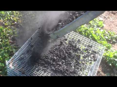

Hi Wayne…I have a question. Was your char and ash needing dumped because it was full and restricting flow, or was it more for demonstration purposes? The reason I’m asking is I usually get way more than that when emptying mine. I have been swamped with work and not able to be on here very often. Hoping to start posting more shortly. Thanks for the pics and video’s you post. Where did you get the big carved bear figures along your drive I saw in your video when you ran the escaping cows back in? Diesel is down to 2.69 per gallon at a convenient store here in Coffeyville, the others are 3.39. I went and got 250 gallon in my drums and portable tank the other night. Gas is 2.09 at the same store.

" Was your char and ash needing dumped because it was full and restricting flow, or was it more for demonstration purposes? "
The truck was showing no signs of needing the ash dumped . I was unpacking the truck from my trip and decided to drain the condensates and dump the ash. The truck had been driven six or seven hundred miles. The char I am showing is from one side ( ammo box ) . The other side had about the same .

Them dakotas amase me the speed they fly at only 2000 rpms on wood gas.
