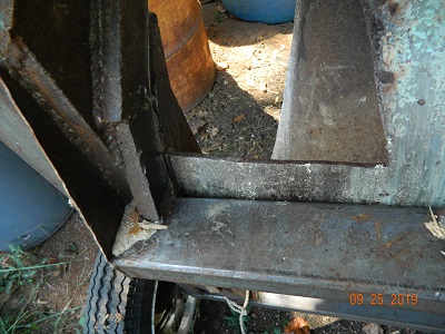

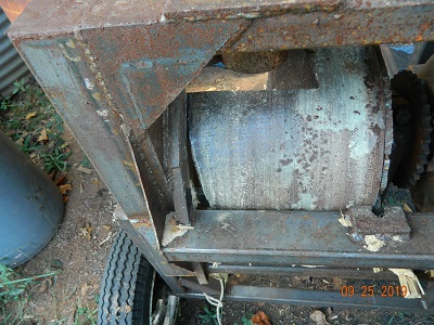

Mine is slicing it, on dryer wood it crushes it pretty good as well.
Thanks jacub that design seems like might be less strain on gear box, are you able too chop 3" green hardwood at same speed as the other type cutting pipe designs.
I can easily cut 3 in green hardwood. I have a very big opening on my blade the biggest I was cutting was 7 3/4" It was a semi hardwood.
I’ve ran 4" dry Oak through mine just to test it out. It handled it without a problem.

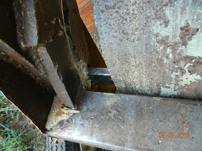

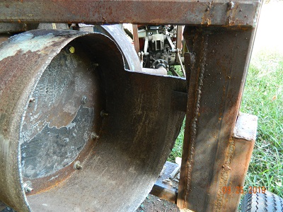

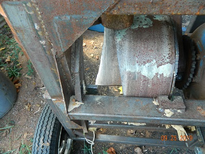

Thanks jacub, what size space your chopping the wood through, any video or photos of your finish blade and base chopping bars.? Are you getting same size wood as Wayne without cutting twice.?Thanks.
I modeled mine after Chris’.

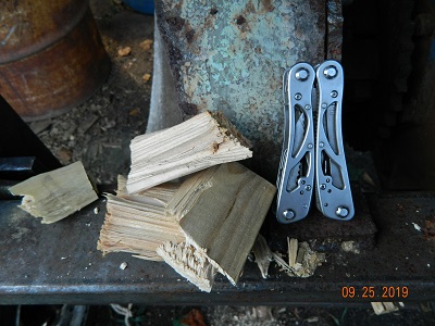

This wood was 2x4’s the knife is 3 inches long. I can cut whatever length wood I want up to 14 inches long. If you build one like this leave the cutting edge serrated a bit It helps cut the strings.
Ok thanks jacub, that looks like good size wood too drive with. i was thinking that you and bob were cutting the wood with the backer plate with out the pipe piece . Or is bobs cutter same as yours useing a backer plate and the notched pipe for the cutter? now that i see these design like yours, i might help if one could put a few bearing behind the backer plate. Inline ware the plate is push cutting the wood’ is enough space is there.? or designed for a bearing.Thanks again for the design pictures.
There would be room for a bearing. I don’t think you need it the bearings in the gearbox seem to be pretty stout, but only time will tell.

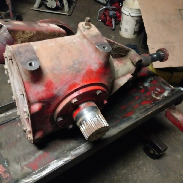

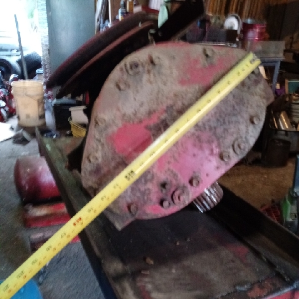

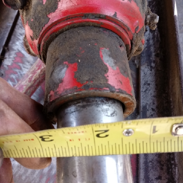

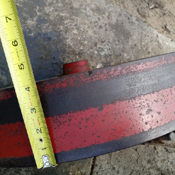

Thanks jacub is any body with bailer chunkers useing my size gear box, mine has a 22 by 4" thick pulley ware the pto goes, it seems bob has a 7.5" by 22" pulley. maybe same gear box not sure .

Ok thanks tom collins, mine is red so i think it was made in the 70’s . bobs has a 7 " thick pulley mine has only a 4 inch thick pulley problly pulley only difference, i can add a coulple thick plates too the pulley too give it the heavyer pulley.

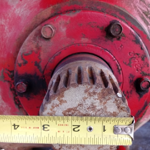

my gear box sizes. same 3" on the working arm shaft, i need too see what size shaft on bobs 7" thick pulley, my pulley shaft is only 1 5/8" od.? or any bodys pulley shaft that has the 7" thick drive pulley.Thanks.
Kevin, that gearbox is a heavy-duty, farm duty rated chunk of steel. If baling hay for many years did not hurt it, a 3 HP or even 15 HP on a belt drive is not going to hurt it. I say put fresh lube in it and chunk away!!
