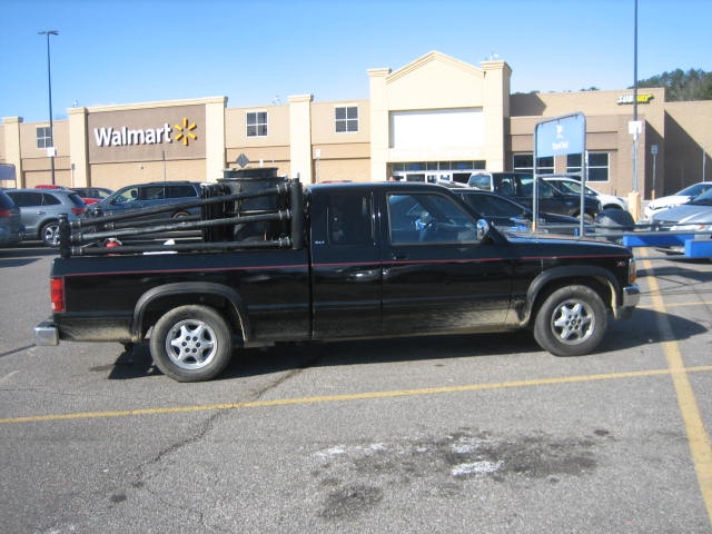

I hardly ever get any attention with the truck .Below is a pick taken just an hour ago at Walmart. Grown men walking within a couple of feet of the truck and not even notice .
IMG_0203
